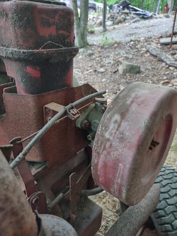

Wellingtontx 69 #1 Posted May 22, 2021 OK got the carb rebuilt on the C-160 but I am a little puzzled by the carb linkage and governor. Have a Tecumseh HH160 and Walbro carb. Does anyone have any pics or diagrams on the way the linkage was originally designed. Again, I am starting with things in boxes for the most part so I have no starting reference point. I looked in the Tecumseh engine manual and did not see what I am looking for, may have missed it but 3-5 pics would help a ton. Thanks folks Share this post Link to post Share on other sites

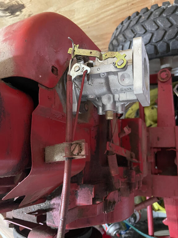

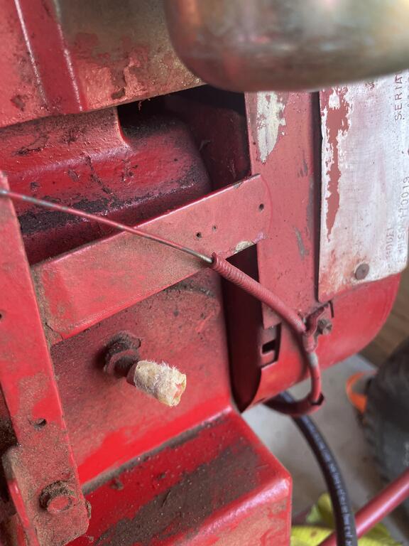

Wellingtontx 69 #5 Posted May 22, 2021 This is what I have. The problem is that when i move the throttle cable it moves nothing on carb. Does not move the throttle arm - or what I think is throttle. Does the engine need to be running to move throttle on top of Carb ? Share this post Link to post Share on other sites
Handy Don 16,751 #6 Posted May 22, 2021 (edited) 31 minutes ago, Wellingtontx said: This is what I have. The problem is that when i move the throttle cable it moves nothing on carb. Does not move the throttle arm - or what I think is throttle. Does the engine need to be running to move throttle on top of Carb ? For some engines, the governor pulls the throttle plate to full throttle when the engine is stopped and moving the throttle lever does not cause movement at the throttle plate. That said, for other engines, there is movement and the lever can move the plate to its idle position. I don't know which of these apply to your engine but someone here will. To those who are already deeply familiar with carb-governor interaction, the following paragraphs should be ignored! The throttle cable is actually only influencing the governor by applying pressure through the tension of a spring ("raising" the throttle lever pulls on the spring which pulls on the governor which opens the throttle plate. Then, as the engine speeds up, the governor pulls the other way, against the spring, to offset some of the pressure from the throttle cable allowing the engine to stabilize at the new speed--its a Ying and Yang thing). It's the linkage from the governor which moves the throttle plate on the carb (via the linkages you see in the picture). The point of the governor is to manage the carb throttle plate to keep the engine near a desired speed (which you set using the confusingly named "throttle lever") based on the actual speed of the engine. Turning too fast? Back off the throttle. Getting bogged down? Open the throttle. Edited May 22, 2021 by Handy Don 1 Share this post Link to post Share on other sites

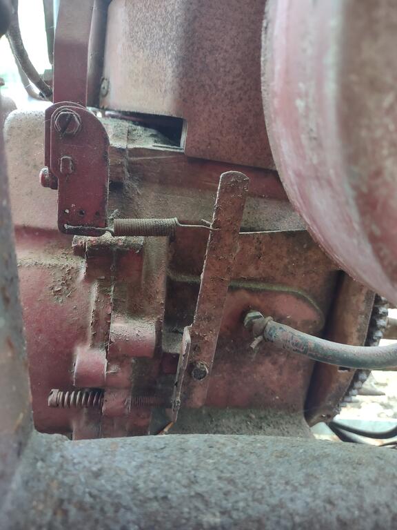

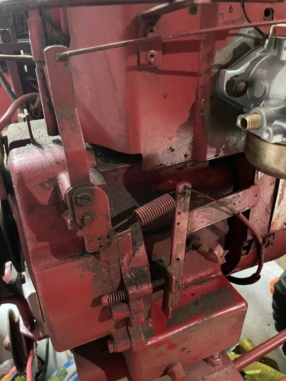

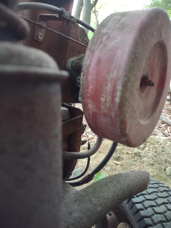

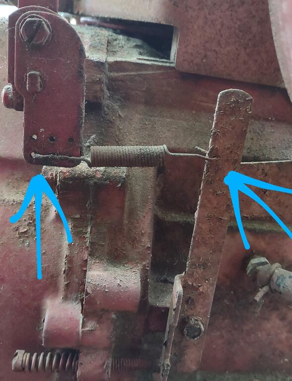

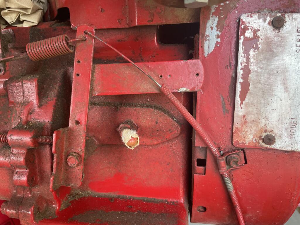

ebinmaine 79,116 #7 Posted May 23, 2021 On 5/21/2021 at 11:08 PM, Wellingtontx said: Ok Duke here's what I have. Keep in mind I've not had this one running but the linkage appears to be in good original working order. The angles are a little different because I have the muffler and air cleaner to go around. I quoted your pics to this reply so they're in the same window. ******* THE THINGS I NOTICE: 1. Your governor to carb linkage rod is in the opposite hole on the carb end. This would EXACTLY REVERSE the action of the governor. 2. The throttle spring on the governor arm is in a different location. This would affect rate and time of the throttle opening and closing. 1 Share this post Link to post Share on other sites
Wellingtontx 69 #8 Posted May 24, 2021 Thanks Eric - this is all so extremely helpful. I was taking a shot in the dark on the set up - and as I had feared guessed wrong. That is what makes this forum so great, can rely on others for reliable information. 1 Share this post Link to post Share on other sites

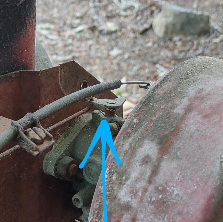

Wellingtontx 69 #10 Posted May 29, 2021 Alright - slow and steady but I think we have a prior owner modification that I didn’t realize until comparing Eric’s pics above. Is it possible that the PO tried to work around the governor issue ? Looks like the PO tried to plug the fuel line or am I looking at something else and showing my stupidity? 1 Share this post Link to post Share on other sites

Wellingtontx 69 #14 Posted May 29, 2021 Will definitely give it a try tomorrow afternoon. Tomorrow appears to be transmission rebuild day - unless something else requires my immediate attention. Any idea on the little inlet below carb ? Share this post Link to post Share on other sites
Handy Don 16,751 #15 Posted May 29, 2021 It's into the crankcase where pressure will fluctuate so I'm not thinking inlet at all. It's too high up to be an oil level check port, I think, though I do wonder what's on the inside behind it. Maybe a tap for a pulse fuel pump? Share this post Link to post Share on other sites
ebinmaine 79,116 #16 Posted May 29, 2021 1 hour ago, Wellingtontx said: Will definitely give it a try tomorrow afternoon. Tomorrow appears to be transmission rebuild day - unless something else requires my immediate attention. Any idea on the little inlet below carb ? Do you have the wheel hubs off? If not please do NOT use a standard 3 jaw puller. 5 minutes ago, Handy Don said: Maybe a tap for a pulse fuel pump? I believe this to be true although it isn't easily seen in my above pics. Share this post Link to post Share on other sites
