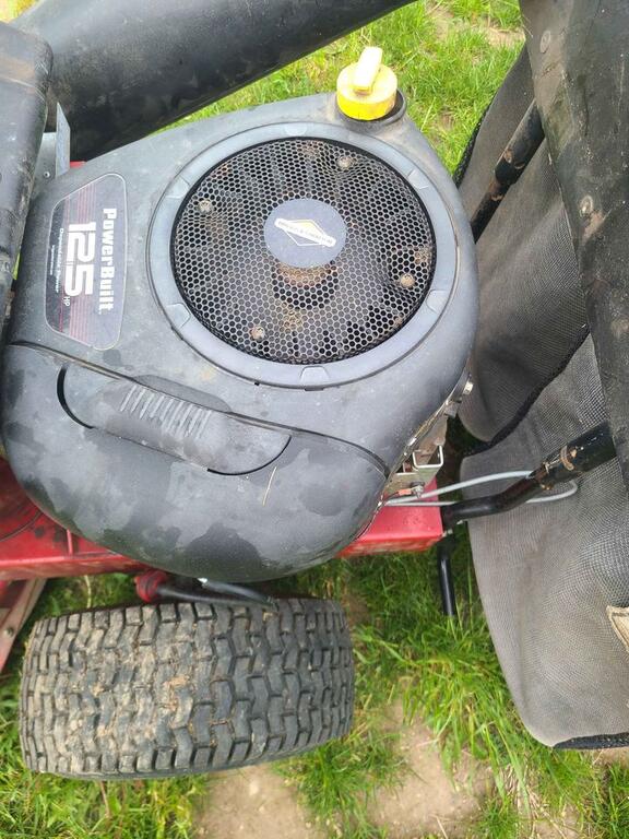

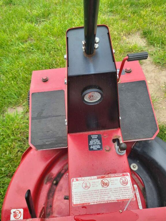

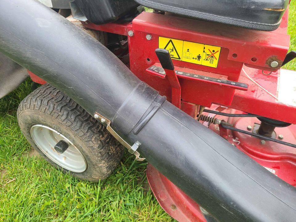

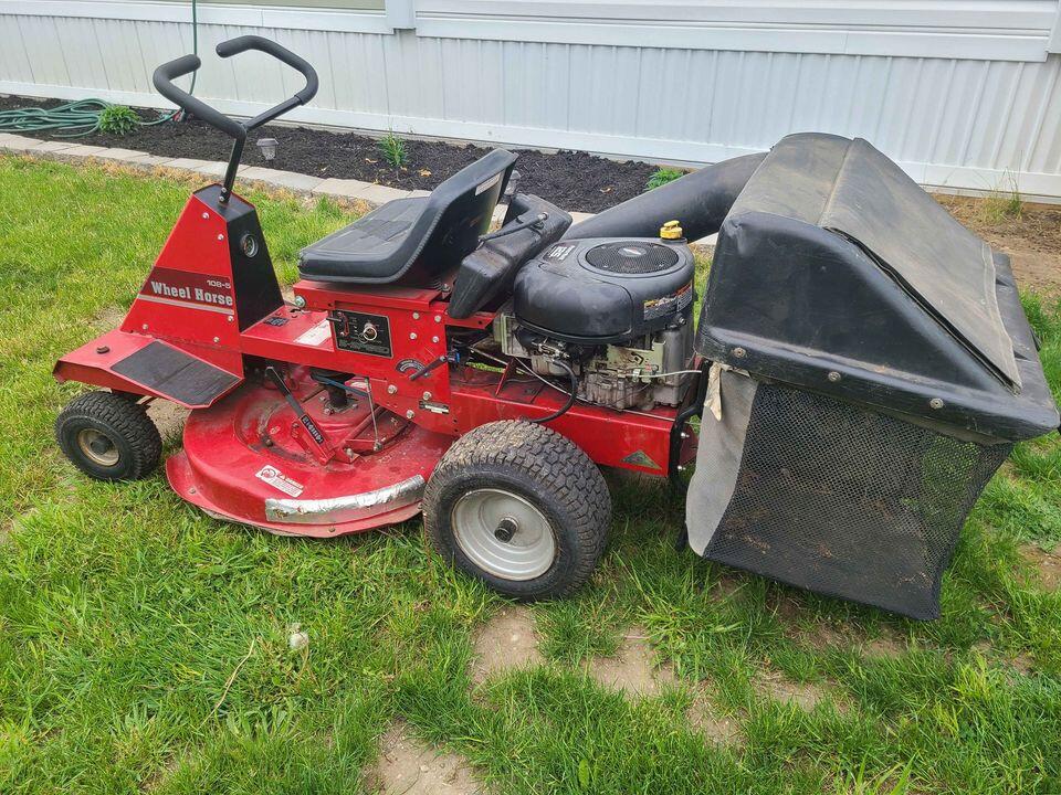

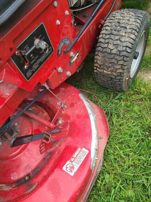

Bentoolong 94 #9 Posted May 21, 2021 (edited) Couple pics from the ad. I noticed that the key is in the run position and this one has the rare inverted gas tank feature so it can be driven upside down if needed. I'm hoping the gas tank has room to be in its normal spot with the newer B&S. Bagger and owners manual are a plus. Hey, does anyone know how the fuel tank is attached. Maybe a spring loaded Fram or something. Or bungee cords. Edited May 21, 2021 by Bentoolong 1 Share this post Link to post Share on other sites
