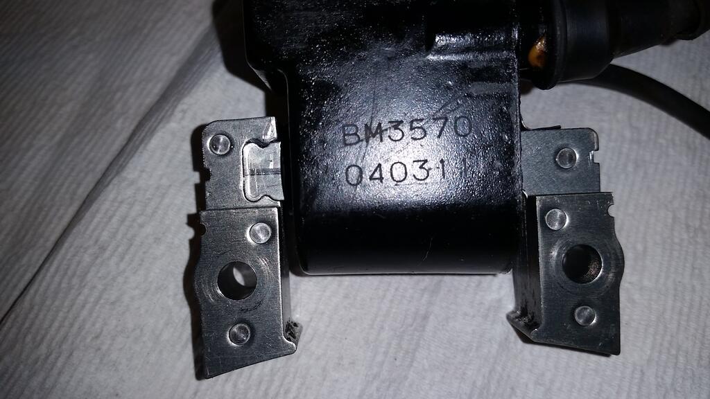

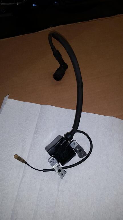

DavidB 2 #6 Posted June 2, 2021 (edited) So, got an old coil off either a Briggs or Tecumseh engine (My friend wasn't sure what machine it was off originally). I had to grind out the mounting holes to match the posts, but once that was done, I bolted it on and presto - a running engine. Now on to the next problem(s). Edited June 2, 2021 by DavidB Share this post Link to post Share on other sites

Barry59 0 #14 Posted May 17, 2022 On 6/1/2021 at 8:02 PM, DavidB said: So, got an old coil off either a Briggs or Tecumseh engine (My friend wasn't sure what machine it was off originally). I had to grind out the mounting holes to match the posts, but once that was done, I bolted it on and presto - a running engine. Now on to the next problem(s). I'm curious as to how you made that work. IIRC Onan doesn't have the for lack of better word, center pick up to fire the coil.. Guess I'm overthinking this Share this post Link to post Share on other sites
jrheim721@roadrunner.com 0 #15 Posted August 27, 2023 I also needed a 166 0832 and found one that works ! the part # is A058T422 it fits exactly the only diff is plug wire is longer but that doesnt matter for function Share this post Link to post Share on other sites
