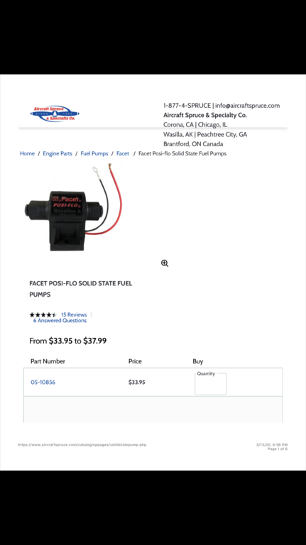

The Tuul Crib 7,354 #7 Posted May 24, 2021 Here is what l use. 1 1 Share this post Link to post Share on other sites
RJR49 179 #8 Posted May 24, 2021 I believe mine has a higher pressure output than the one shown by tuul crib. I'll have to check to see which one mine is but I think its a 0 - 10 PSI. I did read that 10 PSI is the Max joy want Share this post Link to post Share on other sites
peter lena 10,107 #9 Posted May 24, 2021 @ the tuul crib , got the exact model under a different name on the net , mounted up front near the original set up , super quiet with no issues at all , might do this to my other 2 horses, pete Share this post Link to post Share on other sites
