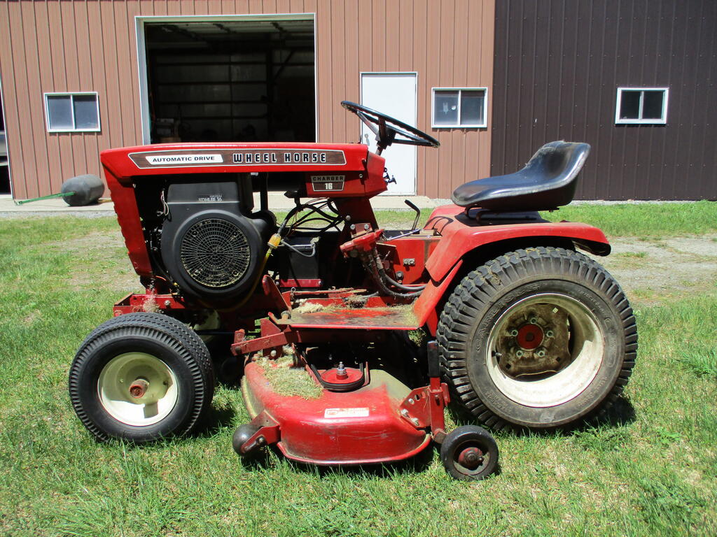

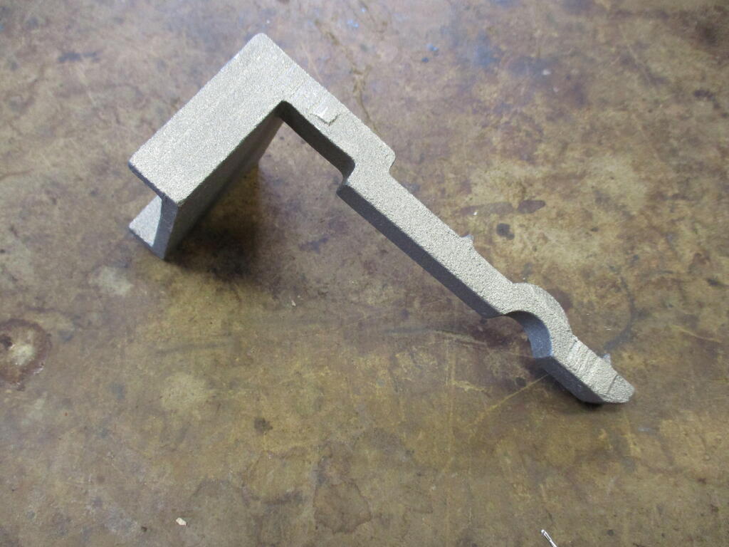

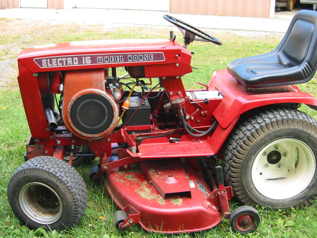

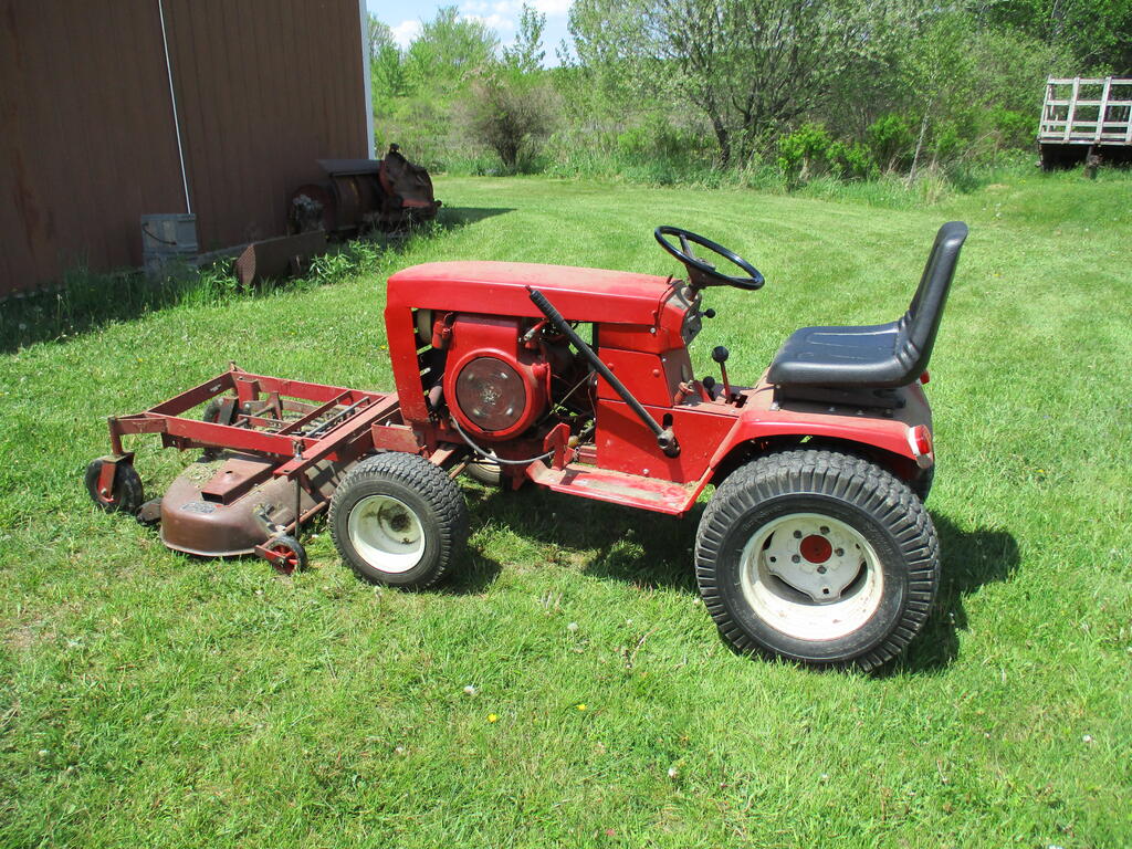

pfrederi 21,312 #1 Posted May 20, 2021 HNV is a big deal for car manufactures and there are engineers totally devoted to it. They have all sorts of equipment to measure it.. I only have my senses but there are differences in WH models. The last couple days were intensive mowing days. Used three different machines and there are, to my senses, some big differences. Worst was the recently overhauled K-341 on a Charger. Following the frequent remarks here I left out the balance gears. There is a very strong vibration and after an hour so of mowing you hands are getting tired. The vibration brings out lots of secondary sheet metal noises. (I never ran this engine before the overhaul so I can't compare before/after). Next test was a Magnum 16 mouthed on a Charger. Vibration was much less, still noticeable but hands didn't feel as tired after mowing for almost 3 hours.... I have never opened this engine and I doubt any previous owner did either so it has its balance gears. Last test was C-141 again I doubt the engine was ever molested so it still has balance gears and the shaker mounts. (Rubber is only in fair not great shape). She was much more pleasant that the other 2...Still am not a big fan of the isolation mounts but they do seem to work. Next big block overhaul the balance gears are going back in with new bearings. Yeah some failed but most last a long time, at 71 I don't need 40 more years out of them. i am convinced some of the reasons they are left out is the hassle timing them...i bought the tool so we shall see on the next project... 4 5 Share this post Link to post Share on other sites

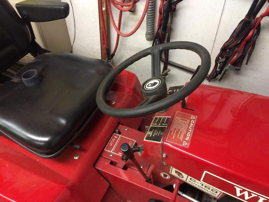

ebinmaine 81,156 #2 Posted May 20, 2021 2 minutes ago, pfrederi said: there are, to my senses, some big differences I'd say that's true with lots of machines. The last few years I've noticed my forearms, and hence my grip, can't take the vibration they once did. My own C160 does fairly well. It has the thicker type steering wheel. The Charger hydro is horrific. Because I have to keep adjusting the speed constantly I can never let go with either hand. Left steers. Right controls speed. After an hour or so it's very tiring. Another very noticable one for me is chainsaws. The old Sachs Dolmar I had was THE absolute BEAST. I could only run it for 20 minutes and my hands would begin to feel fatigued. 3 Share this post Link to post Share on other sites

squonk 48,339 #5 Posted May 20, 2021 I wonder if a "Comfort Grip" steering wheel would help? You have a pic of the timing tool Paul? Just curious what's involved. 2 Share this post Link to post Share on other sites
ebinmaine 81,156 #6 Posted May 20, 2021 5 minutes ago, squonk said: Comfort Grip" steering wheel Is that what's original to a '77 C160? Share this post Link to post Share on other sites
squonk 48,339 #7 Posted May 20, 2021 4 minutes ago, ebinmaine said: Is that what's original to a '77 C160? Don't know. My 76 had the hard plastic one like the ones Paul posted in his pics. 1 Share this post Link to post Share on other sites

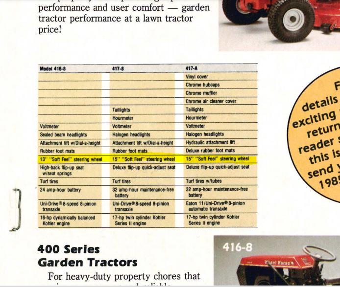

Maxwell-8 4,371 #9 Posted May 20, 2021 (edited) 32 minutes ago, squonk said: "Comfort Grip" steering wheel 400 an 500 series WH had softer steering wheels at one point Or whatever they mean by "Soft feel" Edited May 20, 2021 by Maxwell-8 3 Share this post Link to post Share on other sites

roadapples 6,987 #14 Posted May 20, 2021 1 hour ago, ebinmaine said: Is that what's original to a '77 C160? All 3 of my 74s have it... 1 Share this post Link to post Share on other sites

Lee1977 7,809 #24 Posted May 23, 2021 On 5/20/2021 at 3:30 PM, ebinmaine said: Is that what's original to a '77 C160? My 1977 C-120 had the rubber steering wheel and the 312 has the same style wheel. 1 Share this post Link to post Share on other sites
