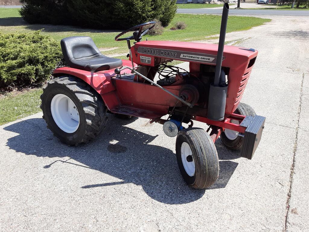

Roger R 473 #9 Posted May 21, 2021 Here's an alternative to loaded fronts 1 Share this post Link to post Share on other sites
TJ5208 1,841 #10 Posted May 21, 2021 I thought it would be a good idea Share this post Link to post Share on other sites
