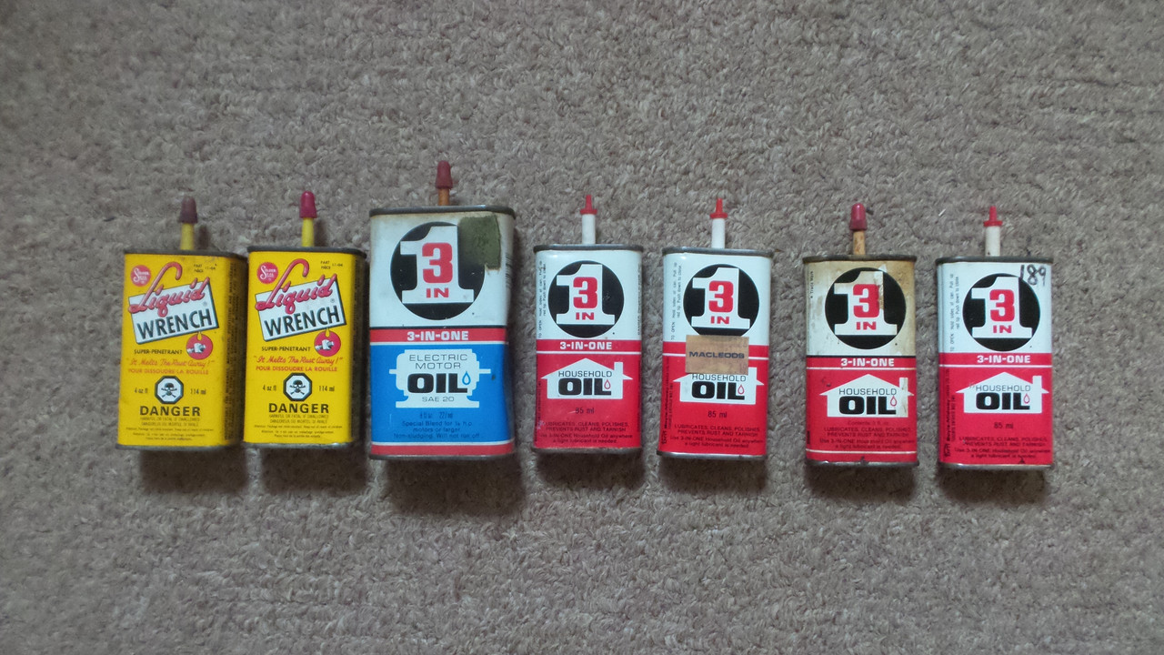

bc.gold 3,406 #17 Posted May 21, 2021 On 5/20/2021 at 9:10 AM, clueless said: If it's the original grommet that make it at least 44 years old, buy a new one with the valve, cheap fix, might make it another 40+years. Since the tank is empty remove it, simple, and rinse it out with a little soap and warm water, lay it upside down in the sun for awhile, with both holes open it won't take long to dry and the sun will help soften up the tank. Take the valve and put a little lubricant on it, preferably petroleum based, I use a little 3in1 oil, I use the s**t on everything #OLDSCHOOL, now push the valve half way into the grommet now put a small amount of the lubricant on the end of the grommet. Start the grommet in to the tank, once it's started push the valve in and it all slides in, easy peesy. Old Wheel horse mechanic show me this, works every time. Every abandoned farm house had at least one tin. 1 Share this post Link to post Share on other sites
Jeff-C175 7,207 #18 Posted May 21, 2021 44 minutes ago, bc.gold said: Every abandoned farm house had at least one tin. I must live in an abandoned farm house then! Maybe 3 or 4 ! I've even got a couple cans of Singer Sewing Machine Oil! 1 Share this post Link to post Share on other sites
