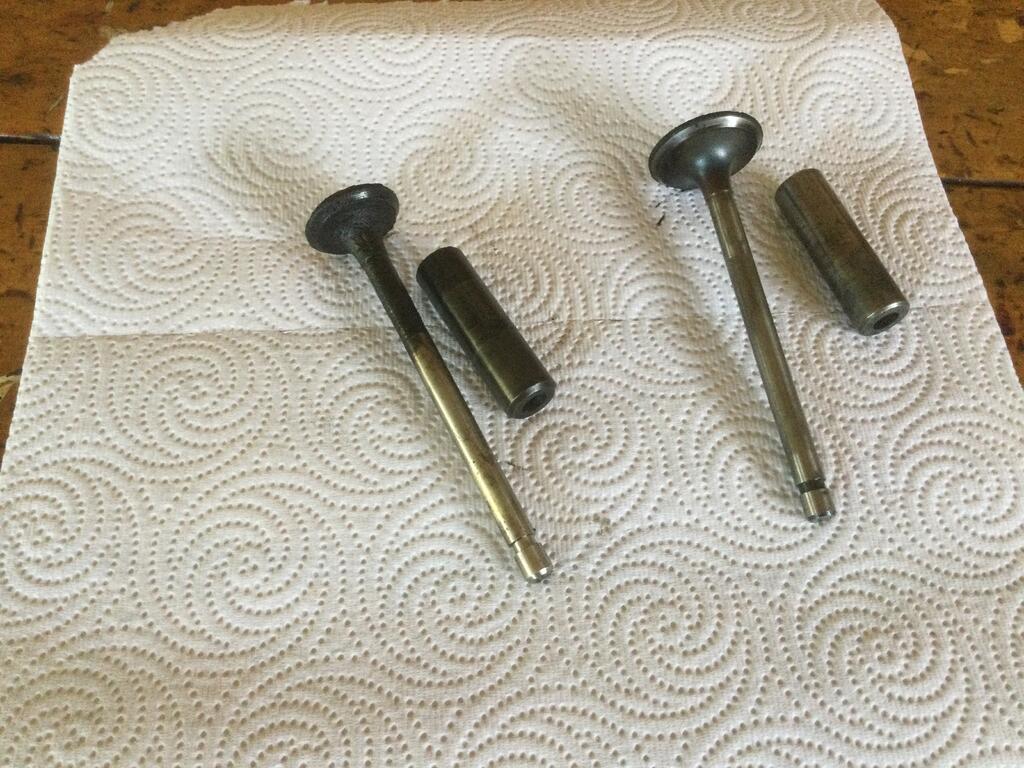

lynnmor 9,042 #8 Posted May 20, 2021 1 hour ago, ranger said: Definitely No compression, when it occurs the engine spins over as if there is no piston inside, This is on the starter. On releasing the key, it spins many times before coming to a standstill. After the “Click”, ( Valve closed, compression restored), and operating the starter, without trying to actually start the engine, the crank stops turning in a couple of turns after key is released. Doug. So you have a sticking valve. Remove it and check that it is straight and clean the valve guide bore. 1 Share this post Link to post Share on other sites

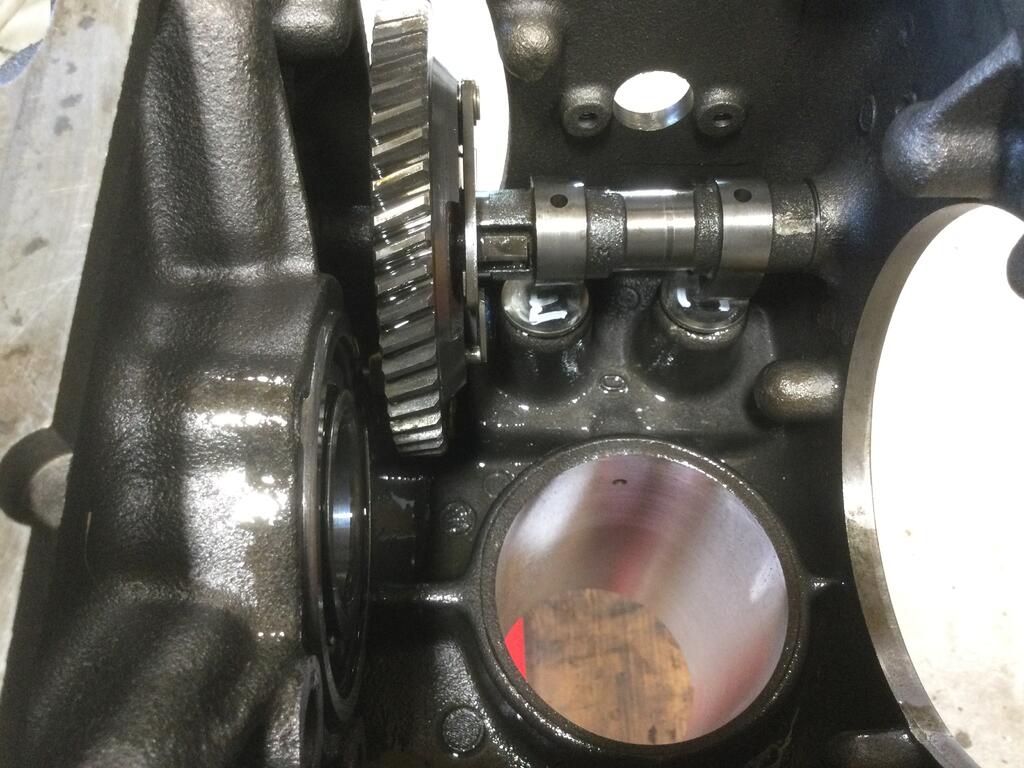

richmondred01 2,393 #10 Posted May 20, 2021 (edited) Reaming the guides you may find difficult depending on the ream you use. Many reams will need to pass through the guide and hit the tappet. If there’s a guide issue I always knock it out and replace it with a new one then ream while the tappet is out. However, some may consider this too much work because everything including the cam must be removed. If you go this route remember to mark your tappet as exhaust and intake. Edited May 20, 2021 by richmondred01 1 Share this post Link to post Share on other sites
