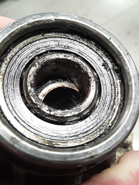

Sailman 1,307 #1 Posted May 19, 2021 I have the 36 inch side discharge mower deck and removed spindle for bearing replacement. This is the odd one with grease zerts and the shaft that comes up from the bottom. Removed the snap ring and CANNOT get the bearings out. I have heated the housing with a torch. Beat on the bearings from both directions and cannot get them out. About ready to cut them up with a dremel, if that's even possible. Don't want to damage the housing. Any suggestions???? Share this post Link to post Share on other sites

Sailman 1,307 #5 Posted May 20, 2021 (edited) I have attached some pictures. First picture is from bottom which had a snap ring I removed. Second is from the top. I assumed one would drift the bearings out from the top with snap ring removed. I have tried from both ends. Barely moves. Heated and beat the hell out of them! Starting to get crack in the housing now so that's not working...:( Edited May 20, 2021 by Sailman wrong picture Share this post Link to post Share on other sites
Crazyredhorse 296 #6 Posted May 20, 2021 there has to be a lip on back side of both bearings to hold them in place.so they each have to come out side there on.heat up around outside of spindle get it red hot to expand spindle use a pipe or good bolt to beat them out from inside.keep heating let it cool try again next day. 1 Share this post Link to post Share on other sites
Sailman 1,307 #7 Posted May 20, 2021 Problem is there is a spacer in between the 2 bearings. No way to get to the inside of the bearing with a bolt, pipe or punch. Share this post Link to post Share on other sites

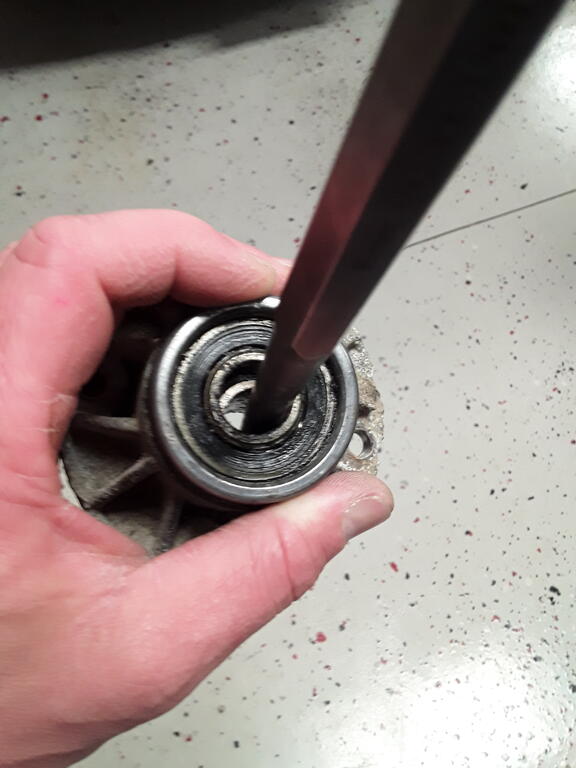

76c12091520h 4,290 #8 Posted May 20, 2021 (edited) You need to get in there and get that spacer off center, then you can use a punch to beat out the bearing from the inside . Edited May 20, 2021 by 76c12091520h 2 1 1 Share this post Link to post Share on other sites
Crazyredhorse 296 #9 Posted May 20, 2021 ahhh chisel the center out of one of the bearings see if u can pull spacer out maybe?but then you have to get the outer bearing out tho 1 Share this post Link to post Share on other sites
Sailman 1,307 #10 Posted May 20, 2021 That sounds like my best option. Will use my dremel to make a couple relief cuts and chisel to try to get the one bearing out. Then remove the spacer and should be able to get a good bite on driving the other one out....the correct way. I suspect I deformed the bearings by beating the wrong way..... Sometimes I just get it backwards....lol Share this post Link to post Share on other sites

Sailman 1,307 #12 Posted May 20, 2021 Amazing what PB Blaster and advice from this forum can help me accomplish! Used the angle technique with punch and both bearings came out with reasonable force. 2 more questions before I assemble. There is a part # 106070 called a "spacer seal" which goes above the top bearing and under the seal. It seems to have 2 notches. Didn't notice orientation when I removed the old one. Do the notches go up or down?? Also the top bearing is sealed on both sides. I saw where someone recommended removing the inner seal so grease can get to the bearing (I have the zerts on the shaft). Do you suggest I remove the inner seal or leave as is? Bottom bearing does have an open side. Thought I would ask here before I reassemble. Thanks for all advice!! Share this post Link to post Share on other sites

Dreamcatcher 102 #24 Posted May 27, 2023 On 5/19/2021 at 10:27 PM, 76c12091520h said: You need to get in there and get that spacer off center, then you can use a punch to beat out the bearing from the inside . I realize this is an old thread. I have a 48 inch SD deck that I am rebuilding. I believe i have the same spindles. This picture shows how to move teh spacer aside to drive out the 'top' bearing. Is teh bottom bearing driven out by removing the spacer and driving it out from the top? Thank you. Share this post Link to post Share on other sites
76c12091520h 4,290 #25 Posted May 27, 2023 1 hour ago, Dreamcatcher said: I realize this is an old thread. I have a 48 inch SD deck that I am rebuilding. I believe i have the same spindles. This picture shows how to move teh spacer aside to drive out the 'top' bearing. Is teh bottom bearing driven out by removing the spacer and driving it out from the top? Thank you. Yep 1 Share this post Link to post Share on other sites
