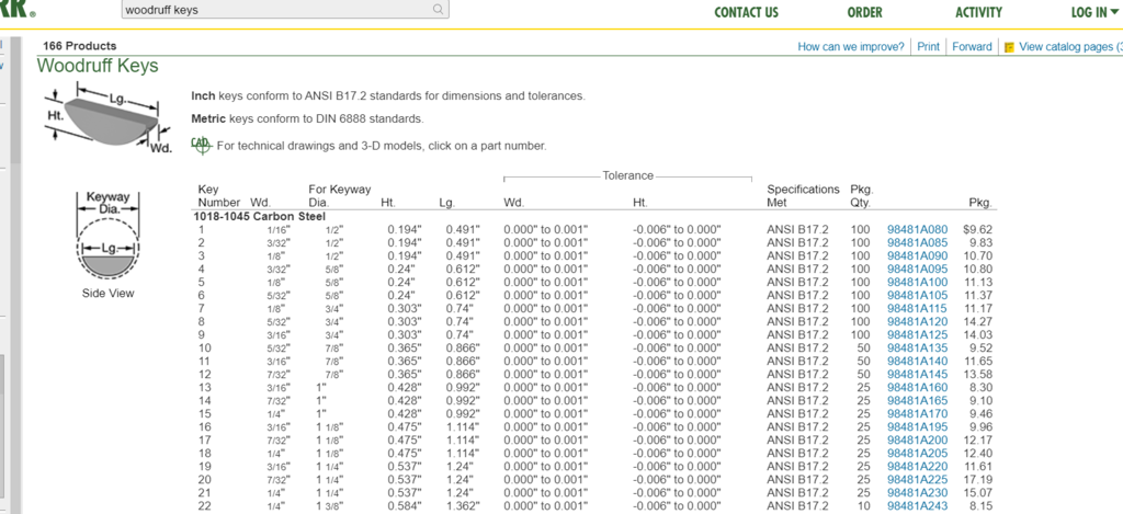

pfrederi 18,625 #7 Posted May 18, 2021 Wheel Horse used at least 3 different keys over the years. The two smaller ones are usually 1/4 but length varied 1" long are #15 others are 1-3/8" #22 Both at McMaster or hardware store. if you have a GT14 or D series they use a #RX key The are very very hard to find even McMaster doesn't have them...i do if you need one 2 Share this post Link to post Share on other sites
pfrederi 18,625 #8 Posted May 18, 2021 See Wodruff key size chart pinned top of this section 1 Share this post Link to post Share on other sites

squonk 43,688 #16 Posted May 18, 2021 Measure your keys. McMaster has the sizes listed right with the keys. Order a pack Install 2. Then put 2 at 4 different places in your shop. You're bound to run across them at some point! 4 Share this post Link to post Share on other sites
WHX?? 51,666 #17 Posted May 18, 2021 (edited) #15 woodruff ... any bigger hardware store should have them. MCC will have boatloads of them Edited May 18, 2021 by WHX24 Share this post Link to post Share on other sites
