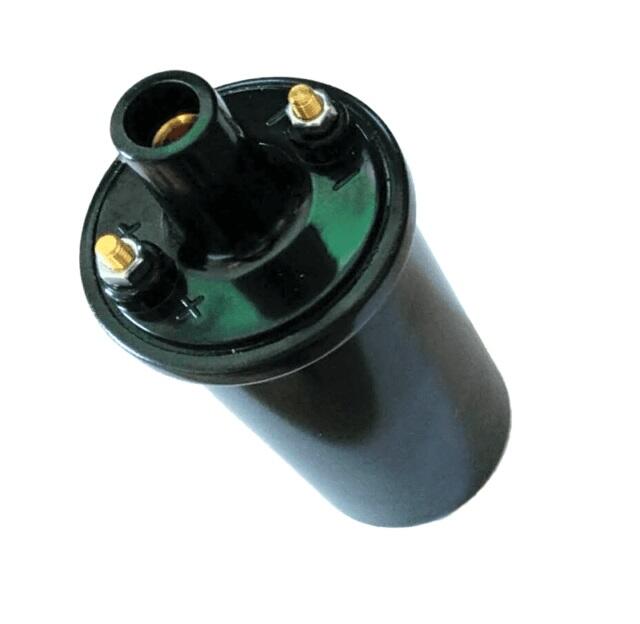

gwest_ca-(File Mod) 11,846 #6 Posted May 19, 2021 Very important to know what type of ignition this engine has. Wrong one can burn up the ignition coil. Does the ignition coil look like this one for battery ignition? Share this post Link to post Share on other sites
WHNerd 8 #7 Posted May 19, 2021 6 minutes ago, gwest_ca said: Very important to know what type of ignition this engine has. Wrong one can burn up the ignition coil. Does the ignition coil look like this one for battery ignition? Yes my engine has the same coil. Thanks. 6 minutes ago, gwest_ca said: Share this post Link to post Share on other sites

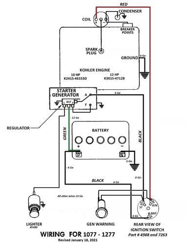

gwest_ca-(File Mod) 11,846 #9 Posted May 19, 2021 If you have a combination starter/generator the wiring should be something like this. No fuses but you could add a fuse to any of the light gauge wires coming off the ignition switch. Click on the picture in the link and again on the next page to view it. Garry Share this post Link to post Share on other sites
Gregor 4,847 #10 Posted May 19, 2021 If this is in fact your wiring diagram, and you have a starter/generator Your switch has 4 terminals. Battery Ignition Starter Accessories Accessories is not used.. I have the same wiring on my 876. The only place I have a fuse is in the line to the cigarette lighter. Share this post Link to post Share on other sites

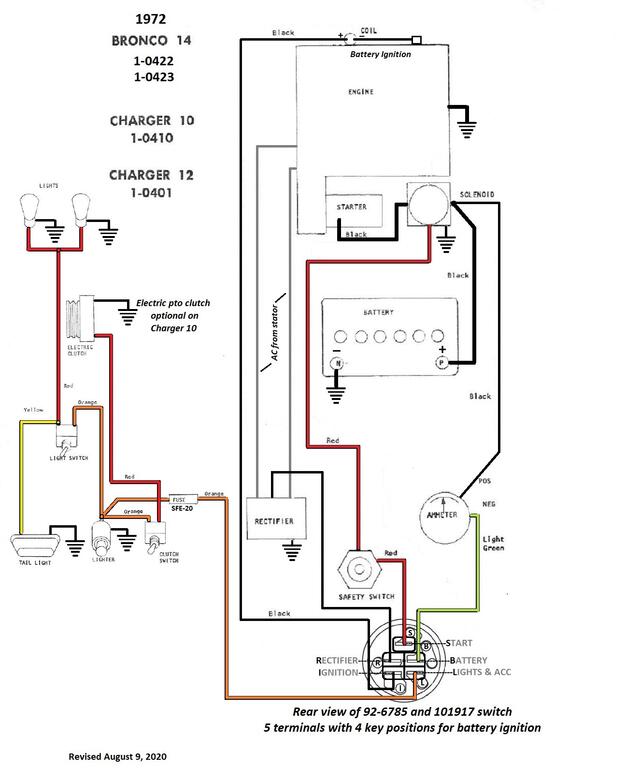

gwest_ca-(File Mod) 11,846 #11 Posted May 19, 2021 If the engine has a Bendix starter and flywheel alternator it would be wired like the Bronco 14. A fuse could be added to the wire going from battery source to ignition switch B terminal. A smaller fuse could be added to the other ignition switch wires going to coil and 12 volt accessories. Garry Share this post Link to post Share on other sites

gwest_ca-(File Mod) 11,846 #18 Posted May 22, 2021 You have the makings of a nice tractor. Kohler K321 Spec 60221d is a service replacement engine. Serial 6348098 was made in 1974. This engine has a 15 amp charging system and battery ignition. The diagram above for the 1972 Bronco 14 will work. You can add a 30 amp fuse at the solenoid to power the B terminal on the ignition switch. That would prevent a catastrophic electrical failure. You can eliminate the ammeter from the wire to the ignition switch. You will not have the neutral switch in the wire to the solenoid. Do you have a solenoid? Good idea because it saves overloading even an expensive heavy duty ignition switch. If the wiring terminals on the new ignition switch are identified differently than the diagram lets us know what you have. Garry 1 Share this post Link to post Share on other sites
