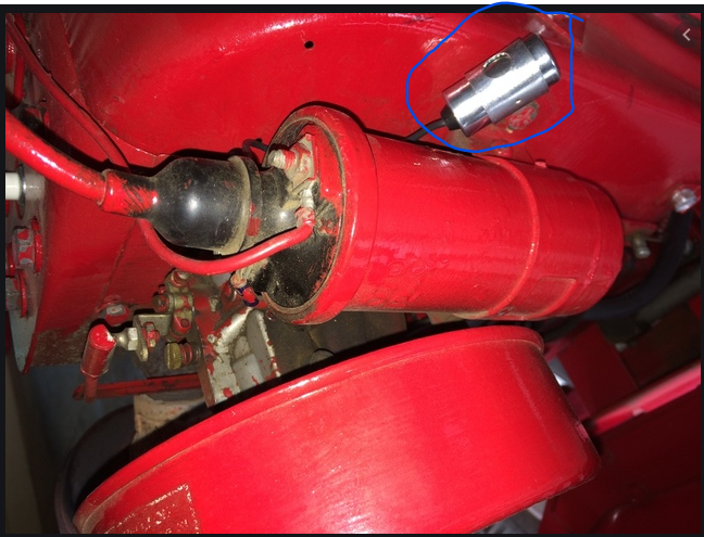

Maxwell-8 4,370 #46 Posted June 6, 2021 17 hours ago, Jonnyrocket132 said: I just noticed that the head lights don't work and I have even taken the switch off of my 417-8 just to see if it was the switch but it didn't work and I tried new bulbs but no light Is the condenser generating power? Share this post Link to post Share on other sites
Jonnyrocket132 38 #47 Posted June 6, 2021 just to clarify this? Share this post Link to post Share on other sites
Jonnyrocket132 38 #48 Posted June 6, 2021 to tell you the truth I didn't even think about testing that Share this post Link to post Share on other sites
Jonnyrocket132 38 #49 Posted June 7, 2021 (edited) so I just tested the condenser and it is no good Edited June 7, 2021 by Jonnyrocket132 Share this post Link to post Share on other sites
