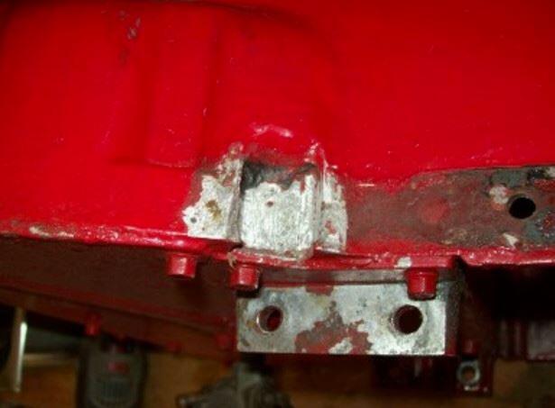

Walleye Guy 24 #1 Posted May 17, 2021 Hello, My dad and I are working on a 753 that my great grandpa bought new in 1963. It's been sitting for a while but seems to be complete. The gas tank has broken mounts on each side where the hood mounts. I've read a little bit about this problem but I'm wondering if someone out there can reply back and post a picture or two of what the tank is supposed to look like when it's not broken. A few questions I have: Is this a fairly common problem? Are there just two nuts welded in place or are they captured but float in a slot? Also, what have some of you done for repairs? Maybe there is a better way to fix this rather than reestablish the original design. I have access to a machine shop and excellent welders so there isn't much we can't accomplish. Thanks in advance! 1 Share this post Link to post Share on other sites

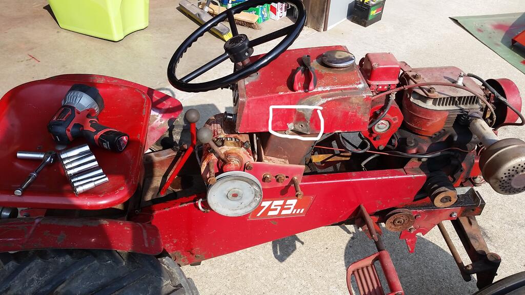

WHX?? 53,373 #2 Posted May 17, 2021 (edited) Walleye.... I'm thinkin if you have AL welders under your belt you may be able to just build it back up or weld broken pieces back on and machine to fit. If I am not mistaken they are just threaded holes into castings in the tank. Do you have the two or the one piece tank? I know @pullstart repaired a tank once?? Guessing this hole you mean? Edited May 17, 2021 by WHX24 1 Share this post Link to post Share on other sites

Pullstart 68,534 #4 Posted May 17, 2021 Neighbor! The aluminum is pretty trashy to weld, but it’s doable. You might be better off filling the area with PC-7 or a similar metal epoxy (Pigg Puddy in die shops) then drill and tap it. The issue is that quite often a longer than stock bolt is used to fasten a hood and the bolt bottoms out in the cavity and snaps the little strap off the tank. Share this post Link to post Share on other sites

Walleye Guy 24 #6 Posted May 17, 2021 WHX24, thank-you for the welcome and yes those are the holes and ours is a two-piece tank. That area is currently a void on our tank, like the bottom part broke and the rest fell out, but you can see a witness mark on the inside where the fastener (sounds like it was a thumbscrew?) bottomed against the tank. Yes, I could easily fab up a piece of aluminum flat stock with a tapped hole and have it welded into place (or simply have an aluminum nut welded into place). stevasauraus, that area on our tank is just a void so there is nothing to install the helicoil into. Is this a design that is prone to breaking again? ie should I look into a different solution? If it's a good design that just wore out over time, then we can simply get it fixed and probably won't ever have trouble with it again. 1 Share this post Link to post Share on other sites

Walleye Guy 24 #8 Posted May 17, 2021 Attached is a picture that I copied from this link. This is how our tank looks now on both sides...just an empty cavity...and I don't know what it looked like before it broke. Share this post Link to post Share on other sites
WHX?? 53,373 #9 Posted May 17, 2021 (edited) 18 minutes ago, pullstart said: The aluminum is pretty trashy to weld, Yeah I forgot the AL used in these is not the purest. Some pics Walleye? You might be better off searching for a one piecer. They are still out there. The two piece tanks were not the best invention and a step backwards from the one's in the 701/702s. edit: Ahh I see it now... yup someone bottomed out the fastener. I wouldn't be against doing the fix you suggested ... nothing to lose. As long as you don't have to open the tank up. Might be a can of worms there. keep a little gas in the tank to keep that gasket from drying out. Edited May 17, 2021 by WHX24 Share this post Link to post Share on other sites
Pullstart 68,534 #10 Posted May 17, 2021 I’d say unless you find another tank (one piece), your best bet is to fill it with PC-7 and tap it. Some people have mentioned before to use that type of epoxy and embed a 1/2-20 nut in the hole to use as a tapped hole... but I think a bottoming tap would work slick. These only need to be hand tight at the end of the day. 1 Share this post Link to post Share on other sites

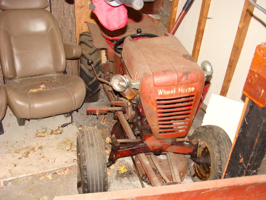

Walleye Guy 24 #20 Posted May 17, 2021 You guys are great and I really appreciate all the info. WHX24, I don't have any pictures of the tank just yet but I attached two pictures of the tractor itself. The tractor is at my parents house which is two hours away. My dad doesn't go online so I told him I'd find a good forum and post the question. Based on the number of responses so far, this is a fantastic group of guys. Does anyone have a picture of an original tank so I can see what this particular area is supposed to look like? I'm not familiar with a one-piece replacement tank. Is it a direct replacement with the same capacity? Was it available on a 753 or on some later models? Those aluminum low-temp repair kits sound interesting, but it's probably just as easy for me to have it welded. 2 Share this post Link to post Share on other sites

WHX?? 53,373 #22 Posted May 17, 2021 (edited) 43 minutes ago, stevasaurus said: Don't you guys have jobs??? I'm jockeying a desk... 36 minutes ago, Walleye Guy said: fantastic group of guys. It is & thank you sir we try... 2018 Group Photo; please identify yourself. - 2018 WHCC Show Pictures - RedSquare Wheel Horse Forum 61 & 62 models had a one piece tank that was great. They had a boss cast into the inside for the thumb screw so helicoil worked fine last a long time. Some early '63s had the one piece tanks as they were using them up. My 753 has a one piece tank. the tanks were all two piece in mid 63 & 64. They went to a whole different mouse trap in 65. The two piece ones were ok but the screws that hold the bottom on often "set" in to the tank since they weren't AL so removing them for a leaky gasket were often a pain. Especially for us clowns that resto them. Dissimilar metals and all that good stuff. Grampa's looks like a nice survivor. Edited May 17, 2021 by WHX24 1 Share this post Link to post Share on other sites
