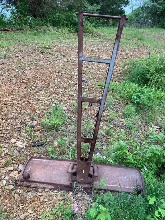

Jonnyrocket132 38 #28 Posted May 27, 2021 will this snow plow work for my wheel horse 417-8? Share this post Link to post Share on other sites
ebinmaine 72,075 #29 Posted May 27, 2021 1 hour ago, Jonnyrocket132 said: will this snow plow work for my wheel horse 417-8? Nope. That's a short frame plow. If you look at the frame rails they are in a perfect triangle. Long frame plows have a section at the back that is parallel to one another. Share this post Link to post Share on other sites

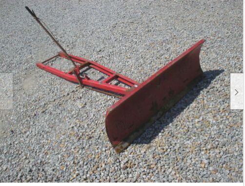

Jonnyrocket132 38 #30 Posted May 27, 2021 like this? 1 Share this post Link to post Share on other sites

OldWorkHorse 3,092 #32 Posted May 27, 2021 The red plow pic is a long frame plow. The rusty one is a short frame. 1 Share this post Link to post Share on other sites
