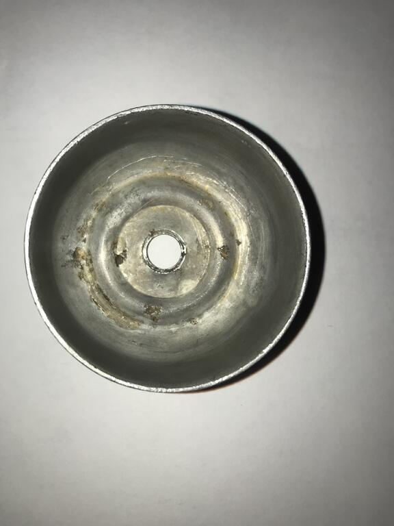

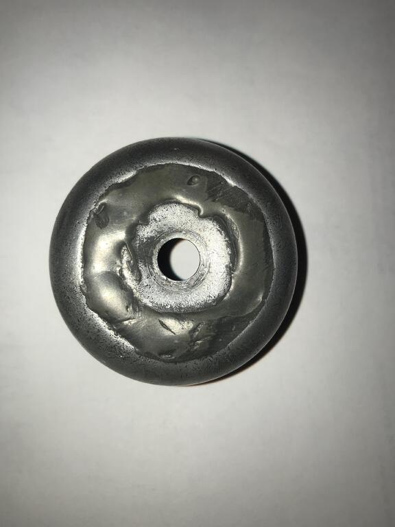

Jonnyrocket132 38 #1 Posted May 17, 2021 (edited) Hello again, I am trying to get this poor old wheel horse 417-8 back to running without having to have it on full choke and kind of restore it back to working condition. does anyone have any suggestions on the carburetor (I know that I can rebuild it). the previous owner left this poor old wheel horse out to the elements and from the cracks in the carb it must have gotten filled with water from rain and it must have frozen and expanded cracking it a little bit and the float bool is almost completely rusted out and the idle screw and the air to fuel mix screw is stuck. I already have a carb rebuild kit but I wanted to wait and see what you guys recommend I try and do with the original carb, should I try and repair it with LB weld or just replace it altogether? Edited May 17, 2021 by Jonnyrocket132 Share this post Link to post Share on other sites

oliver2-44 11,791 #8 Posted May 17, 2021 4 hours ago, Jonnyrocket132 said: carb it must have gotten filled with water from rain and it must have frozen and expanded cracking it a little bit the float bool is almost completely rusted out the idle screw and the air to fuel mix screw is stuck. I'll agree with EB and say pictures would sure help, and I would check with A-Z Tractor if he has a good used one, or at least a replacement float bowl, with that said you don't have anything to loose trying to revive your existing carb. 1st. priority, clean the cracks with something like brake cleaner, let it air out a few hours (the chemical in brake cleaner will soak in the metal pores and can act like a release agent for some epoxies) fill the cracks with JB Weld. 2nd. for it to work the adjustment screws need to get freed up. Throw it in a gallon paint can with lid full of diesel or kerosene and set it in the sun. Then every day try to GENTLY move the brass screws. if they move, wiggle them back and forth a little bit and put it back in the can to repeat. 3rd. while I would try to find a new float bowl for long term use. I have 2 carbs that have pitting holes repaired with JB weld in service for 2 & 4 years. One bowl is aluminum and one is steel. Here is pictures of a 3rd bowl i have repaired as a spare. The aluminum bowl had pitting tiny pitting all the way around the bottom. So it has a ring of JB weld all the way around the bottom. 1 Share this post Link to post Share on other sites
