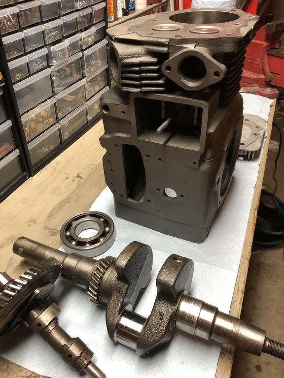

Handy Don 17,335 #31 Posted July 14, 2021 13 hours ago, WheelhorseBob said: Finally got the K341 back and boy is it pretty! Bored 20, valves ground and head trued. Hot tanked and bead lasted to boot. Who doesn’t love perfect, clean engine parts! Let the build begin. Wow, that is one pretty sight! 3 1 1 Share this post Link to post Share on other sites

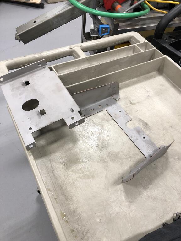

WheelhorseBob 1,550 #34 Posted July 20, 2021 Freshly sandblasted wheels. I love starting with clean parts. A little progress as I wait for my governor gear. 3 Share this post Link to post Share on other sites
WHX?? 57,821 #35 Posted July 20, 2021 3 minutes ago, WheelhorseBob said: I love starting with clean parts 2 Share this post Link to post Share on other sites

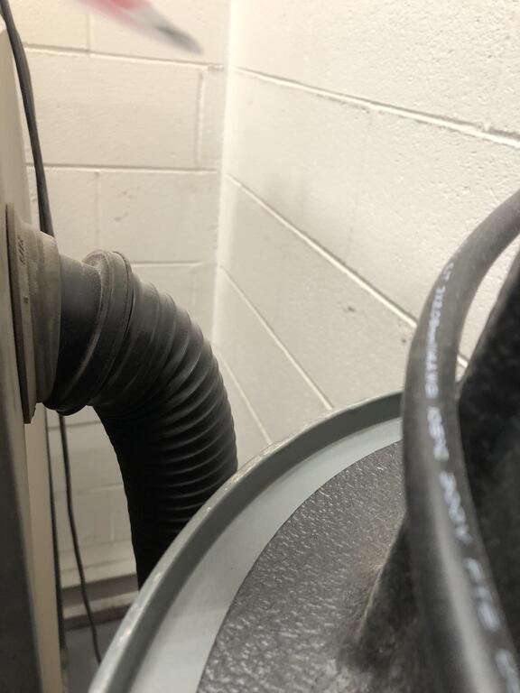

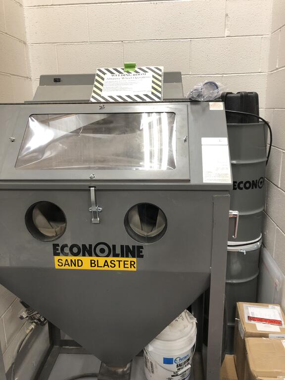

PWL216 1,277 #36 Posted July 20, 2021 On 5/19/2021 at 6:20 PM, WheelhorseBob said: I’ve been asked about sand blasting. This is the unit I have use of. Works great! That battery tray was bad! I just bought this exact same sandblasted at an auction for $75. I’ve never sandblasted and was wondering where the vacuum connects? In the back of my unit they installed a Skat Blast reclaimer. Is that where the vac should go? Thx! 1 Share this post Link to post Share on other sites
WheelhorseBob 1,550 #37 Posted July 20, 2021 38 minutes ago, PWL216 said: I just bought this exact same sandblasted at an auction for $75. I’ve never sandblasted and was wondering where the vacuum connects? In the back of my unit they installed a Skat Blast reclaimer. Is that where the vac should go? Thx! You know I’ve never actually looked but I will tomorrow. I have more to do. 2 Share this post Link to post Share on other sites
ebinmaine 80,388 #38 Posted July 21, 2021 3 hours ago, WheelhorseBob said: . I love starting with clean parts 3 hours ago, WHX24 said: Us too. It's really the only way to go. 1 Share this post Link to post Share on other sites
WheelhorseBob 1,550 #39 Posted July 22, 2021 On 7/20/2021 at 6:31 PM, PWL216 said: I just bought this exact same sandblasted at an auction for $75. I’ve never sandblasted and was wondering where the vacuum connects? In the back of my unit they installed a Skat Blast reclaimer. Is that where the vac should go? Thx! Top right in the back if looking at the cabinet from the front. 1 Share this post Link to post Share on other sites

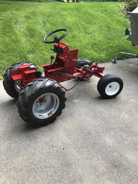

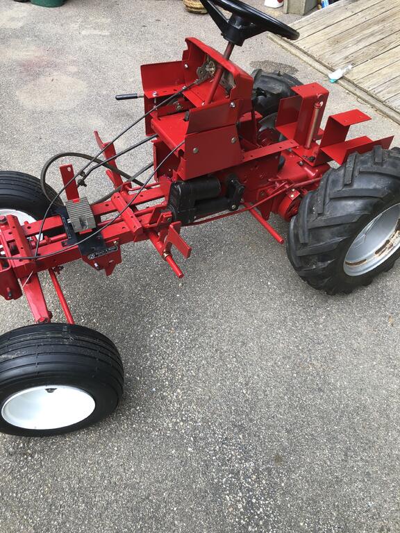

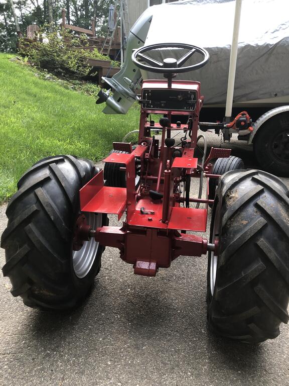

WheelhorseBob 1,550 #43 Posted August 1, 2021 Got a little more done with the nice weather this weekend. Painted front wheels and mounted new rib tires, got the steering set and got it rolling. These are the tears I’m going to use. They are loaded and came off my loader tractor. I need to paint them to match but because they’re loaded I’ll have to do it with the tires on. Tips or tricks appreciated. Now into the basement to put the piston and rod in a K341. 3 3 Share this post Link to post Share on other sites
ebinmaine 80,388 #44 Posted August 1, 2021 12 minutes ago, WheelhorseBob said: Tips or tricks appreciated If you can stuff a playing card betwixt the tire and rim they can be used as a mask when placed all the way around the rim. I've read that others have used a smear of ((Vaseline??)) On the tire to prevent the paint sticking. 1 Share this post Link to post Share on other sites

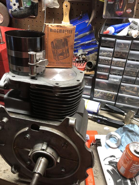

WheelhorseBob 1,550 #45 Posted August 1, 2021 1 hour ago, ebinmaine said: If you can stuff a playing card betwixt the tire and rim they can be used as a mask when placed all the way around the rim. I've read that others have used a smear of ((Vaseline??)) On the tire to prevent the paint sticking. If I could deflate them that would work but being fluid filled I don’t think the cards would fit. Vaseline sounds interesting 🤔. On another note piston installed and oil pan bolted up. My dad’s old ring compressor. Always cool to use dad’s tools, he’s been gone almost 50 years. 1 1 5 Share this post Link to post Share on other sites

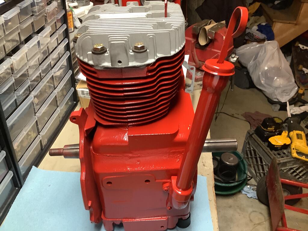

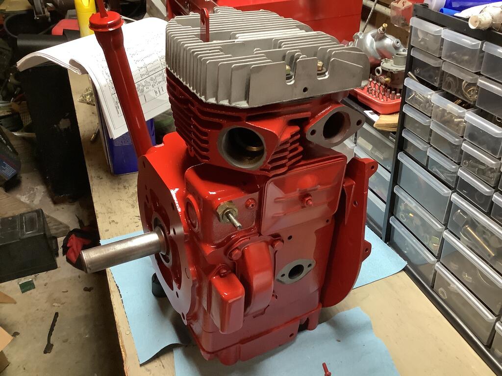

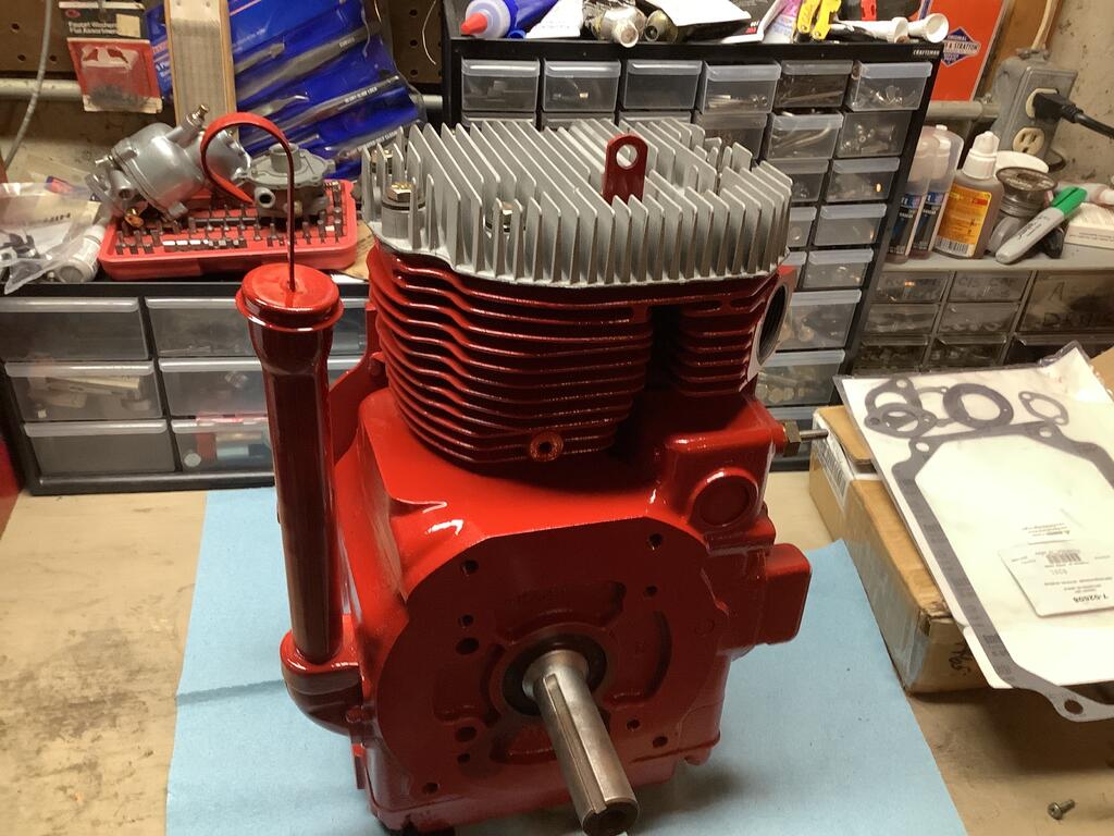

WheelhorseBob 1,550 #47 Posted August 18, 2021 Not a lot of progress lately but did get the K341 painted and head on. Went with duplicolor engine paint an really liked it. This red is almost exactly IH red so it will be perfect. I bought this engine totally apart and in boxes. It’s been frustrating to try and find all the little bits, for instance I was short 3 head bolt washers😡. Had to get some off flea bay..... 2 8 Share this post Link to post Share on other sites
Handy Don 17,335 #48 Posted August 18, 2021 Very handsome look 4 Share this post Link to post Share on other sites
ebinmaine 80,388 #49 Posted August 18, 2021 29 minutes ago, Handy Don said: Very handsome look Agreed. Looks great Bob 2 Share this post Link to post Share on other sites
