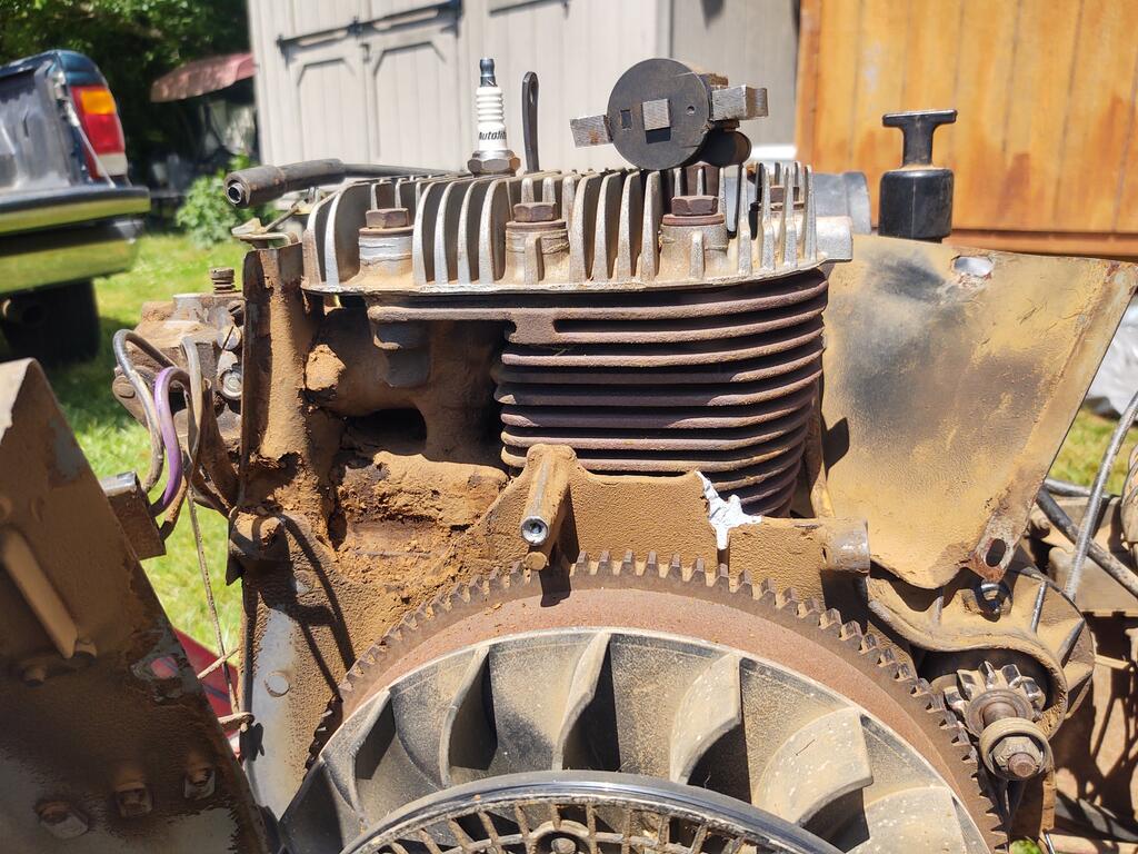

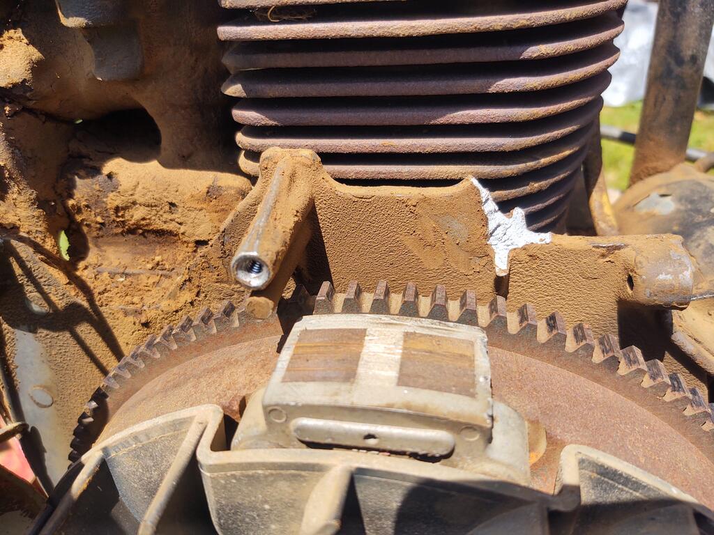

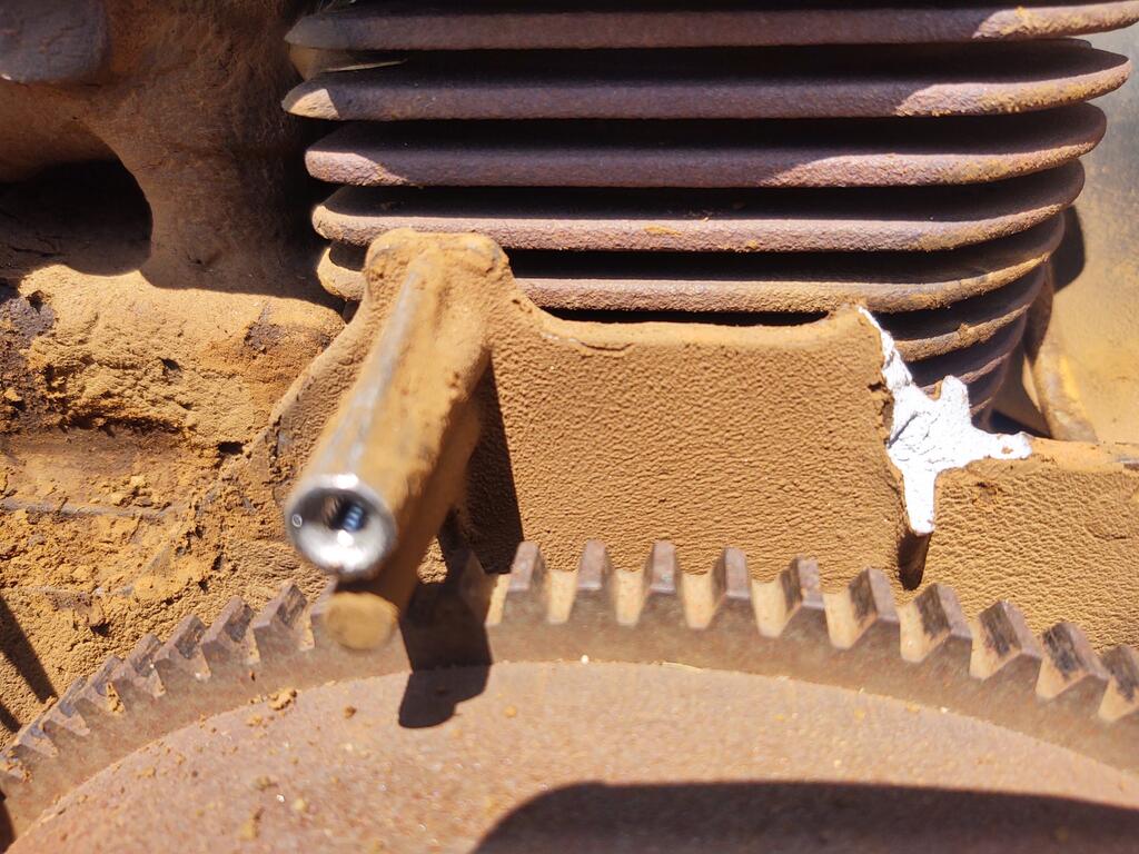

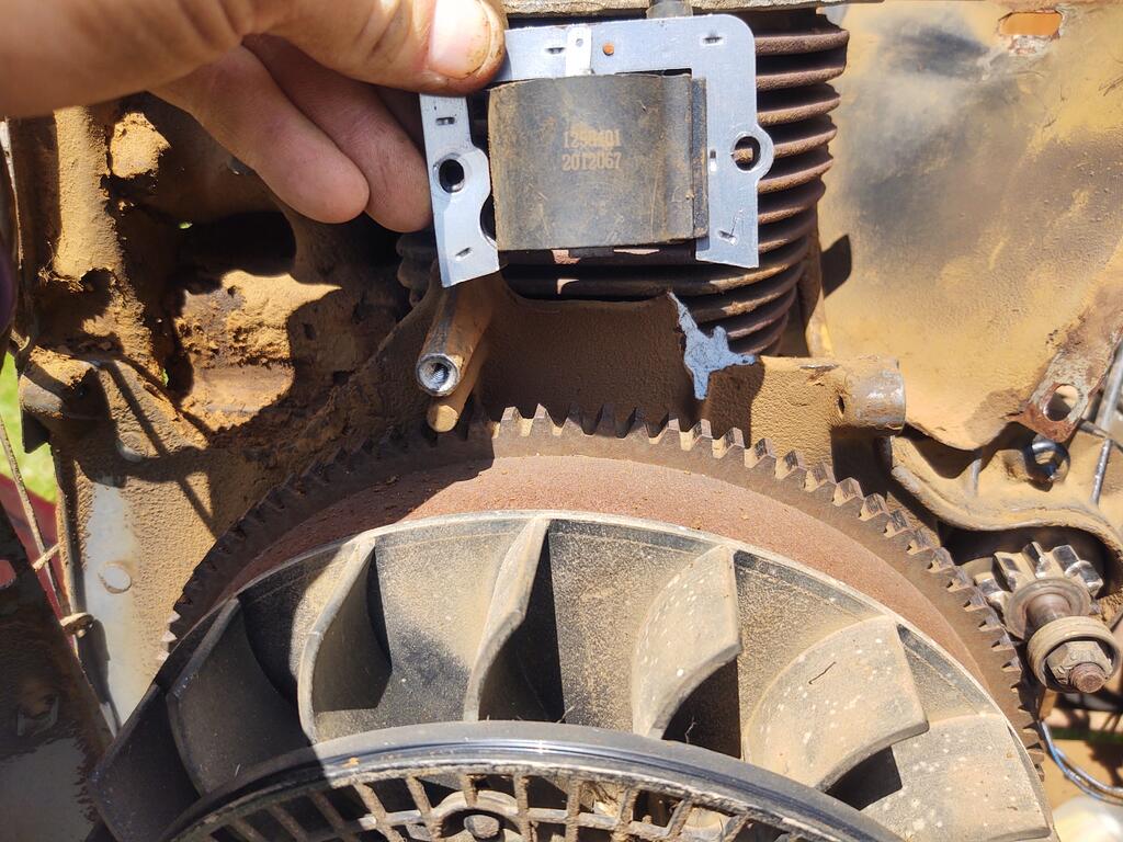

TC10284 114 #1 Posted May 15, 2021 (edited) I picked up another 312-8 today for $40. Mostly great condition tractor. Came with new battery and 42" deck (needs major patching at height adjustment lever). The main issue is that the previous owner I think, tried to put on a new ignition coil and did not properly adjust it. Ended up breaking one of the ignition coil standoffs off. Is there a way this can be fixed? I do NOT have the original standoff. I am trying to find out if he happens to have it. I am assuming not. Edited May 15, 2021 by TC10284 Share this post Link to post Share on other sites
clueless 3,427 #2 Posted May 15, 2021 Your best bet is to find another backing plate. Share this post Link to post Share on other sites
TC10284 114 #3 Posted May 15, 2021 51 minutes ago, clueless said: Your best bet is to find another backing plate. Thanks! Do you know if those are fairly available or any part numbers? Share this post Link to post Share on other sites
JoeM 10,100 #4 Posted May 15, 2021 (edited) Looks like a 12HP Magnum backing plate #47 146 11-S Not available new might try A-Z or one of the parts vendors, classified section, or evil bay. Looks like M16 is the same plate https://www.partstree.com/models/m12-471546-kohler-magnum-engine-made-for-wheel-horse-12hp-9kw/crankcase-03050033394-10/ https://www.partstree.com/models/m16-711523-kohler-magnum-engine-made-for-wheel-horse-16hp-11-9kw/crankcase-0309003791-14/ Edited May 15, 2021 by JoeM 1 Share this post Link to post Share on other sites
