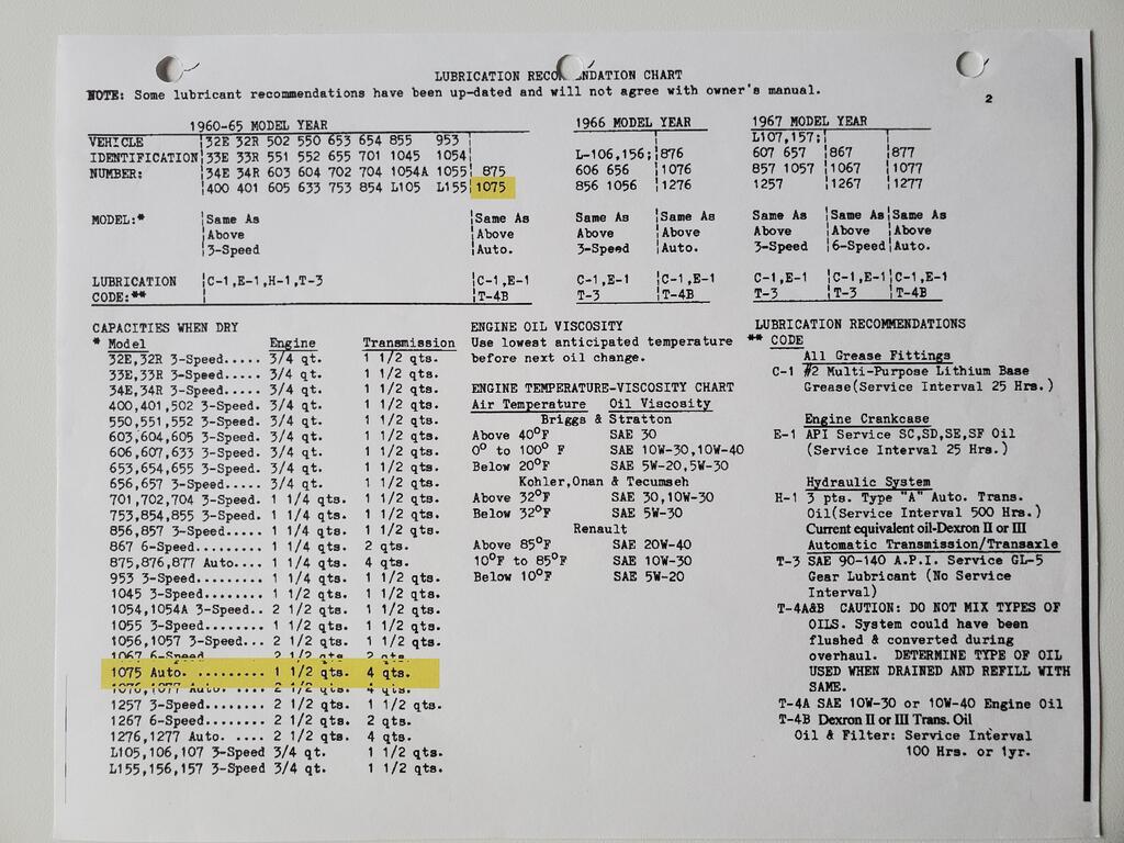

gwest_ca-(File Mod) 12,535 #5 Posted May 15, 2021 Welcome to the forum. Click on the picture in this link. Lots of info including 2 pages from the Lubrication guide. When it was printed the recommendations in it may have been changed to what was in the original manuals. Garry Share this post Link to post Share on other sites
Racinbob 13,286 #6 Posted May 15, 2021 I agree with the 30wt in the engine bit the K161only takes 1 1/4 quarts (40 oz). I would start with that and then go by the dipstick. 3 and 4 speed transmissions call for 1 1/2 quarts but you won't hurt it with 2. In my K-series Kohlers I use 30w year round . I use 80w90 in the transmission. In 1964 Wheel Horse issues a service bulletin recommending switching to 40w in the transmission. This was to help prevent the slide rails from messing up causing it to lock up in two gear. Shortly after that they revised the rails to achieve a proper fix. 3 Share this post Link to post Share on other sites

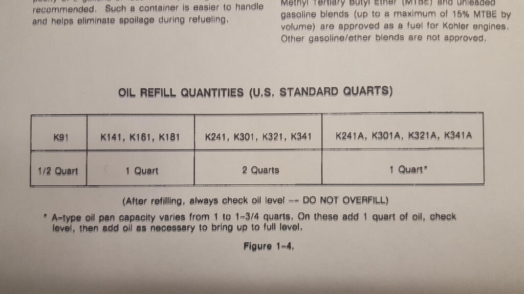

Gregor 4,848 #10 Posted May 15, 2021 (edited) And the Kohler manual says 1 qt. ??????? Of course we are all assuming it has a stock K161S in it. Edited May 15, 2021 by Gregor Share this post Link to post Share on other sites

Racinbob 13,286 #12 Posted May 15, 2021 Treat it like they say to do with the A type oil pan. Put a quart in and check the dipstick. I'm betting that you will need to add another cup. Follow what they say on the previous page depending on the type of dipstick you have. Share this post Link to post Share on other sites
