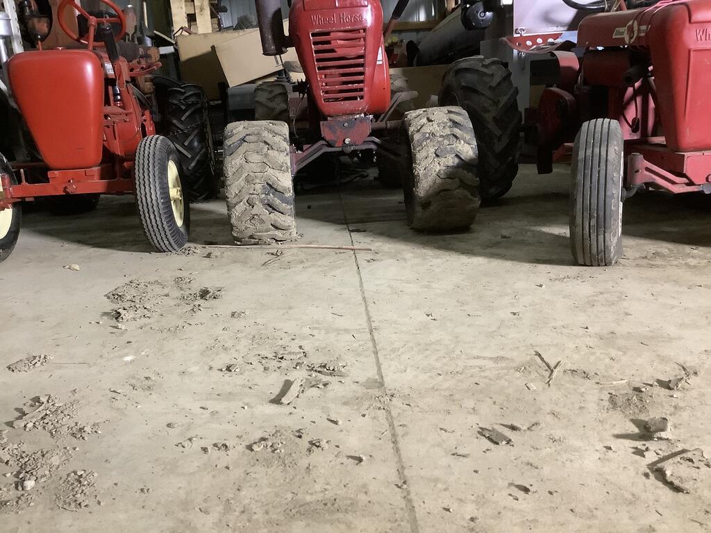

Jw 704 16 #1 Posted May 14, 2021 Just picked up my first horse. A 704 apears to have been well kept or restored has belly mower and snow blower with it gas tank is dry motor is free drained what seemed like a oil/mixture out of it today reoiled hopefully try to start it in next few days any pointers ... 9 3 1 Share this post Link to post Share on other sites
Pullstart 71,522 #2 Posted May 14, 2021 It looks like someone has already done one of the hardest things... remove the steering wheel. Did it come with the sale? It might be a good idea to pop the points cover off and give ‘em a good ‘ole polishing. A dollar bill works great for that... don’t use sand paper whatever you do! Round hoods rock! 1 Share this post Link to post Share on other sites
Maxwell-8 4,371 #3 Posted May 14, 2021 3 hours ago, pullstart said: don’t use sand paper whatever you do! oops! 4 hours ago, Jw 704 said: next few days any pointers ... Horses I seem to always get have trans bearing failure, which you see, if the axle is not centered in the tranny, but you guys over in the US never seem to have a problem. Great score, you're in for a lot of fun and normally very few issues. Share this post Link to post Share on other sites
