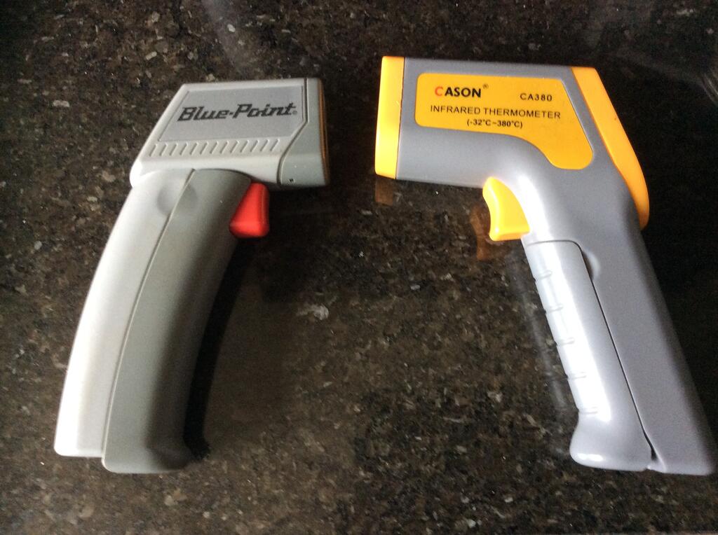

ranger 1,851 #7 Posted May 14, 2021 49 minutes ago, Gregor said: That's the part I don't know. He says gauge operates normally with cap loose, but I am not there to actually see it, and know whats going on. When it does overheat, it is not forcing coolant into the reservoir. Maybe a faulty sender, pressure forcing coolant into sender causing resistance values to change? Thats where these “Puppies” come in useful, don’t need to be super accurate with measurements, comparison at different stages will tell you more. Blue-point one I’ve had for 30+ years, expensive! Cheap eBay one shows almost identical measurements. Doug. p.s. Another tool you didn’t know you needed, but can’t do without once you’ve got one. (Also works for checking for Covid high temperature, but do turn the laser off first!). Doug. Share this post Link to post Share on other sites
Gregor 4,847 #8 Posted May 14, 2021 18 minutes ago, ranger said: Another tool you didn’t know you needed You're right. I think I do need one of those. Just ordered one. 1 Share this post Link to post Share on other sites

ranger 1,851 #12 Posted May 14, 2021 (edited) 21 minutes ago, gwest_ca said: A rad cap raises the boiling point of the coolant approximately 3F degrees for every pound of pressure. Will be interesting to hear what makes him think it is too hot if it is not pushing coolant into reservoir. Garry Exactly. That’s where the non contact thermometer comes in, a quick and, (relatively), easy way to check the engine / radiator temps in various areas with cap on, and cap off should help identify where / if there is a problem. Perhaps thermostat failing under pressure and closing? Radiator hose delaminating under pressure? You would expect to see coolant loss though. Edited May 14, 2021 by ranger Share this post Link to post Share on other sites
