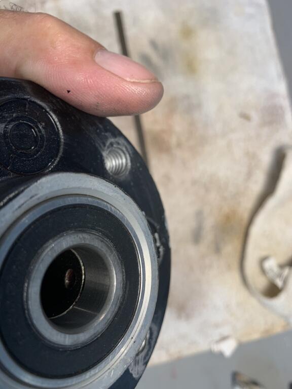

Nope all 3 not the same… right and left seem to be taking grease fine.
Took the zerk off of the center spindle and flushed it with brake cleaner, pushed on the ball, ball not stuck.
I wonder if it’s the spacer is not installed the correct way ?
Horse Newbie
8 minutes ago, Blasterdad said:
The tolerance in those new spindles will be very tight, grease will be hard to pump in there, run that beauty a couple of times then give it a little shot of grease, you should be good. :)
You think I should take the center spindle apart and try to determine if the spacer/ sleeve is in correct ?

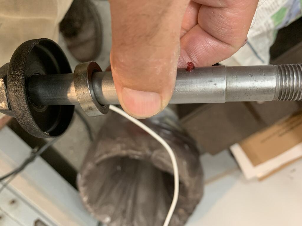

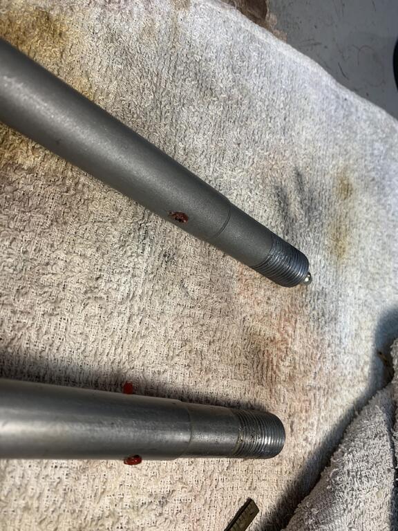

Do you guys, @Jeff-C175, and @Blasterdad know if the spindle shafts are supposed to have 2 cross- holes for the grease to come out ?
The center spindle shaft only has one hole and the left spindle shaft has 2 holes…
And also , do you guys know if the spindle shafts are designed for maybe the center having 2, and the right and left having 1, with the spindle shafts having to be in a certain location by design ?

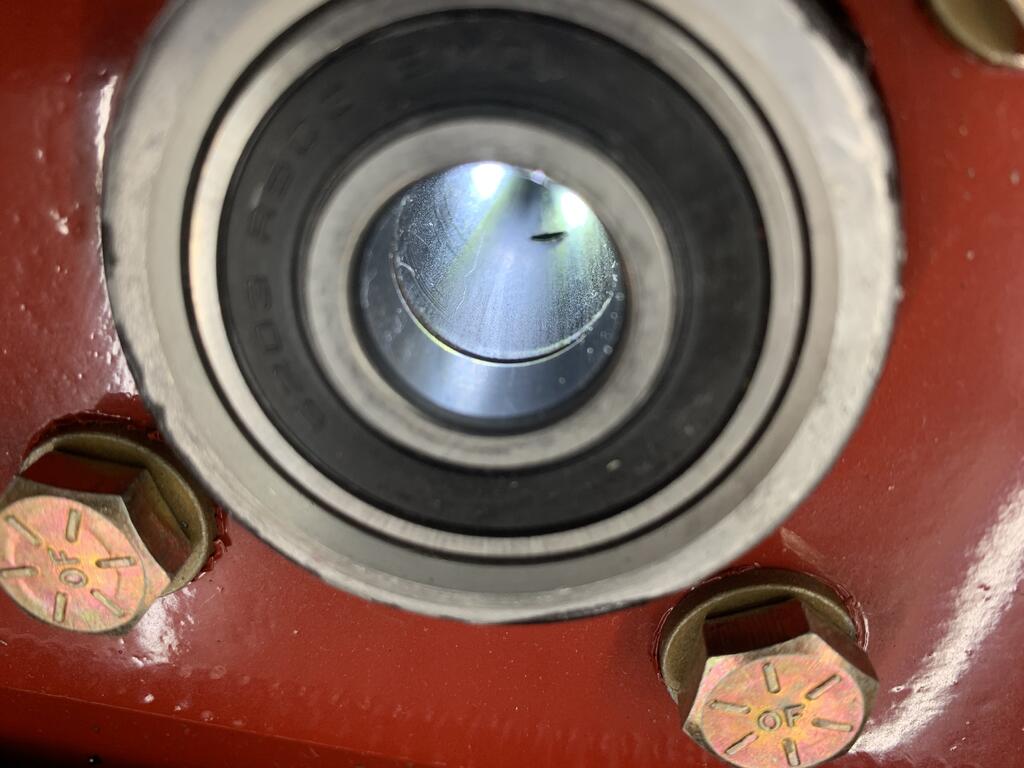

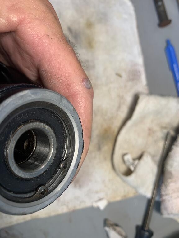

Check what I found… the spacer/ sleeve in the center spindle has 1 hole about centered end to end in the middle, while the left spacer/ sleeve has 2 holes - one on each end about a 1/2 inch from the ends… wonder why ?
left side spindle housing
center spindle housing

Jeff-C175
AFAIK they are, or should be, all the same.  All the ones I've seen have two.
I can't find the box with my junk parts!  I did find the 'collar' that I was talking about though.
IIRC, those notches in the collar need to be on the 'bottom' when the collar is installed.
But maybe those newer spindles are different than my old ones, because I thought there was a groove machined around the shaft where the grease exit holes are.
Can you get grease through the single hole?  Make sure it's drilled through!
Edited by Jeff-C175
Horse Newbie
IIRC, those holes in the collar need to be on the 'bottom' when the collar is installed.
Yes grease goes through the zerk, down the shaft and at least out of the single hole… think I should drill that single hole where it will go all the way through the shaft ?
Also note:
 On the center spindle, where the hole in the spacer/ sleeve is about 2 inches from each end/ centered, the holes in the haft will NOT be in alignment. And the left side where the spacer/ sleeve has a hole on each end, the holes there will not be in alignment either…
Edited by Horse Newbie

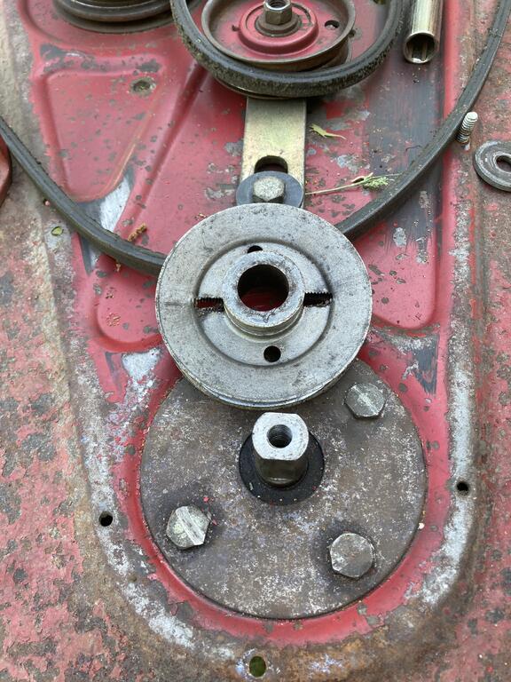

Horse Newbie
And where does this collar with the 2 slits go ?… I don’t have that .
Does it go under the bottom bearings between the bearing and the spindle cup ?
Jeff-C175
I see that... that part is from my old spindles and I did not take the new ones apart.
Obviously a different design.  I see much different stuff in there than in my old ones.
This collar goes on TOP.  I THINK that the top seal rides on it.  Below this collar was a sleeve.
If I could find the box with the old parts I could be more pacific.

Now that I have basically took the deck apart again , this is my plan…
Tell me what you think about these points…
1. The right and left spindle housings have spacer/ sleeves between the top and bottom bearings that have 2 holes in each- about  1/4” from each end.
2. The center spindle housing has a spacer/sleeve with one hole in the center about 2” from the ends.
3. The right and left spindle shafts have the grease hole bored all the way through and the center spindles shaft has one hole that doesn’t go all the way through.
So here’s my plan…
Drill a hole the rest of the way through the center spindle shaft so it will have 2 exit holes for the grease…
I do not plan to take apart the parts in the housings as I don’t have a way to press out the bearings, and I do not want to risk damaging the bearings by knocking them out.
Reassemble the deck, and when I go to apply grease, hopefully with the 2 holes that will now be in the center shaft, it will take grease as the right and left appeared to.
( I saw signs that grease had reached the bearings on the right and left sides with only a few, 3 or 4 pumps)

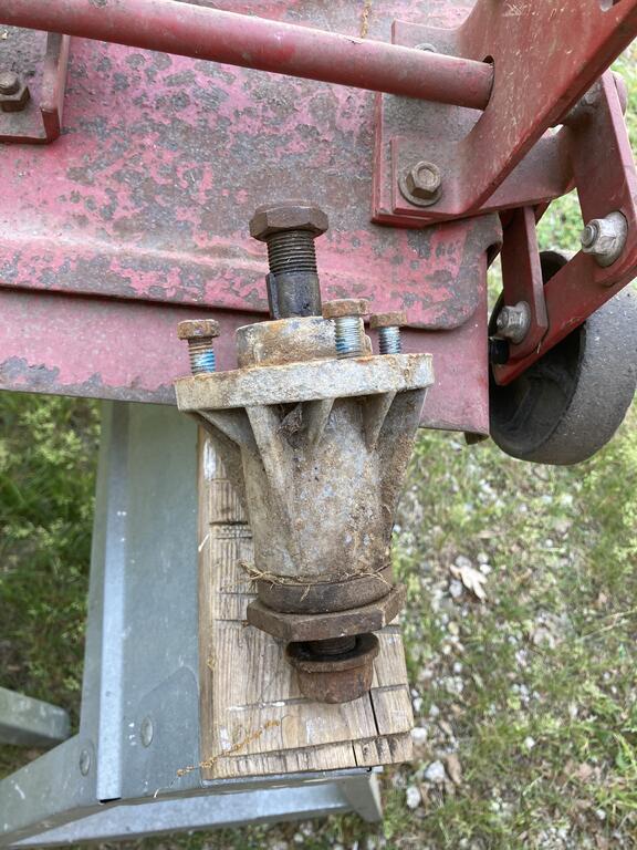

One more question… when I bolted the spindle housings to the deck, I used anti seize to keep the steel bolts from seizing to the threads in the aluminum housings… when I took off the spindle housing just now they didn’t seem very tight… think I should have used anti seize  ?

There are so many different spindles but I agree with Jeff, you would think the same spindles would be the same... The center driven spindle will always have more load on it Hence 2 holes...?
I usually just take them apart noting which spindle went where looking for any differences. Look at these old monsters.. Shaft is keyed & Check out the nut on the bottom... WH/TORO just couldnt leave well enough alone, Lol
So here’s my plan…
Great plan, Love it! They came from the factory wth blue Loc Tite, (you can see it on the bolts in the last pic). I put anti seize on mine because of dissimilar metals & they do break easily...

You mean they break loose easily with anti seize, or the aluminum breaks easily if you over tighten ?
Jeff-C175
2 minutes ago, Horse Newbie said:
blue Loc Tite
I used that on mine when I installed the new spindles.  I figured I wouldn't be taking them apart again in my lifetime !    :eek:   :text-lol:
Blasterdad
The housing breaks, one broke on my 48" deck like a crecent moon chunk around the bolt hole, it broke clean so I just bolted it back on, got lucky, Lol.

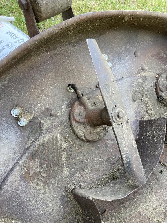

      I have a  WH 310-8 Mower Deck, Tach-a-Matic 42” Toro Model 05-42MS-05, Triple Blade (1981-83). One of the Mandel's (outer) will NOT take grease at the Zerk fitting have removed the Zerk tapped on it made sure hole and opening good etc. but to NO avail any suggestions here. Thanks
    • Horse Newbie
      By Horse Newbie
      So for the last 5 to 6 months I have been working on getting my 1994 520H up to operating condition after buying it from a friends backyard a few years ago...now that I'm 99 percent done with the tractor I want/ have to get the 48 inch SD deck that came with it up to operating condition also.
      As you can see by the pics I have a lot of work to do/ full restoration...I have a few questions before I get started...
      1. Do the two wheels on the back of the deck control the cutting height ?
      2. Where/ who is a good source for parts ?...I would like to go back with as much new parts as possible, but some of the pricier parts I will probably be willing to use used if my budget forces me to ( spindle are my main concern here).
      As you may be able to see from the pics, the front center of the deck has been knocked back quite a ways ( looks like PO centered a concrete driveway/ sidewalk edge, or one stout survey corner stob.
      Any suggestions about straightening the front edge would be greatly appreciated.
