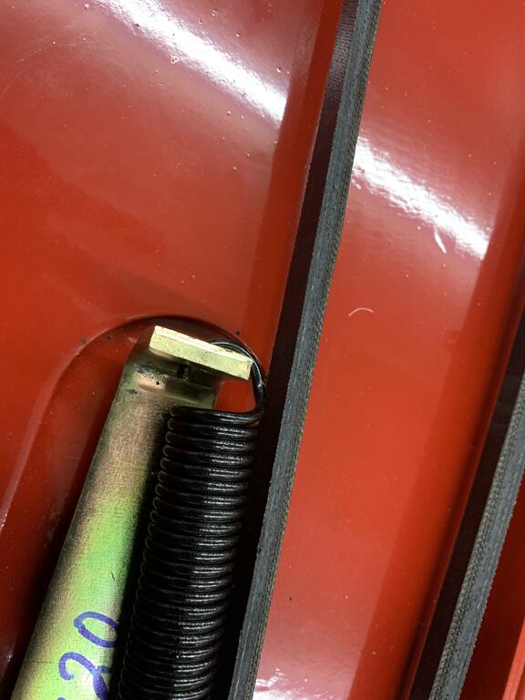

cleat
So long as you install the washer and clip as shown in the attached file your grease fitting will be safe
48 inch deck owners manual.pdf
Jeff-C175
Innerestin Cleat!  I wasn't aware that they added that to later tractors.  I'm presuming it's later tractors, because mine don't have the hole for the pin, I had to drill them... but that's EXACTLY what I did to mine!

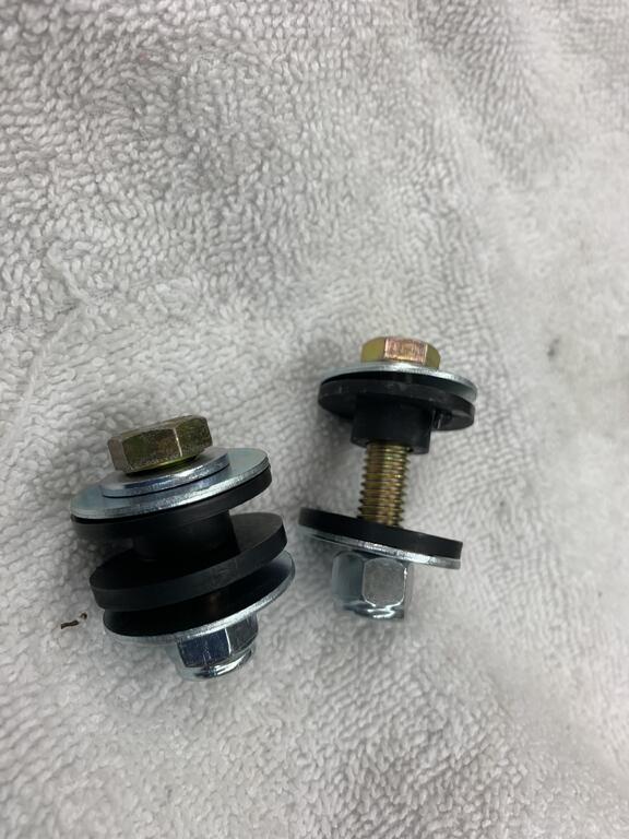

Are you aware of any lubrication being put on these plastic washers that the idler pulley slide bar rides in ?

No lube, just attracts crud, I just replaced mine on the 48 deck, most of us run with the belt cover off so we can clean everything after using it. I blow everything out with compressed air. The cover will hold in crud & moisture. If you"re worried about OSHA & feel you need it on rig something up so you can take it off easily to keep it clean & DRY in there.

I don't lube mine.  I think that's one of the places where any lube would cause dirt to stick and that would not be good.  The plastic slides quite well without lube.  Don't tighten the bolts too tight!  Just snug enough to hold the parts.  Don't want to squash the bushing.

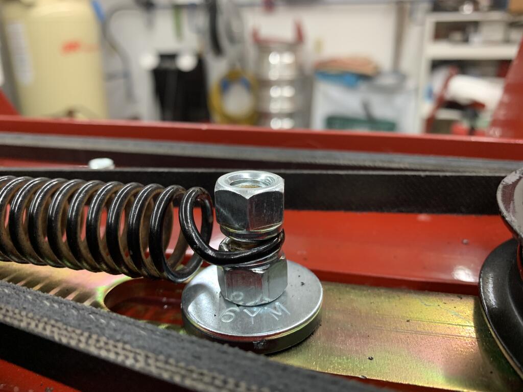

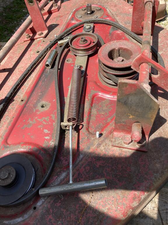

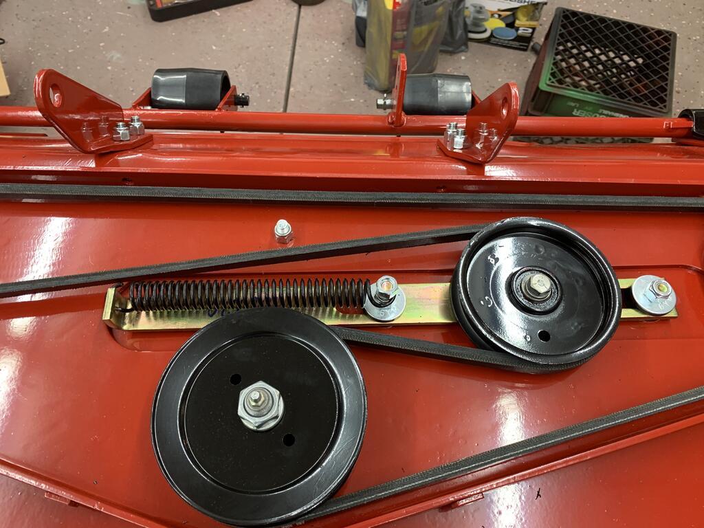

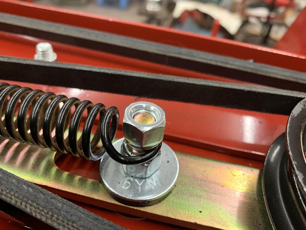

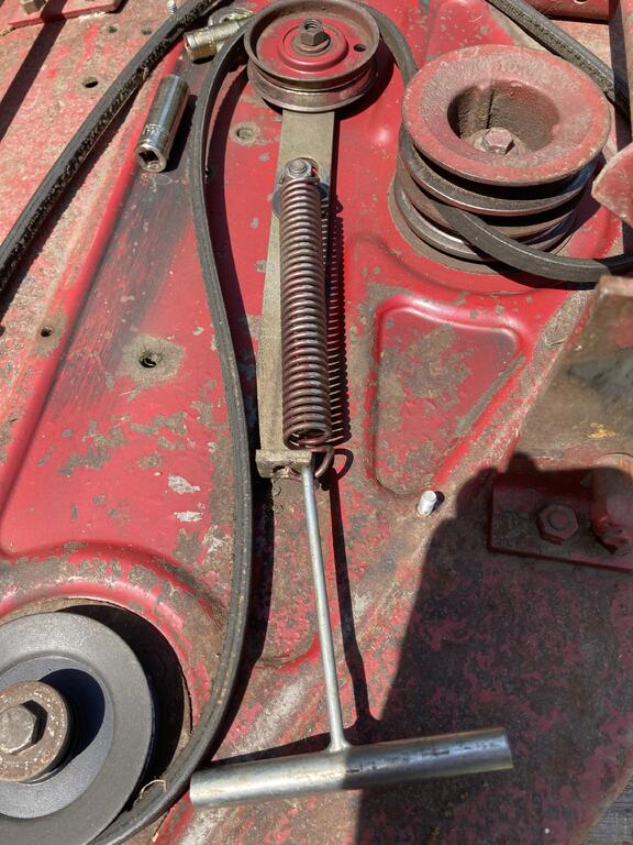

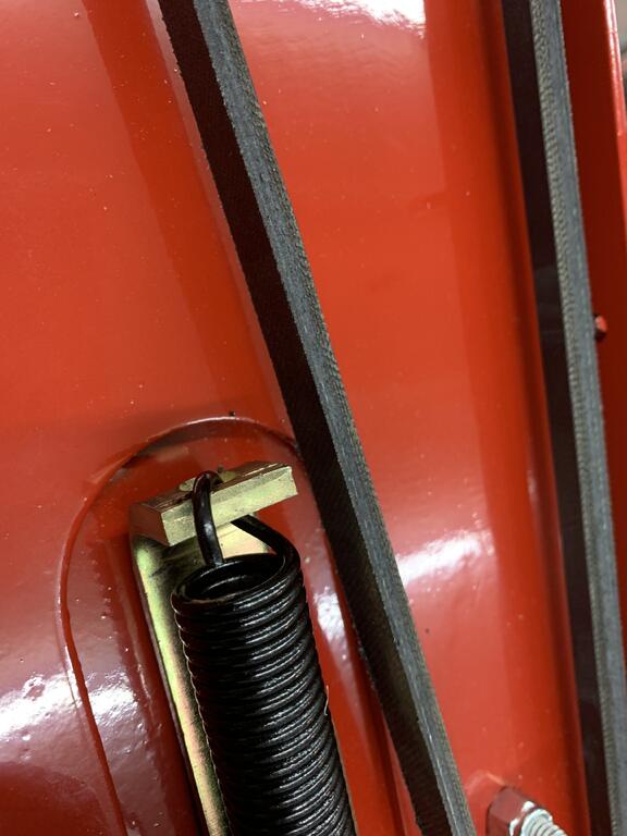

Another question @Jeff-C175 and @Blasterdad… can you all tell me how this spring attaches… over from one side, through the middle ?
A picture would be appreciated…
I know I’m gonna catch a fit trying to stretch that spring !
Horse Newbie
I looked at how the spring end was on the 42 inch SD deck from the Work Horse… got her on, but I had to use the Nylock “spring keeper” nut upside down to engage the Nylock part of the nut. I used the same length bolt that came off… guess the new Nylock nuts were a tad taller…
Edited by Horse Newbie
Horse Newbie

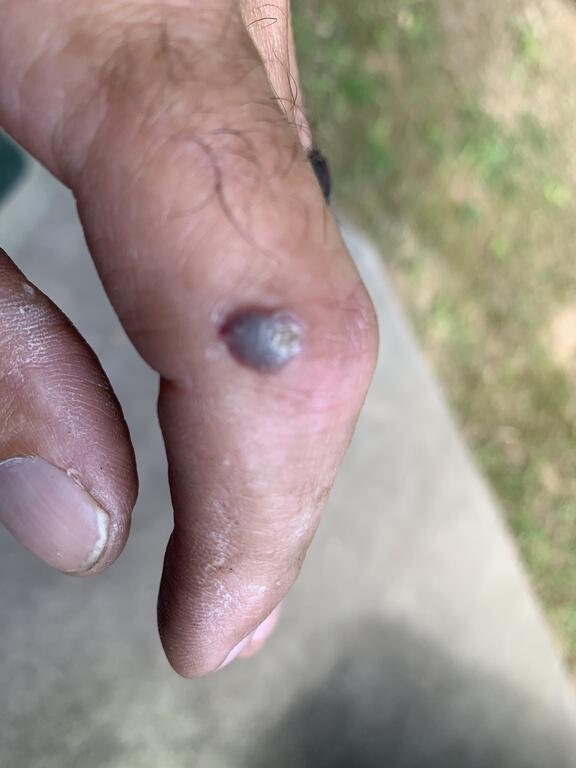

Got a little blood blister stretching that spring…

Now back to the task at hand... Just happen to be working on one right now... The spring goes on the side AWAY from the belt so it wont rub on it. Spring goes on the  post first then in the hole on the bracket as shown... I use a trampoline spring puller that come with the kids old trampoline, the reason I use that order is I just took one off tha was installed opposite, had to pull it off from the post bolt, it was a b***h.

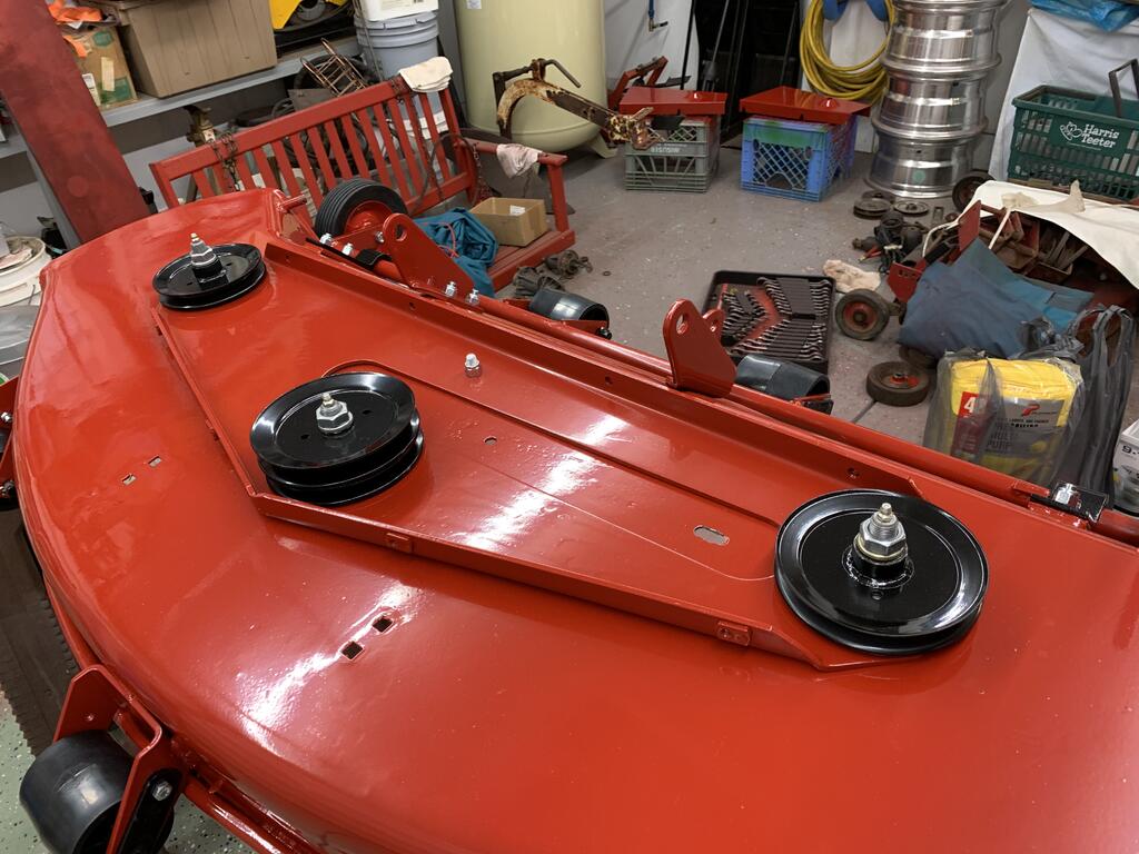

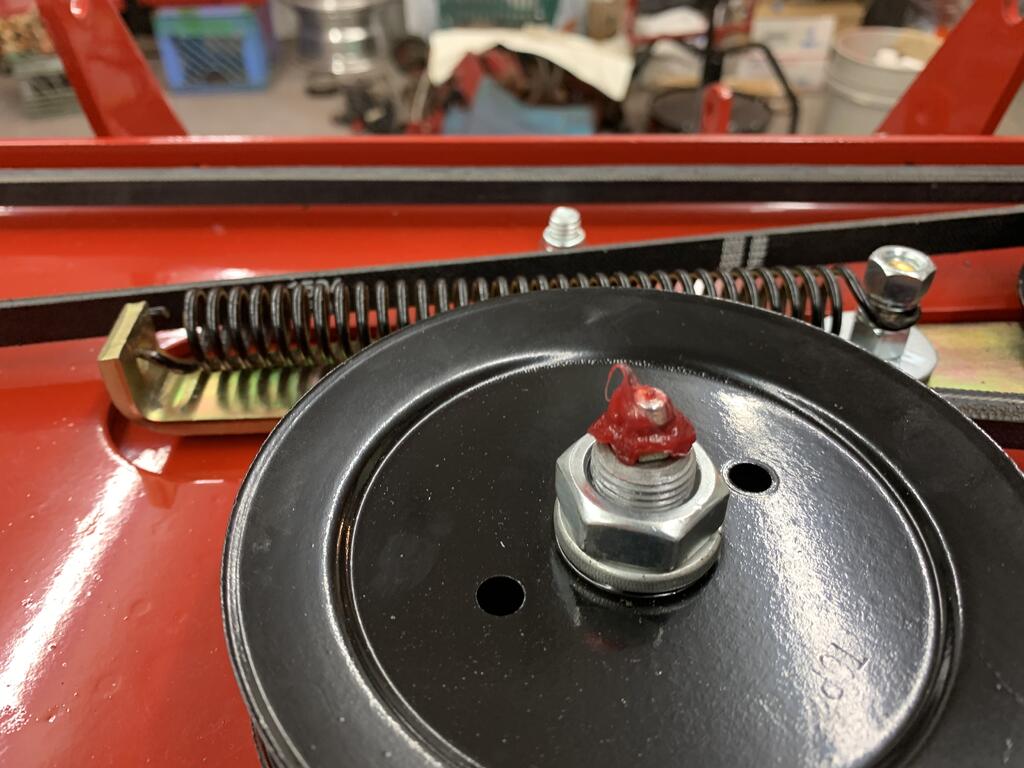

Have another problem…. I installed all the spindle parts the way they came new- unlined except for maybe a little bit of grease.
I was wondering about if grease would work it’s way down and up to the bearings with that small hole in the bearing spacer…
grease gun EXTREMELY HARD to pump… any ideas on how to proceed ?

I install the spring exactly as you have shown, and it's easier to do it with the belt NOT installed, that inch makes a difference!
I think the difference in the bolt height may be due to the steel washers.  Some guys use them, some don't.
If you took the washers off, you would probably find that the bolt fits just fine.  You could in fact run that bolt all the way down and let the spring rest on the notch created between the two nuts.
All three of them the same?  Not as simple as a 'stuck' zerk?
I'm guessing you removed the 'factory' grease?  Did you repack the bearings when you reinstalled the spindles?
That 'collar' inside the spindles has to be the right way around for the grease to get down into the spindle.  I believe if you install it upside down it blocks the grease hole inside.
I did not take the spindle assemblies apart… I looked down inside of the assemblies when I got them from @76c12091520h/ Brian. I did not see what looked like any amount of grease that would  be worth taking them apart over to remove. I figured with me putting in  the Lucas red sticky, it would be okay.
Guess I’m gonna have to disassemble and check things out… :ranting:

First pull the zerk and make sure it's not stuck.  Maybe take a sharp point and see if the ball presses down OK.

The tolerance in those new spindles will be very tight, grease will be hard to pump in there, run that beauty a couple of times then give it a little shot of grease, you should be good. :)
