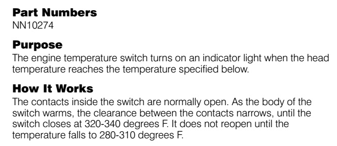

gwest_ca-(File Mod) 12,454 #3 Posted May 13, 2021 This is an Onan part 1 1 1 Share this post Link to post Share on other sites
Maxwell-8 4,371 #4 Posted May 13, 2021 I got me some hot-runners then. (Maybe to lean) 1 Share this post Link to post Share on other sites

pacer 3,180 #10 Posted May 13, 2021 For instance, where is this 'temperature switch' placed?? would get different readings in several places. I would think that 400° at the exhaust wouldnt be unusual. For example, have you ever seen the exhaust pipe at the exit of the block glowing a bright cherry red?? At high rpms its very common. 2 Share this post Link to post Share on other sites

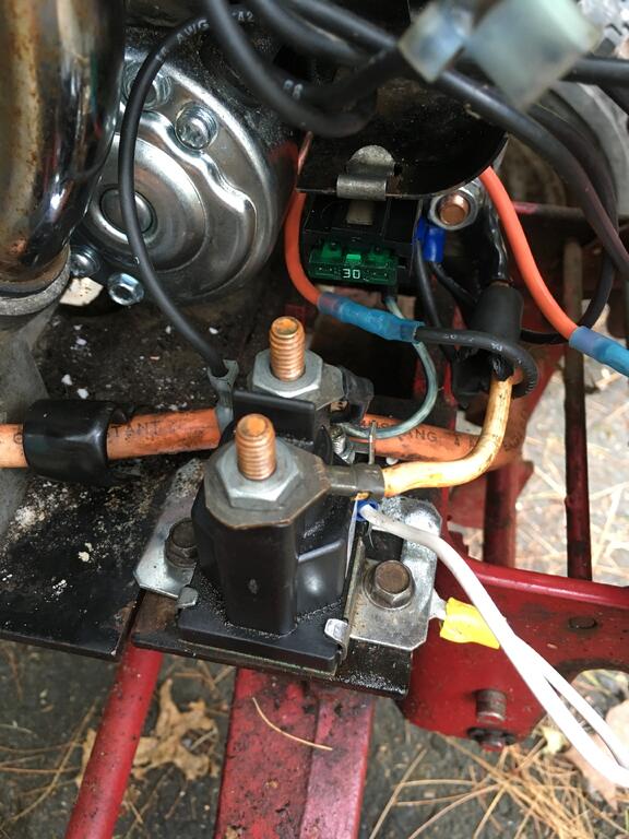

Handy Don 17,316 #11 Posted May 13, 2021 20 minutes ago, Maxwell-8 said: That's what i am using, and found out the hottest place is on the head on the exhaust-side . Gettting readings of 400° on a 4 stroke chinese piece of junk The temp sensor on the Onan P220 is on the right side on the forward cylinder down near the starter solenoid. My 218 doesn't have one. This is away from the valves and manifolds, which are on top, and where the cooling airflow is exiting past the fins. It is attached in a boss cast into a cooling fine with metal contact. Now you've put an idea into my head and next time I'm running the 218 I'm gonna bring the infrared "gun" that I use for checking on my wood stove. BTW, on a clear day aim one of these at the sky and you'll often see -40º (C and F are the same at this temp)--nothing up there emitting or reflecting infrared! 3 Share this post Link to post Share on other sites
WheelHorse520H 710 #12 Posted May 14, 2021 6 hours ago, Handy Don said: BTW, on a clear day aim one of these at the sky and you'll often see -40º (C and F are the same at this temp)--nothing up there emitting or reflecting infrared! Seems like you got bored! Although that sounds like something I would do, sooo. 6 hours ago, Handy Don said: The temp sensor on the Onan P220 is on the right side on the forward cylinder down near the starter solenoid. That’s correct, in the attached photo you can see the base of the dipstick tube, it is like 2 inches above that, that’s where I would measure. 1 Share this post Link to post Share on other sites
