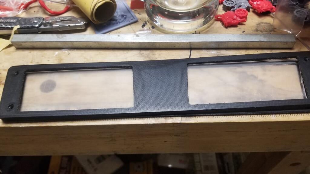

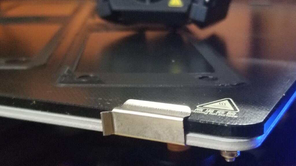

Wheel Horse 3D 3,821 #76 Posted May 22, 2021 Spacing and size look perfect on that test run, so bezel and back are currently printing in black on the new machine! 1 Share this post Link to post Share on other sites
Wheel Horse 3D 3,821 #77 Posted May 23, 2021 Lens lightly frosted with 300 grit sand paper 1 Share this post Link to post Share on other sites

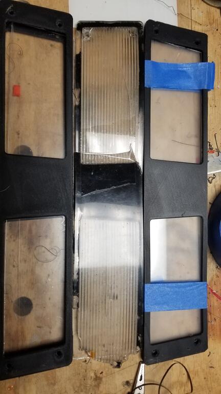

Wheel Horse 3D 3,821 #86 Posted June 1, 2021 Made some progress yesterday getting the prints to line out, sometimes its just tinker tinker till its right. Got some of the smoothest layers ive ever printed layin down now. Should be able to see after work if the print went ok and how well the layers adhered etc., Prototype lens should be headed out to Bob today! 1 1 Share this post Link to post Share on other sites

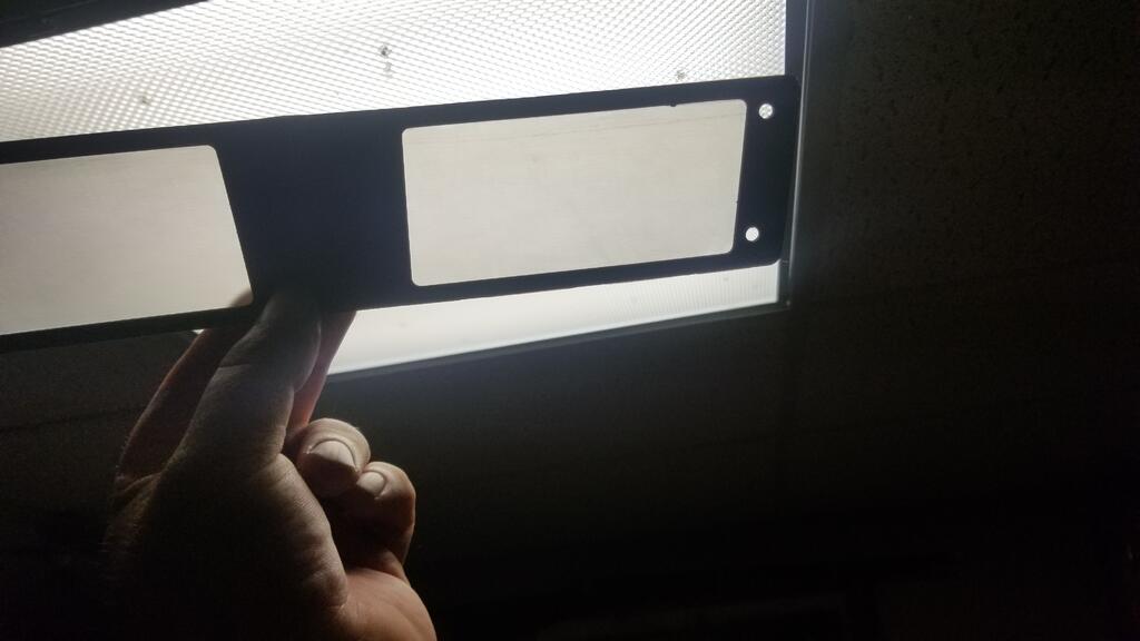

Wheel Horse 3D 3,821 #87 Posted June 1, 2021 Slight tweak on the length of the back plate, otherwise print settings look good! 1 1 Share this post Link to post Share on other sites

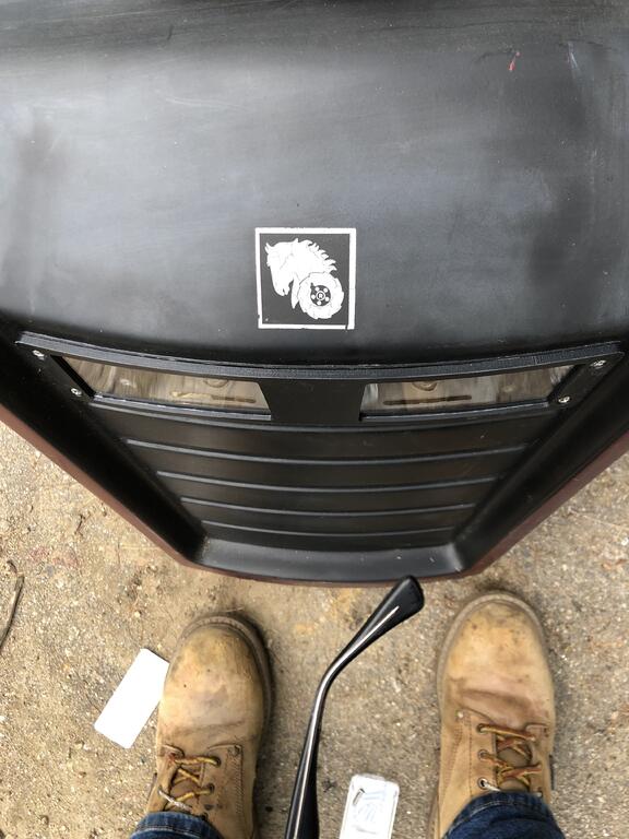

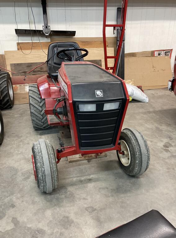

WheelhorseBob 1,550 #93 Posted June 19, 2021 Got it today! And here it is on my unrestored hood. The holes were very close. Keep in mind the screws they used were 6-32 and they had zero wiggle in them. Hopefully WH used a template to drill and they don’t vary much. Thanks again! Oh I spruced it up with new stainless fasteners of the original size. 2 1 Share this post Link to post Share on other sites
Wheel Horse 3D 3,821 #94 Posted June 19, 2021 Thank you Bob! I did leave the back plate holes a bit bigger for easier alignment, and there should be a little meat left there to slightly enlarge the front holes if needed. The screw pockets look good. If ya ever want to frost the lens i did a little more testing on that ...and 300 grit front AND back seems about perfect. If anyone wants to gloss up their bezel, enamel paints work well on these plastics. Bob's is the natural finish and texture straight from the printer. 1 Share this post Link to post Share on other sites

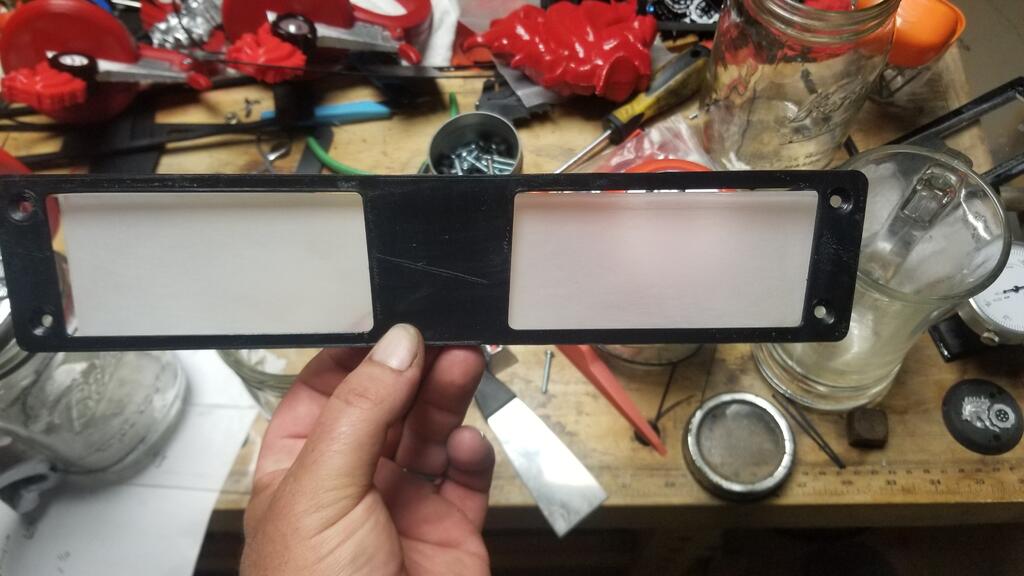

Wheel Horse 3D 3,821 #96 Posted June 20, 2021 Heres an example of the 300 grit front and back Share this post Link to post Share on other sites

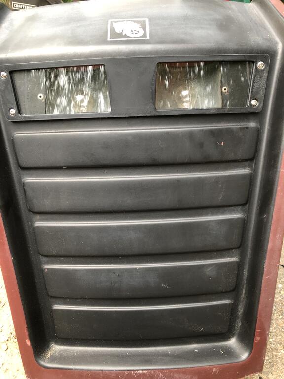

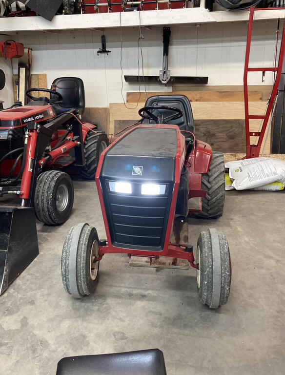

cschannuth 3,817 #99 Posted June 25, 2021 I received the lens and installed it last night and I think it looks better than the original with the frost. It actually covers up some of the inconsistencies in the headlight bucket and gives it a very clean look. Thanks @Wheel Horse 3D 2 Share this post Link to post Share on other sites
