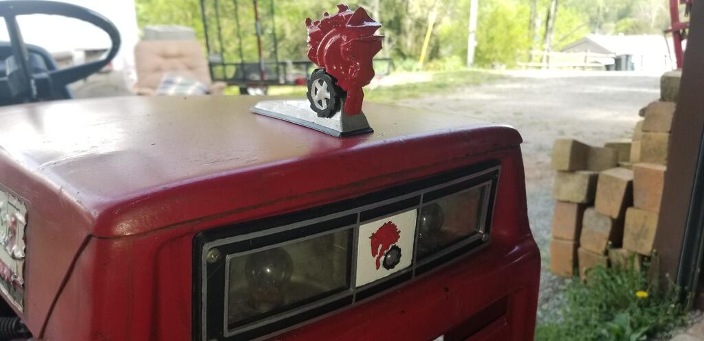

Wheel Horse 3D 3,825 #5 Posted May 12, 2021 If Dan is correct, and the year you provided(1978) i have this one off of a c141 the same year model. Ive replaced it with of my 3d printed ones and ill part with the original at a good price. 1 Share this post Link to post Share on other sites

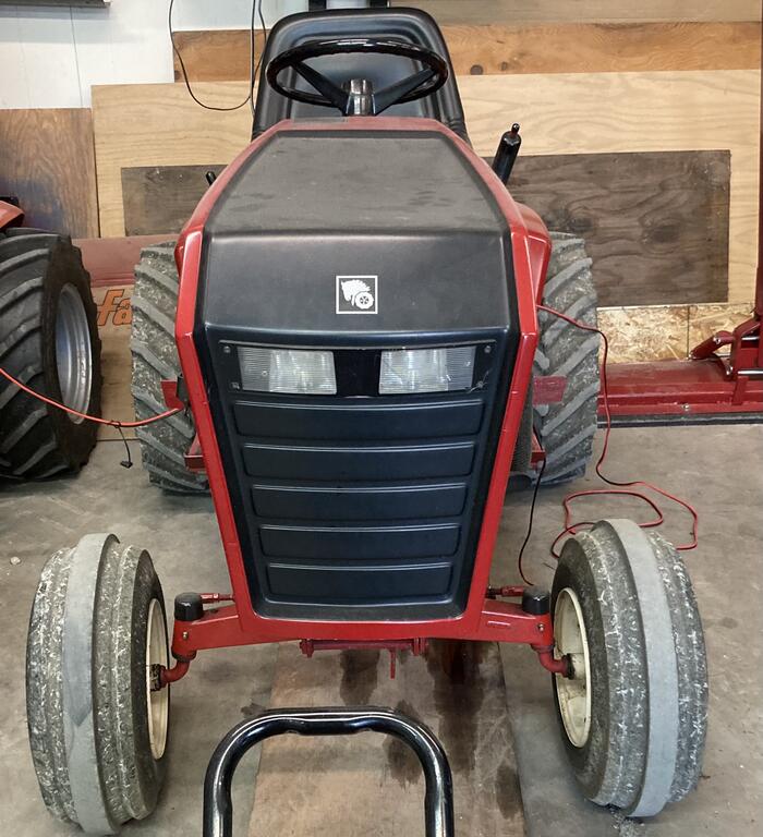

cschannuth 3,821 #6 Posted May 12, 2021 The 78 lens was an oddball and may have also been used for 1979. I don’t have a close-up of it but this is what mine looks like and they are like hens teeth. If anybody has a source, I would like to have an extra as well. 1 1 Share this post Link to post Share on other sites

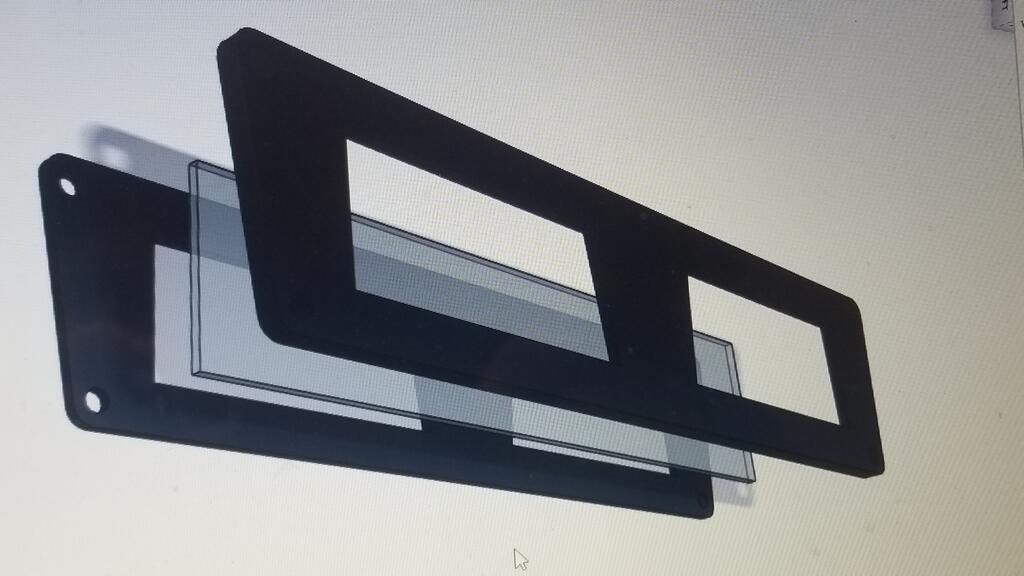

Wheel Horse 3D 3,825 #7 Posted May 12, 2021 I can 3d print a replacement version just like i did for the common lenses. Lenses can be kept clear,frosted, or even tinted and swap out easy. 4 Share this post Link to post Share on other sites
SPINJIM 1,997 #8 Posted May 12, 2021 The headlight lens for the fiberglass hood is different than the one for the metal hoods, and as rare as hen's teeth (as has been said). There was one here on the Forum about a year ago, when the owner didn't know what kind of hood it fit. Maybe he still has it. The fiberglass hoods don't hold up very well. They dry out, flake, and tend to crack from vibrations, etc. similar to the plastic fenders. I'd stay with the metal hood and the easier to find headlight lens. 3 Share this post Link to post Share on other sites

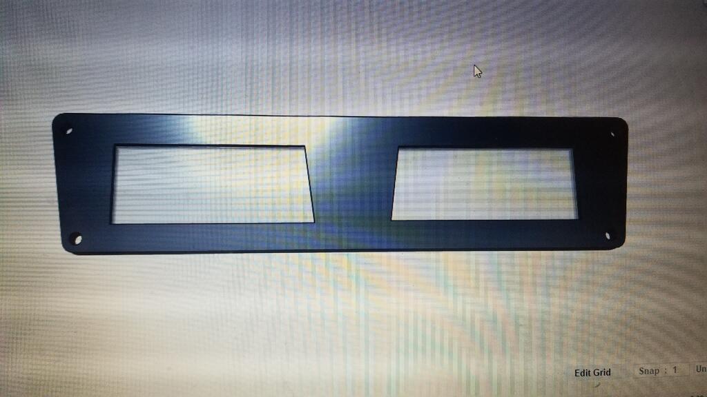

Wheel Horse 3D 3,825 #9 Posted May 12, 2021 Rare as Hens Teeth is right up my alley..lemme throw together a quick model to give folks an idea. Of course it wouldn't be as desirable as a factory mint, or for that MINT show tractor, but it would get lenses to horses that need 'em. 3 Share this post Link to post Share on other sites
Wheel Horse 3D 3,825 #10 Posted May 12, 2021 There we go..just a general idea, overall construction the same as the others. Can easily be customized if someone wanted with logo etc., but otherwise should print well. 4 Share this post Link to post Share on other sites
wh500special 2,432 #11 Posted May 12, 2021 That lens is unique to the C-161-twins and the E-141 electric tractor. Not interchangeable with anything else. I sold one (Thanks Craig!!) on the classifieds a short while ago. For such an unusual piece, it had a surprising lack of interest...kind of a common theme among WH guys to focus on the common instead of the exotic. Steve 2 1 Share this post Link to post Share on other sites

WheelhorseBob 1,550 #17 Posted May 12, 2021 1 hour ago, Wheel Horse 3D said: There we go..just a general idea, overall construction the same as the others. Can easily be customized if someone wanted with logo etc., but otherwise should print well. Do you have the dimensions needed to reproduce this? I could remove the one I have, it may have enough left to get dimensions from. Let me know. 2 Share this post Link to post Share on other sites
Wheel Horse 3D 3,825 #18 Posted May 12, 2021 1 minute ago, WheelhorseBob said: Id need dimensions, and if youd be willing ro send a busted up one, with as many pieces as you can retain that would be perfect! Share this post Link to post Share on other sites
WheelhorseBob 1,550 #19 Posted May 12, 2021 5 minutes ago, Wheel Horse 3D said: Id need dimensions, and if youd be willing ro send a busted up one, with as many pieces as you can retain that would be perfect! Will do, I’ll remove it tonight. Let me know where I’m sending it. 2 1 Share this post Link to post Share on other sites
Wheel Horse 3D 3,825 #20 Posted May 12, 2021 41 minutes ago, WheelhorseBob said: Will do, I’ll remove it tonight. Let me know where I’m sending it. SWEET! Thanks to Bob I'll hop on that just as soon as it arrives,we'll now have that rare part covered, and I'll be sure to bring at least one to the Big Show! Share this post Link to post Share on other sites

Wheel Horse 3D 3,825 #24 Posted May 12, 2021 The frame is printed in an abs plastic that is not so rigid and brittle and forms to the tractor body better and isn't prone to cracking.(Ever seen a cracked LEGO?). It would have to be VERY cold to crack one of these even if you over tightened a screw. 1 Share this post Link to post Share on other sites
haydendavid380 759 #25 Posted May 13, 2021 15 hours ago, Wheel Horse 3D said: I can 3d print a replacement version just like i did for the common lenses. Lenses can be kept clear,frosted, or even tinted and swap out easy. What hardware are you using to attach? Share this post Link to post Share on other sites
