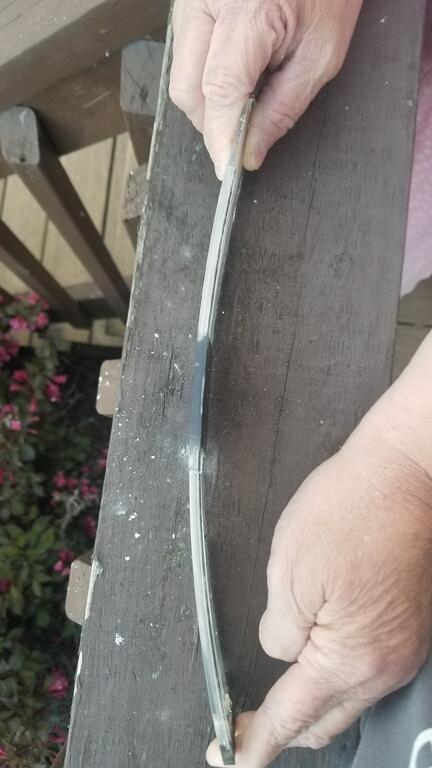

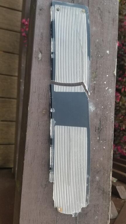

Wheel Horse 3D 3,822 #60 Posted May 18, 2021 Got Bob's lens in today! But looks like it got flattened in shipment and cracked in half. But good thing is all the pieces are still there and Ill start modeling on this tomorrow! This, even cracked, has a definate curve. Wonder if they were molded that way, or get stuck that way as they get brittle over time. Share this post Link to post Share on other sites
EricF 589 #61 Posted May 18, 2021 Looks like you've got enough of the mounting holes in the broken end to at least get a measurement off of them, and then add on the measurement you get from the good end to get a pretty close estimate on the whole thing's dimensions. A little tougher accounting for the bend, but still doable figuring the linear measurement along the edge. I'd guess that the original plastic is some sort of hard acrylic that was molded close to the curve it would take when mounted -- that kind of plastic tended to be a bit brittle right from the get-go, so molding it flat and wrapping it to the shape of the hood would have been a no-no. Modern stuff that stays flexible will make it easier to print as a flat piece once the dimensions are dialed-in. 1 Share this post Link to post Share on other sites
cschannuth 3,819 #62 Posted May 19, 2021 1 hour ago, Wheel Horse 3D said: Wonder if they were molded that way, or get stuck that way as they get brittle over time. The NOS one I got from Steve @wh500special is perfectly flat. I don’t know if they came flat or if it just flattened out being stored for so many years. 1 Share this post Link to post Share on other sites
WheelhorseBob 1,550 #63 Posted May 19, 2021 Dang usps! I even sprang for a bubble rap envelop. Well I hope it is of use to you,?sounds like a few folks need them. 1 Share this post Link to post Share on other sites

Wheel Horse 3D 3,822 #65 Posted May 19, 2021 38 minutes ago, WheelhorseBob said: Dang usps! I even sprang for a bubble rap envelop. Well I hope it is of use to you,?sounds like a few folks need them. Itll do just great. Thank you for sharing! And as far as the curve, i have the measuements fron the flat one provided, and I can eyeball any curvature alignment pretty well. 1 Share this post Link to post Share on other sites

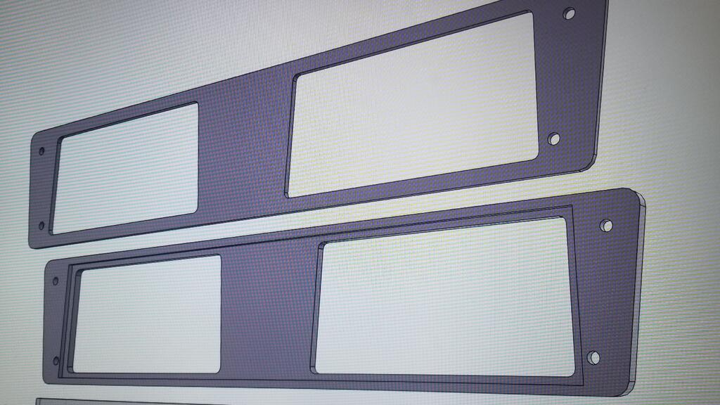

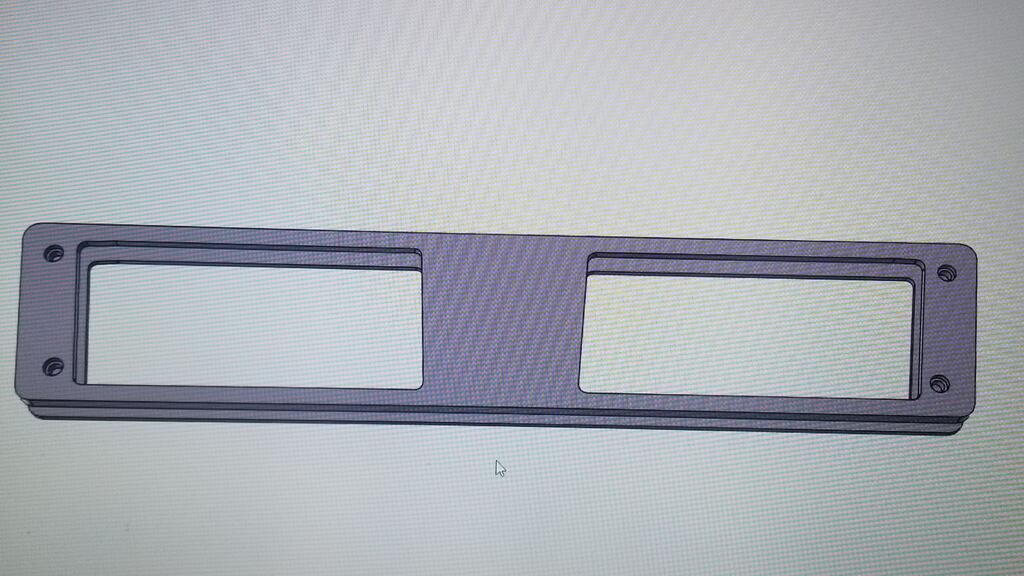

Wheel Horse 3D 3,822 #67 Posted May 19, 2021 Drum roll please! ............. TA DAAA!!!!! 1 1 Share this post Link to post Share on other sites
Wheel Horse 3D 3,822 #68 Posted May 19, 2021 Anyone like to see any custom additions? Share this post Link to post Share on other sites
cschannuth 3,819 #69 Posted May 19, 2021 11 minutes ago, Wheel Horse 3D said: Anyone like to see any custom additions? Looks great. Is there anyway the clear opening can be as large as the original? Share this post Link to post Share on other sites
Wheel Horse 3D 3,822 #70 Posted May 19, 2021 4 minutes ago, cschannuth said: Looks great. Is there anyway the clear opening can be as large as the original? Due to the screw holes we lose a bit on either side. and the end cuts were left square to simplify cutting the plexi, especially since this portion overlaps the hood anyway. We could tweak the end cuts so they are at a similar angle lemme see if I can tweak that and see how it looks, just a little more difficult on the plexi cutting. Share this post Link to post Share on other sites

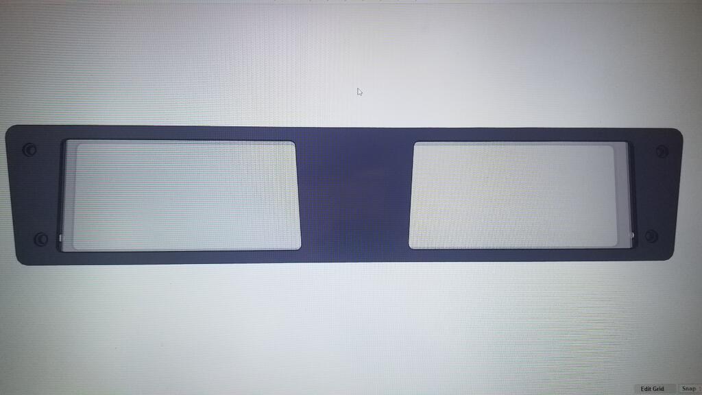

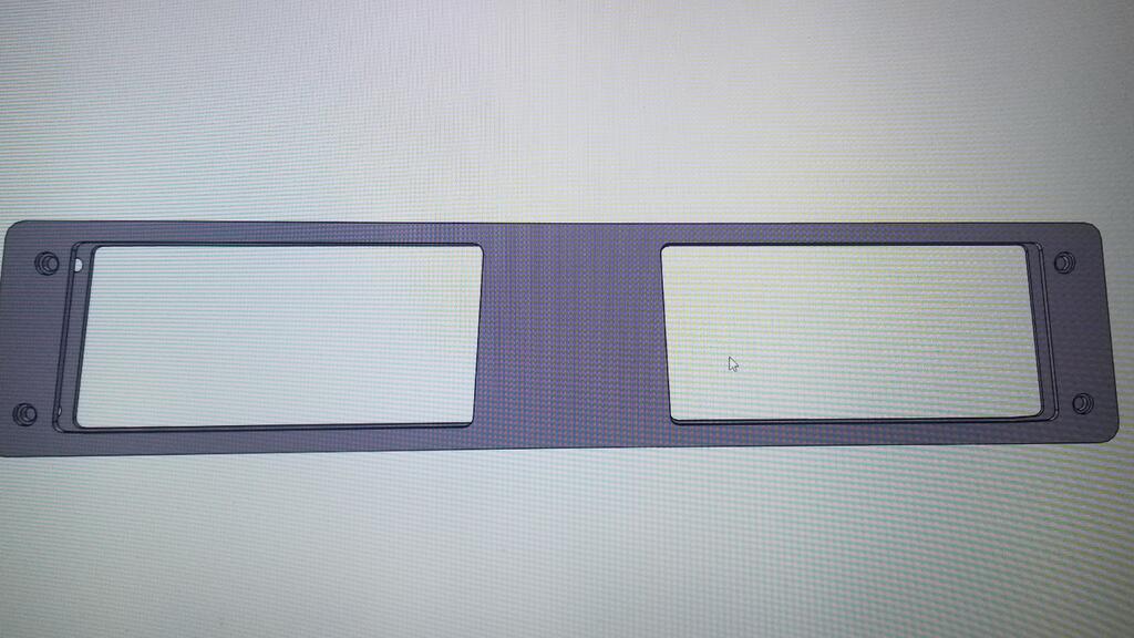

Wheel Horse 3D 3,822 #71 Posted May 19, 2021 That gained a little bit more opening. 1 Share this post Link to post Share on other sites
Wheel Horse 3D 3,822 #72 Posted May 19, 2021 Whoops, upside down pic lol. Share this post Link to post Share on other sites
Wheel Horse 3D 3,822 #73 Posted May 19, 2021 Thats better. 1 1 Share this post Link to post Share on other sites

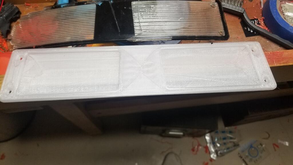

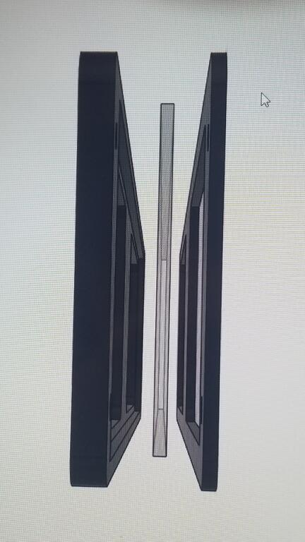

Wheel Horse 3D 3,822 #74 Posted May 21, 2021 Since i happened to load some clear PETG on Max for his first test, lemme stack this bezel and see what it looks like in the "clear" filament. Cant hurt! Share this post Link to post Share on other sites
Wheel Horse 3D 3,822 #75 Posted May 22, 2021 Hmmmmmm Share this post Link to post Share on other sites
