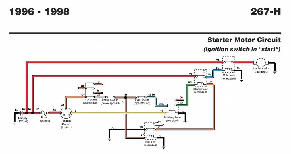

gwest_ca-(File Mod) 12,489 #3 Posted May 12, 2021 May be too small to read Complete file - the ink is still wet 1 Share this post Link to post Share on other sites
Achto 32,795 #4 Posted May 12, 2021 (edited) Look over the diagram, make sure all of the safety switches are working properly and that the starter solenoid is grounded. Edited May 12, 2021 by Achto 2 Share this post Link to post Share on other sites

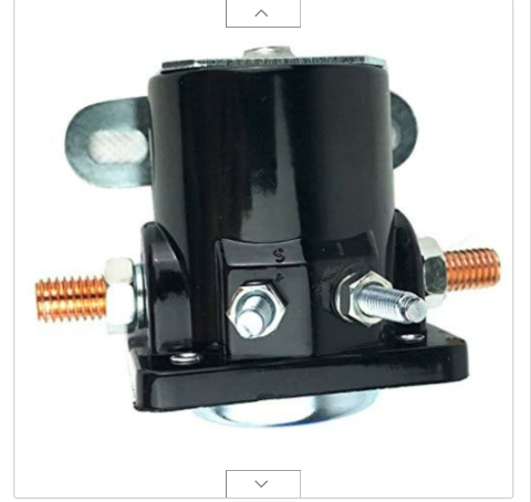

Gregor 4,848 #6 Posted May 12, 2021 22 hours ago, 953 nut said: If your new solenoid has two small terminals one of them needs to be grounded. As my uncle Mike use to say, " I dunt agrrrree wit wut yer sayin' but I'll defend til dett, your rrrrright to say it" If yous solenoid looks like this, I would not ground one of the terminals. Share this post Link to post Share on other sites
pfrederi 21,177 #7 Posted May 12, 2021 There are many different solenoids in the world. Some have only one small terminal. they are grounded through the mounting bracket. The there are ones with 2 small terminals. If they are marked S and I then they are grounded through the mounting bracket. (The I is to bypass a ballast resister and increase voltage to the coil/points during starting mode.. if the second terminal isn't marked I then it is probably the ground as the mounting bracket is NOT grounded. 2 Share this post Link to post Share on other sites
