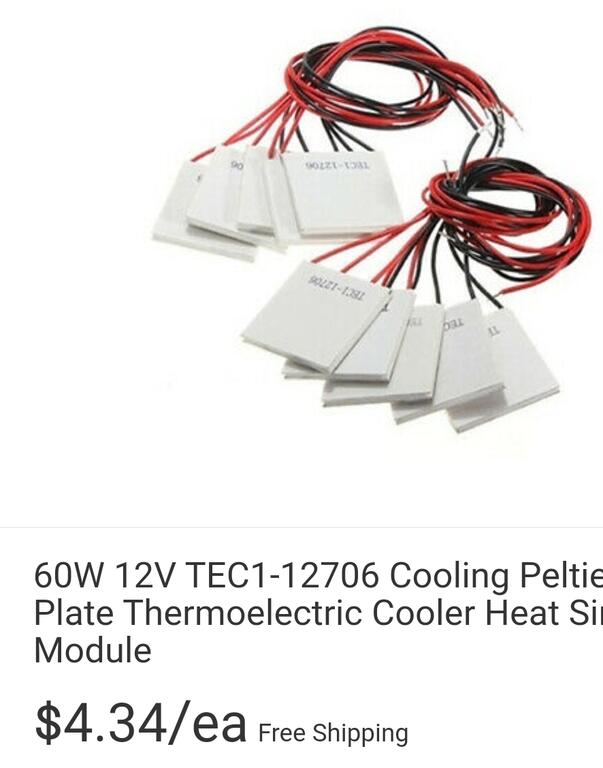

Wheel Horse 3D 3,824 #165 Posted May 26, 2021 Rated around 4a at 12v... Share this post Link to post Share on other sites
Wheel Horse 3D 3,824 #166 Posted May 26, 2021 So for 30 bucks or so, ya got a 20A 12v system. Share this post Link to post Share on other sites

DennisThornton 4,773 #170 Posted May 26, 2021 5 minutes ago, Wheel Horse 3D said: Rated around 4a at 12v... Oh MY! You have my attention! Share this post Link to post Share on other sites
Wheel Horse 3D 3,824 #171 Posted May 26, 2021 Now this is how they are rated as a cooling device w/ 12v applied i guess, so maybe output would be different. Share this post Link to post Share on other sites

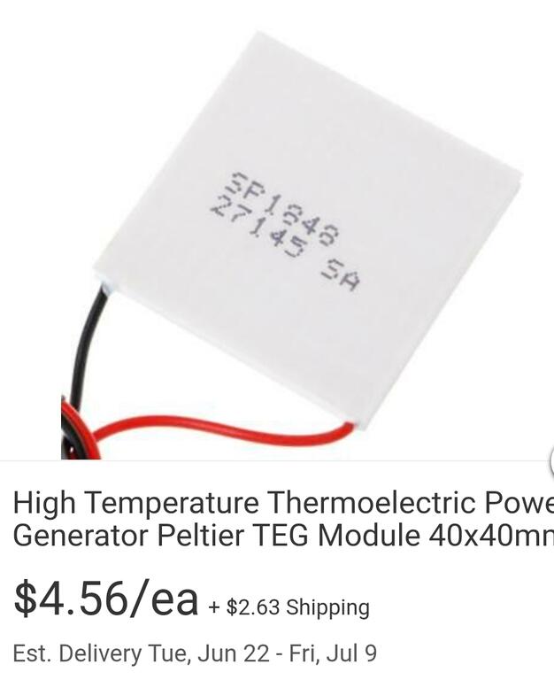

Wheel Horse 3D 3,824 #173 Posted May 26, 2021 Here we go, this one, with a 100 degree difference between sides is 4 plus volts at 600ma. Share this post Link to post Share on other sites
Wheel Horse 3D 3,824 #174 Posted May 26, 2021 4 minutes ago, DennisThornton said: Why a diode? Just to keep the current in one direction, if your hot side ever gets cold, and yer cold side warmer, your current would wanna go the other way and drain any of your batteries Share this post Link to post Share on other sites
Wheel Horse 3D 3,824 #175 Posted May 26, 2021 Maybe some heat sinks or water cooled on the cold side? Share this post Link to post Share on other sites
