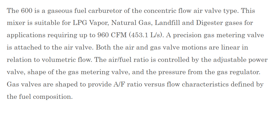

bc.gold 3,406 #127 Posted May 16, 2021 18 hours ago, bc.gold said: Here's a link to my wood gas files http://ovh.to/TpABqf Wood gas would be classified as producer gas, IMPCO has you covered. Impco 600 Series Carburetor. 1 1 Share this post Link to post Share on other sites

DennisThornton 4,773 #132 Posted May 22, 2021 On 5/16/2021 at 10:31 AM, bc.gold said: Wood gas would be classified as producer gas, IMPCO has you covered. Impco 600 Series Carburetor. The more I think about it the more I think I should research woodgas again. I'd be happy if it just ran a stationary engine that spun a generator. That doesn't address me getting off this hill and back but it would go long way to making life here on the hill easier and more pleasant. I'm just not setup for long term offgrid events without gasoline and doubt that I ever will if that means solar. Upstate NY doesn't see the sun that much in Dec-Jan so solar heat is not a complete answer for me nor is doing without any electricity for the same period. During our icestorm I managed for several days with NO electricity and then finally fixed my 110 generator and could rotate the fridge, freezer and TV to make life somewhat more normal then I borrowed a distant neighbors to run the deepwell and do some wash so I managed to get by for 10 days without the grid. I have multiple gensets now but they all need gas pretty regularly! Oh! I'll never get rid of my woodstove! Heated the house and cooked all my meals! Got plenty of wood too! If a deal comes along for a pto driven genset I'll grab it and worry even less about gasoline. At least I can haul and store a LOT of diesel for quite some time! Several hundred gallons of propane onsite too. Another use for that Impco carb! Thanks! 1 1 Share this post Link to post Share on other sites
bc.gold 3,406 #133 Posted May 22, 2021 21 minutes ago, DennisThornton said: The more I think about it the more I think I should research woodgas again. I'd be happy if it just ran a stationary engine that spun a generator. That doesn't address me getting off this hill and back but it would go long way to making life here on the hill easier and more pleasant. I'm just not setup for long term offgrid events without gasoline and doubt that I ever will if that means solar. Upstate NY doesn't see the sun that much in Dec-Jan so solar heat is not a complete answer for me nor is doing without any electricity for the same period. During our icestorm I managed for several days with NO electricity and then finally fixed my 110 generator and could rotate the fridge, freezer and TV to make life somewhat more normal then I borrowed a distant neighbors to run the deepwell and do some wash so I managed to get by for 10 days without the grid. I have multiple gensets now but they all need gas pretty regularly! Oh! I'll never get rid of my woodstove! Heated the house and cooked all my meals! Got plenty of wood too! If a deal comes along for a pto driven genset I'll grab it and worry even less about gasoline. At least I can haul and store a LOT of diesel for quite some time! Several hundred gallons of propane onsite too. Another use for that Impco carb! Thanks! With wood gas aka producer gas your dealing with a low pressure system so high pressure hoses, water heated regulator are not needed to run a low pressure system. John on the phone last night discussing our river water project when forklifts became part of our talk regarding LPG fuel, this is when I told him I was on the lookout for an Impco 425 mixer. Like me he's dealt with scrap metals most of his life and as it turns out he had been saving all the LPG and natural gas systems that came into the yard. I now have the mixer I've been looking for soon to be sent parcel post. 1 Share this post Link to post Share on other sites
DennisThornton 4,773 #134 Posted May 22, 2021 1 hour ago, bc.gold said: With wood gas aka producer gas your dealing with a low pressure system so high pressure hoses, water heated regulator are not needed to run a low pressure system. John on the phone last night discussing our river water project when forklifts became part of our talk regarding LPG fuel, this is when I told him I was on the lookout for an Impco 425 mixer. Like me he's dealt with scrap metals most of his life and as it turns out he had been saving all the LPG and natural gas systems that came into the yard. I now have the mixer I've been looking for soon to be sent parcel post. Great! I love getting a jump on a project so I can take my time to source parts and materials! 10 cents on the dollar is not uncommon if you have time to watch and wait. AND spread the word a bit! And yes, I like the idea of no high pressure. I've seen and I think shared a link to gas to steam conversions but I have concerns about durability. Wish I had water at a height but my low lying brook sometimes even dries up. Wind is an option but it would need a 100ft plus tower to get above the pines. And of course that needs a lot of storage... 1 Share this post Link to post Share on other sites

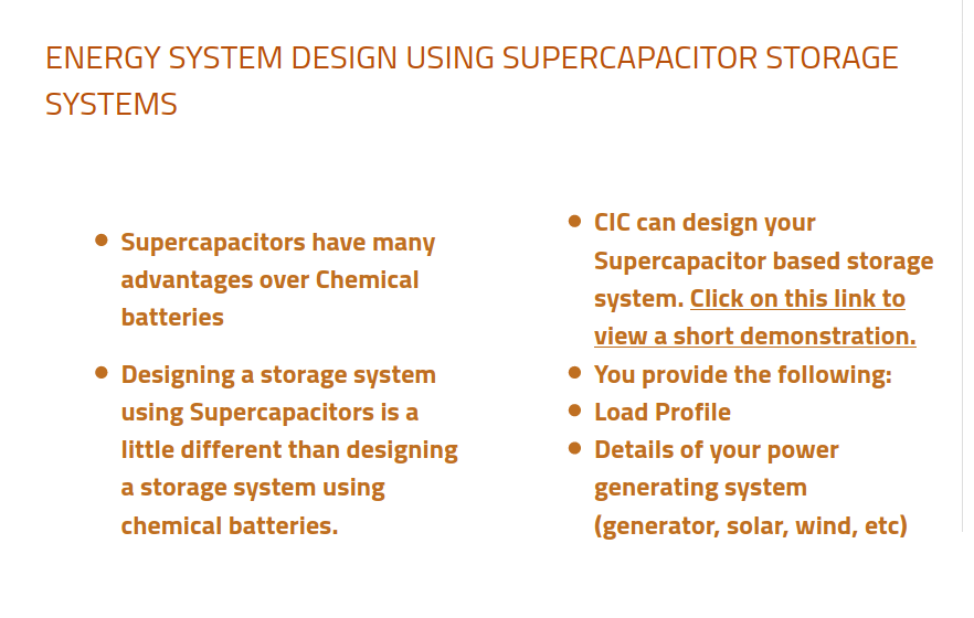

bc.gold 3,406 #135 Posted May 22, 2021 1 hour ago, DennisThornton said: And of course that needs a lot of storage... Share this post Link to post Share on other sites
DennisThornton 4,773 #136 Posted May 22, 2021 48 minutes ago, bc.gold said: I knew they were coming but does this mean that Super Caps are almost here? Share this post Link to post Share on other sites
