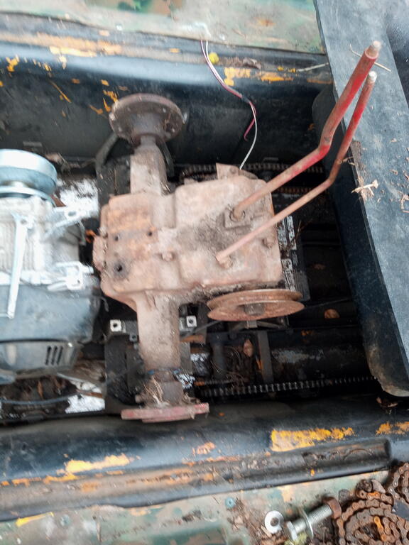

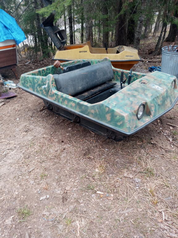

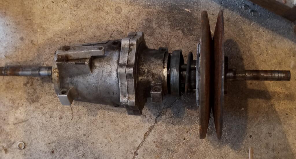

4wheelsis2toofew 23 #1 Posted May 9, 2021 (edited) I like amphibious ATVs, and living in northern Minnesota, they're what you need to handle the terrain, which is thousands of small lakes, separated by soft ground, all of which is frozen and snow covered for a lot of the year. I have an early 70's Attex 6x6 amphibious ATV that had a predator 11 horse 4 stroke swapped into it. The original transmission was a Baker-Hill monstrosity, most of which is missing, and the parts I have are broken. The Baker-Hill has a CV clutch driven gearbox for forward/reverse (see picture), the shaft you can see is one piece all the way through the gear box, skid steering was by 2 outboard planetary gear sets controlled by 4 disc brakes. (missing) My intent is to replace it with an 8 speed Wheel Horse transmission I got when scrapping out a neglected Wheel Horse tractor. It will sit amidships, roughly as seen in this picture. I have to move the battery, and I might have to flip the engine around too, or perhaps I'll put the tranny in the back, and move the motor to the middle, I might need a jack shaft instead, so I don't end up with 4 reverses and two forward gears. (I had a friend accidentally do that with a 2 wheel drive motorcycle/sidecar) I plan to mount a disc rotor on each side as a steering brake, and then a sprocket to drive each side. I'm still not entirely sure what tranny I have. The axles measure 1-1/4ish, and if I spin one wheel, the other goes the other way, so I assume it's open vs limited slip. The donor Wheel Horse had model/serial numbers 91-12K802-12619 and 9050. Edited May 9, 2021 by 4wheelsis2toofew 4 2 Share this post Link to post Share on other sites

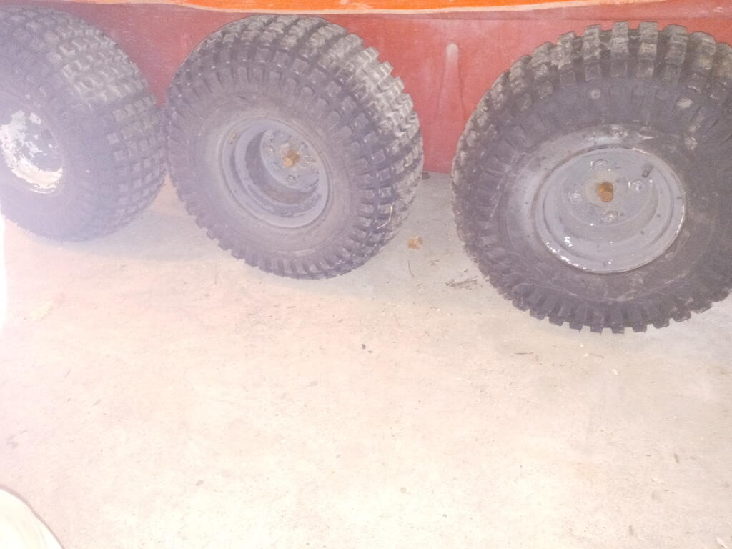

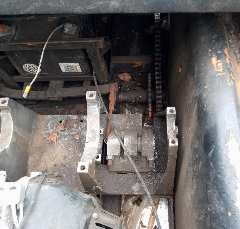

4wheelsis2toofew 23 #7 Posted May 9, 2021 Here is a picture of the double disc steering caliper on one side. It's a goofy system. I might reuse it, if it lines up, but I'd think a pair of motorcycle hydraulic calipers would be better, but I might use some other mechanical calipers I have off of another 6x6. For those unfamiliar with these vehicles, here is a picture of the wheels from the project vehicle, currently mounted on my Argo 6x6 3 2 Share this post Link to post Share on other sites

slim67 2,825 #13 Posted May 10, 2021 13 hours ago, 4wheelsis2toofew said: Here is a picture of the double disc steering caliper on one side. It's a goofy system. I might reuse it, if it lines up, but I'd think a pair of motorcycle hydraulic calipers would be better, but I might use some other mechanical calipers I have off of another 6x6. For those unfamiliar with these vehicles, here is a picture of the wheels from the project vehicle, currently mounted on my Argo 6x6 Didn't they usually come with the Rolligon tires? I know there were/are several manufacturers of those. Amphicat is probably the one Im thinking of. Id like to have one myself someday along with all the other stuff on my list. 1 Share this post Link to post Share on other sites
4wheelsis2toofew 23 #14 Posted May 10, 2021 10 hours ago, slim67 said: Didn't they usually come with the Rolligon tires? They originally did have the "hubless" style of tires, I think those tires are hard to find now. I'm going to use modern ATV rims/tires for my project, as they're more available, and this current rig is going to be more for snowplowing and light hauling than my Argo 6x6, which I'm keeping light for better swimming capabilities. This project 6x6 is fitted with a full length metal skid plate, so it's already a little heavier than stock. 1 Share this post Link to post Share on other sites

4wheelsis2toofew 23 #20 Posted May 12, 2021 12 hours ago, tom2p said: also recall his had some sort of chain or belt issue (?) Amphibious 6x6s tend to have a silly amount of chains and/or belts. I have three different ATVs, all with different configurations. The simplest has a transaxle and 6 chains. The most complicated (current project) has I think 8 or 10 chains in total. Mine are from the 1970s, and borrow a lot of design from snowmobiles. Most use a CV clutch between engine and transaxle, some people fit a centrifugal clutch instead. On the current project I think I'm going to use the old gearbox (gutted out) as a jackshaft between the motor and the Wheel Horse transmission. 2 Share this post Link to post Share on other sites
