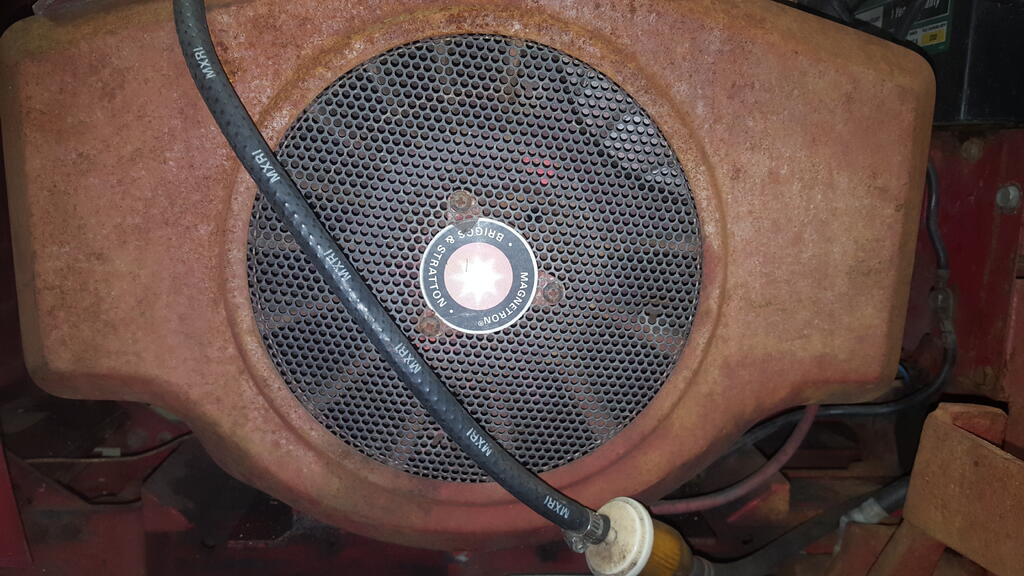

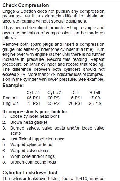

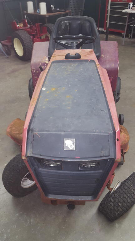

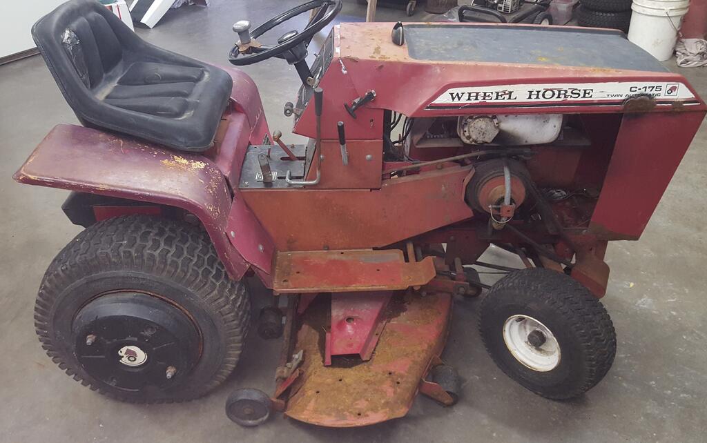

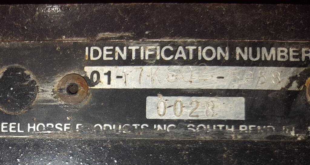

Gregor 4,848 #1 Posted May 9, 2021 (edited) Well, there it is, such as it is. Gonna need a little TLC. It is a Briggs & Stratton, 18HP I/C Commercial engine. I tried to find serial number tags on the engine, but haven't yet. I was hoping for a Kohler, but I can live with it. As little as I know about Kohlers, I know even less, about B/S. I hope someone does. I have a battery charger on it, and I pulled and cleaned the plugs up a bit. I will hook a clean fuel line to it, and see what it does. "It ran when parked" That was last spring, so I was told. The numbers say 17KS02 - 5958 0028 Tractordata doesn't list a 17KS02 Can a compression test be done on this motor, or does it also have some type of compression release? Edited May 9, 2021 by Gregor 2 Share this post Link to post Share on other sites

Maxwell-8 4,371 #4 Posted May 9, 2021 (edited) The 01-17KS02 you have is a 1980 model and should have the sundstrad 90 hydro. Special way off dealing with the plastic seat-pan. The engine: indeed both cylinders should have an equally compression. Ain't a Kohler but at least it's an opposed which is stronger then the V briggs. Edited May 9, 2021 by Maxwell-8 Share this post Link to post Share on other sites

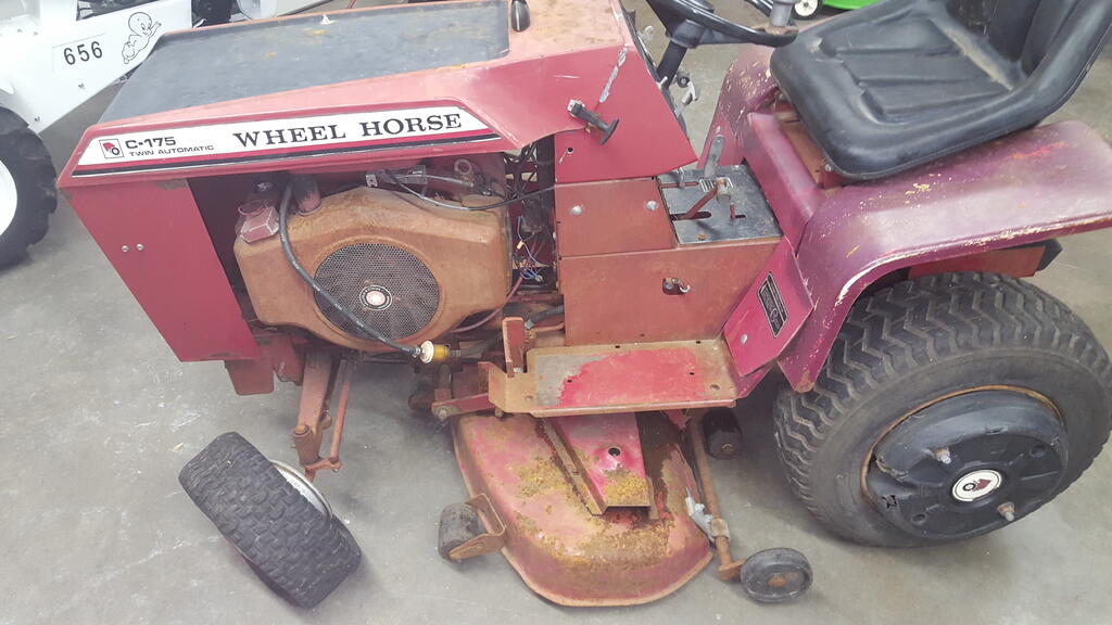

Gregor 4,848 #6 Posted May 11, 2021 My 175 has a Sundstrand trans in it, which means it has a freewheeling valve. Of course this valve is stuck tight, and refuses to move. Just like my 141, I never did get it freed up. I have to pull this tractor to my storage for a while. Would I be better of to drain the trans, or would that do more harm than good? Share this post Link to post Share on other sites

Gregor 4,848 #13 Posted May 11, 2021 (edited) 1 hour ago, ebinmaine said: Can that push / toe valve be freed up with something like heat or penetrating oil? Huge leverage? Anything like that? I tried all that on my 141, never got anywhere. I don't have the fender off yet, so I'll give it another crack when I can get at it better. Three times while trying to start this thing yesterday and Sunday, it puked enormous amounts of gas into the carb. So much so, that I have changed the oil, 3 times. I was actually able to get a carb kit, and manifold gaskets in town yesterday, so I let it soak in Berrymans for several hours, then ran it through a couple cycles in my sonic cleaner. and installed the kit. A bit different than a Kohler, with the fuel pump right on the carb, but Taryls video, helped a lot. I just finished putting the carb back on. I don't want to jinx myself by saying it sounds pretty good. I know from past experience what can happen, so I'll just say it runs. Now I have to wait for the block, and tin work for the 125 to get back. While I have the time, I will pull the fuel tank off this 175, clean it inside, and out, and run a temporary fuel line. I guess I don't have to pull it around to storage anymore. P.S. If you ever have occasion to rebuild one of these carbs, I would NOT pull the needle seat. Pulling it isn't hard. Getting a new one back in, is a I have another carb on order, just in case. P.S. P.S. I also ordered a new starter. Today, this one turns over just fine. Go figure. 20210511_103733.mp4 Edited May 11, 2021 by Gregor 2 Share this post Link to post Share on other sites

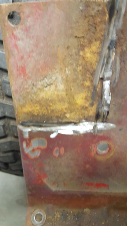

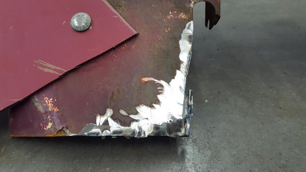

Gregor 4,848 #14 Posted May 11, 2021 Someone welded that Indy style flaring to the running boards. I don't mean just little tack welds either. I mean SOLID ! The nerve of some peoples kids ! Never ceases to amaze me. 1 Share this post Link to post Share on other sites
Gregor 4,848 #15 Posted May 11, 2021 8 hours ago, pfrederi said: If the hydro is in good shape you will not be able to push it more than a very few feet before you have the tires sliding... Yep! I can push it about 2 feet, and that's it. Won't go anymore. 8 hours ago, ebinmaine said: Can that push / toe valve be freed up with something like heat or penetrating oil? Huge leverage? Anything like that? I'm afraid to use heat. I don't know what's in there, but seems like a good place for a seal or O ring. I can get at it now. I have it soaking, and walloped it a couple of times, but still won't move. Cleaned up the tank, ran a temporary fuel line with 2 filters in it. Used a vise grip to hold the seat on, and went for a little joy ride. Tomorrow it will go into storage before I am tempted to tear it down. I have had 2 tractors tore down at once before. Not doing that again. 1 Share this post Link to post Share on other sites
