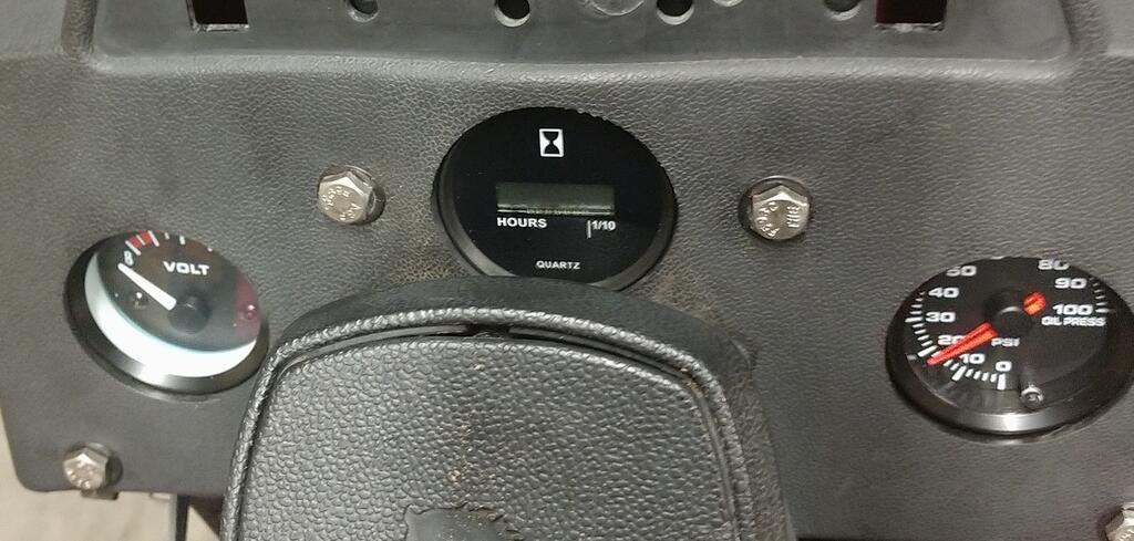

kpinnc 14,548 #81 Posted September 20, 2021 Started on the electrical this weekend. This console came from a 518-H, so only 3 gauges. With that, and the sensors I have for this engine- I stuck with the basics. Hour meter, voltmeter, and oil pressure. Gotta figure out if I can put a "T" in the oil port, because I want to keep the pressure kill switch. Anyway, now I'm building a wiring harness. I hate the electrical part! 3 1 Share this post Link to post Share on other sites
Lee1977 7,182 #82 Posted September 20, 2021 It shouldn't be a problem to add a tee to keep the oil pressure switch. I added a tee at the filter on my C-120 I have a oil pressure light and gauge attached. 1 Share this post Link to post Share on other sites
ebinmaine 72,307 #83 Posted September 20, 2021 4 hours ago, kpinnc said: the electrical part Interesting how many people say that. I'm well aware I ain't quite right but I find building a simple tractor harness to be quite relaxing. Mind you we run no safeties in our older machines and there's only about 10 wires... Very nice work so far. I'm sure the wiring will be as well. Share this post Link to post Share on other sites
kpinnc 14,548 #84 Posted September 20, 2021 7 hours ago, Lee1977 said: I added a tee at the filter on my C-120 I have a oil pressure light and gauge attached. Thank you sir! That is what I had in mind, but wasn't sure if it would work or not. Share this post Link to post Share on other sites

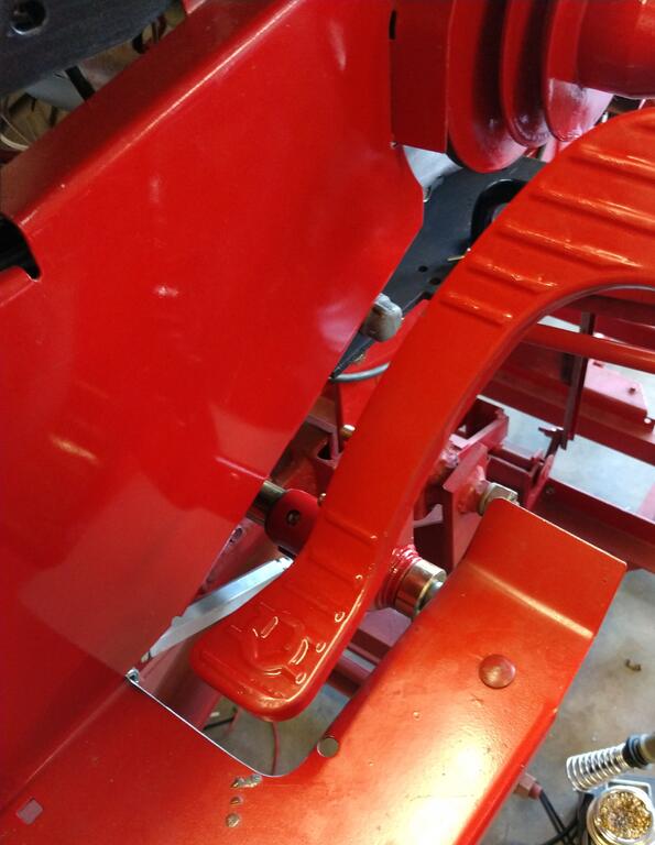

kpinnc 14,548 #89 Posted September 25, 2021 (edited) 8 hours ago, pullstart said: Do you ever draw the needs of the wiring on a schematic (aka. cardboard box) before building the wiring? I find that if I draw out the needs of every component, it helps to work it out in live wire time. Did I mention I'm kinda lazy when it comes to electrical? I just lay out each circuit and use lots of zip ties. With the exception of a couple fuses, and the oil pressure sender, it's done. Thanks for the compliments though. Seems like the closer I get to finishing this, the more I remember that I thought was already done! I finished the hydro pedal, but set the friction too high at the cam and bent the long linkage that passes through the dash. One more thing to come back to later... I notched the foot rest, even though it didn't need it. I figured the extra room for adjustments and wear would be a good thing. I'll run a brace under the footrest just to be safe. My decals should be here next week. Hopefully that will provide the neccesary motivation to finish this thing. Edited September 25, 2021 by kpinnc 1 2 Share this post Link to post Share on other sites

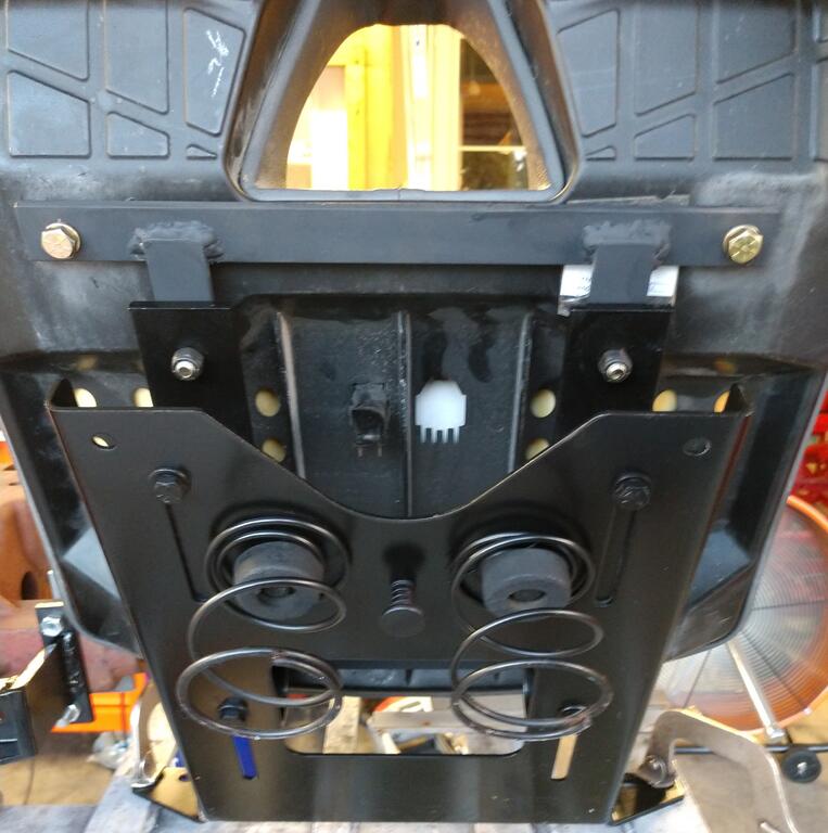

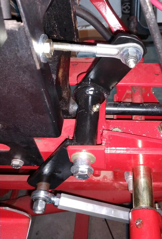

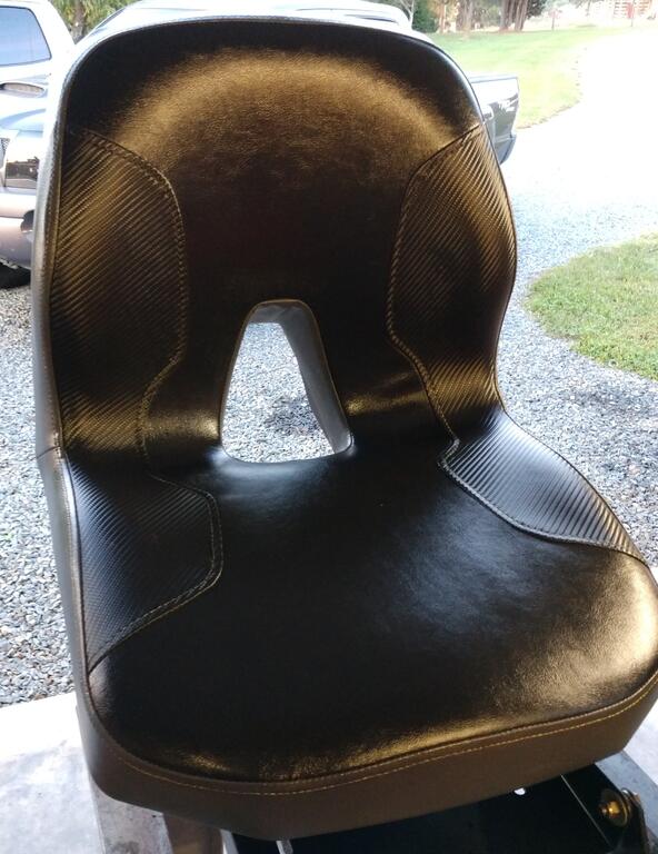

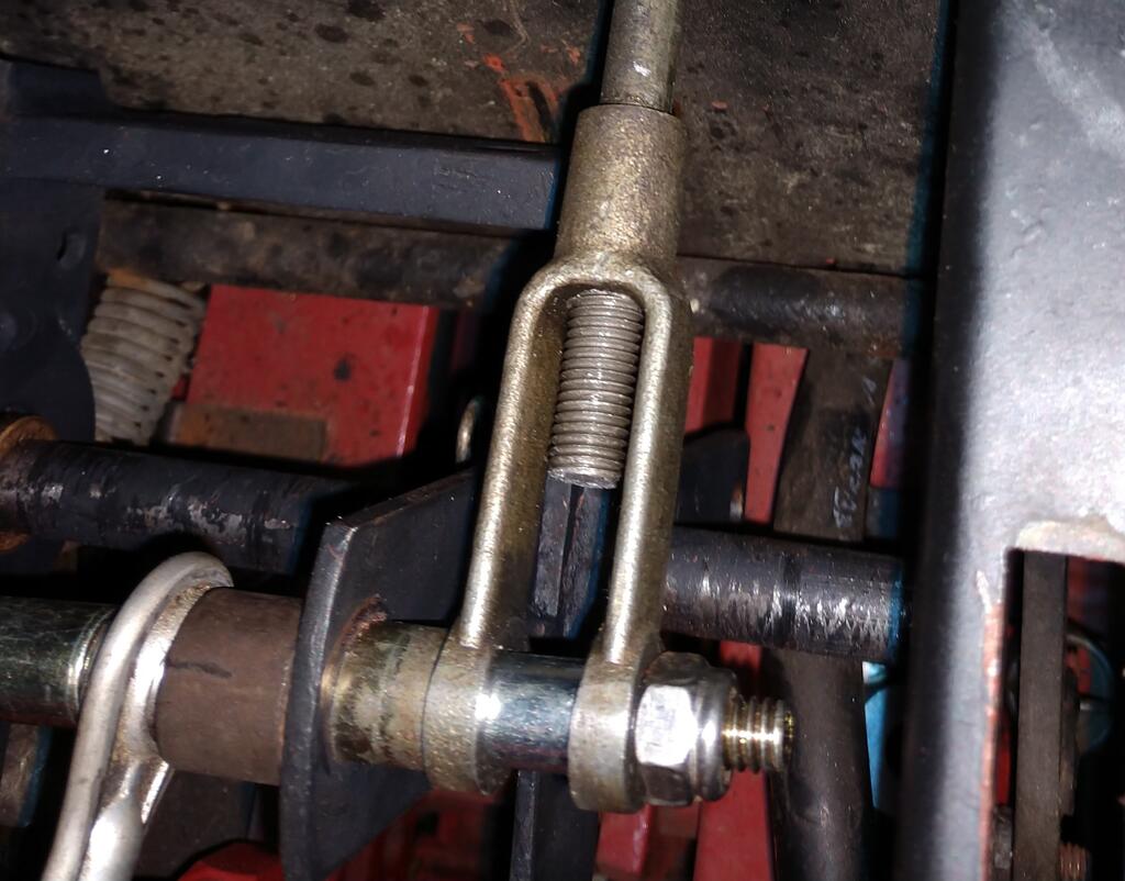

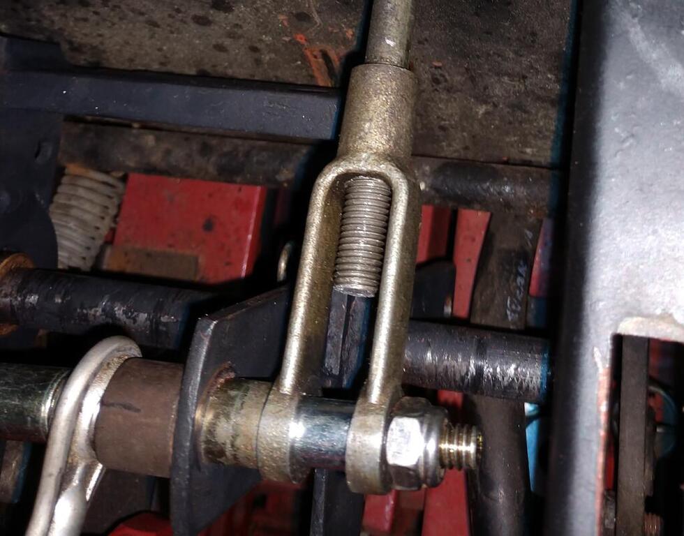

kpinnc 14,548 #94 Posted September 29, 2021 (edited) I had to make an adapter to fit this seat to the Wheel Horse springs. Nothing fancy, but it's one more thing completed. I like this seat, so it was getting on there one way or the other. Fixed the foot hydro link thingy. Hopefully my steekers will be here this week (absolutely NO rush Terry!), so I'm hopeful I'll get this one off the lift in the next two weeks! Edited September 29, 2021 by kpinnc 4 Share this post Link to post Share on other sites
Bill D 2,246 #95 Posted September 29, 2021 31 minutes ago, kpinnc said: I had to make an adapter to fit this seat to the Wheel Horse springs. Nothing fancy, but it's one more thing completed. I like this seat, so it was getting on there one way or the other. Fixed the foot hydro link thingy. Hopefully my steekers will be here this week (absolutely NO rush Terry!), so I'm hopeful I'll get this one off the lift in the next two weeks! I like the seat. Why the clevis instead of a Heim joint? Share this post Link to post Share on other sites
kpinnc 14,548 #96 Posted September 29, 2021 (edited) 14 hours ago, Bill D said: I like the seat. Why the clevis instead of a Heim joint? Short answer: I had the clevis and didn't have another Heim. It's hard to see, but that is a 1/4 to 3/8 bushing inside the clevis. It moves freely in rotation, but has no play. I have the only other Heim I had left on the other end of the link, as well as the lower link to the pedal. I'll pick one up sometime, but it's good enough for now. Edited September 29, 2021 by kpinnc 2 1 Share this post Link to post Share on other sites

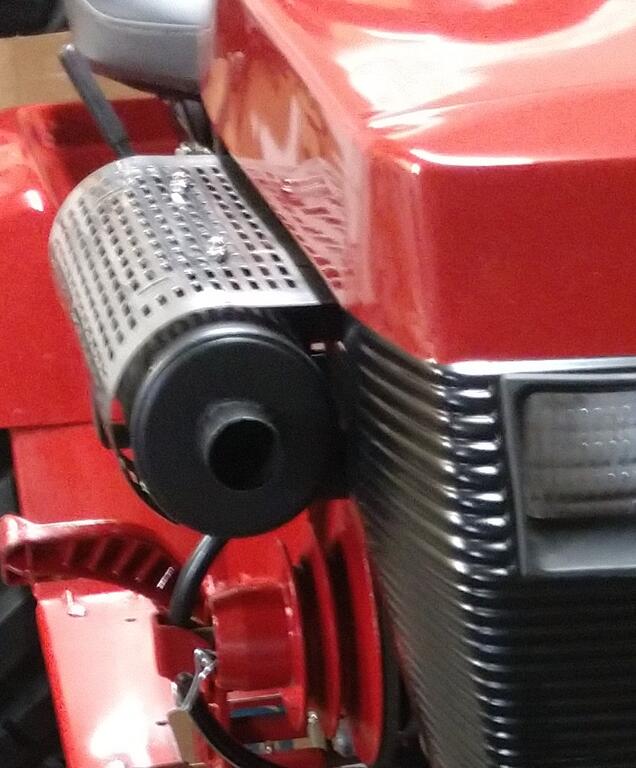

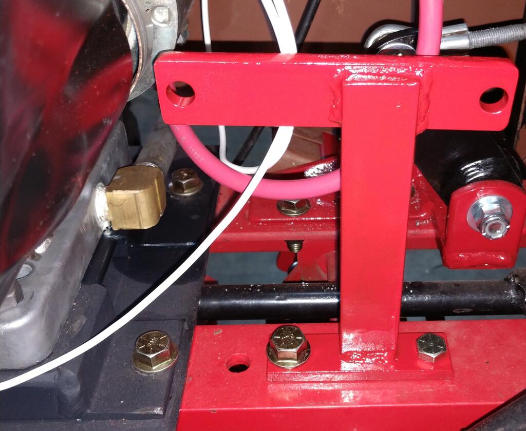

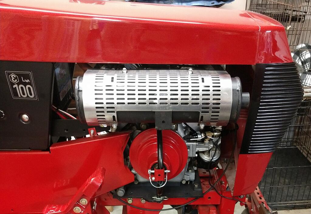

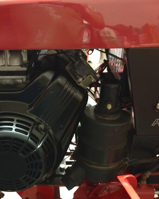

kpinnc 14,548 #97 Posted October 1, 2021 (edited) Today I extended the muffler 2.5 inches and added the 520 style guard. It's about an inch longer than a 520 muffler, but I think it looks good on there. Turned out surprisingly well. I also added a bracket to mount the Donaldson filter housing. Kind of an odd spot, but everything clears and the hose routing will be simple. I'll relocate the fuel pump later. Edited October 1, 2021 by kpinnc 1 Share this post Link to post Share on other sites
kpinnc 14,548 #98 Posted October 1, 2021 (edited) Dunno why I keep getting a pop up for pic size. I'll just add replies until they are all up. Edited October 1, 2021 by kpinnc 1 1 Share this post Link to post Share on other sites
kpinnc 14,548 #99 Posted October 1, 2021 (edited) Filter location is odd, but the pedal clears. Edited October 1, 2021 by kpinnc 1 Share this post Link to post Share on other sites
kpinnc 14,548 #100 Posted October 1, 2021 (edited) Hose routing will be simple. Edited October 1, 2021 by kpinnc 1 1 Share this post Link to post Share on other sites
