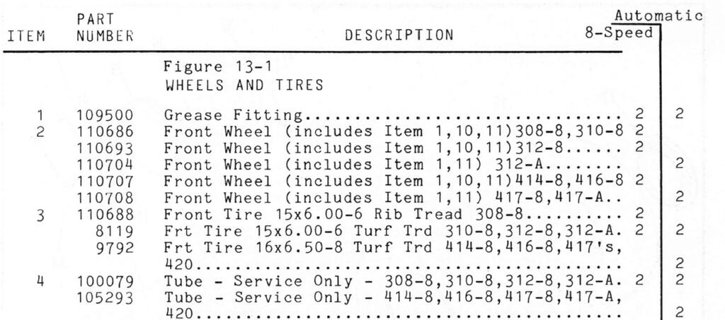

Ivegotahorse 4 #1 Posted May 6, 2021 Okay, so I am in need of a replacement front rim for a 417. Looks like the part number is 110708. What other models used the same rim? Anyone have one they want to sell? Share this post Link to post Share on other sites
Maxwell-8 4,371 #2 Posted May 6, 2021 (edited) Aren't all 8 inch rims from (300-400series) pretty much the same? I think all 300 and 400-series 8" rims should work just fine. Edited May 6, 2021 by Maxwell-8 Share this post Link to post Share on other sites
Ivegotahorse 4 #3 Posted May 6, 2021 I wasn't sure if the rims bearing location stick out was the same. Back spacing? Share this post Link to post Share on other sites
gwest_ca-(File Mod) 12,535 #4 Posted May 6, 2021 110708 has been replaced by 110707 and both only used 1985-86. That is not saying other wheels are not the same dimensions. Just no way to tell using available info. 110674 was also replaced by 110707 but application unkown. #1 is wheel #10 is valve stem #11 is wheel bearing Share this post Link to post Share on other sites
Lee1977 7,809 #5 Posted May 7, 2021 I had one good wheel that came off my 1977 C-120. When I got my 1989 520-H it had a bad front wheel. I replaced it with the one off the C-120 and I can't see any difference between the wheels. 1 Share this post Link to post Share on other sites
