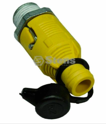

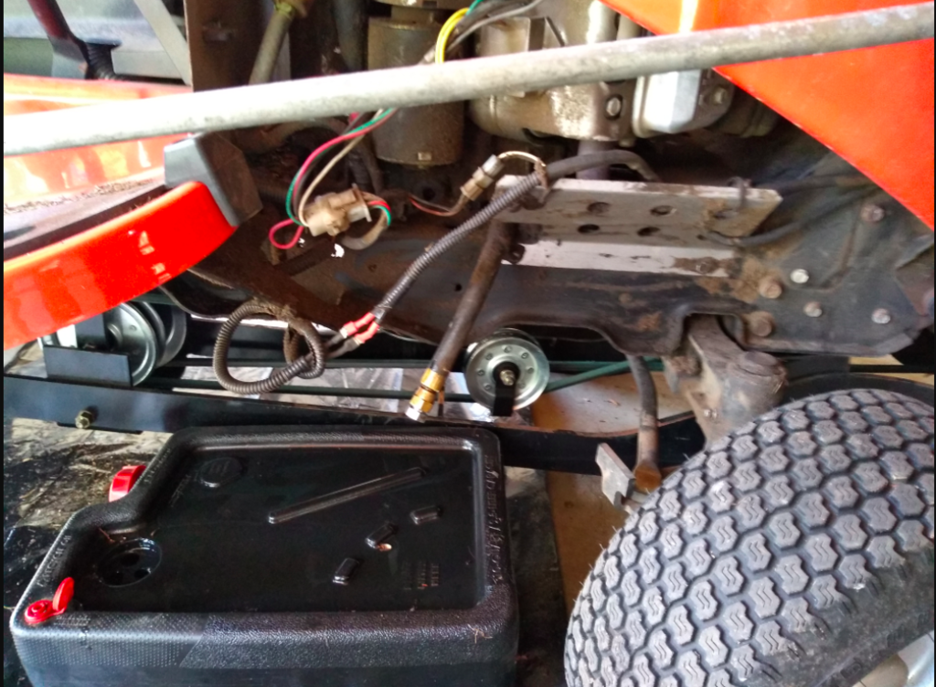

Chestnut 315 #1 Posted May 6, 2021 I have one specific question, then a general comment. Can anyone tell me the type of threads on the engine oil drain cap on the 520-H Onan. I just bought a couple of the Stens 125-508 twist type drain valves and I know I need an adapter. The Onan's have a pipe stub and cap, but they're at my mother in law's and right now I'm not. I think the pipe stub is 3/8 male NPT but I don't want to buy the adapter without knowing. My second question is more a comment and invitation to discussion. I think I counted 12 small engines that I maintain between my house, my mother in law's and the lady next door. It's difficult to avoid making a mess in all but one or two of them. The walk behind snowblower has a drain pipe that clears the frame and the push mower has no accessible drain so I just tip it on its side. Works fine if I remember to run it out of gas first. All but two of the rest have plugs that drain onto the frame unless I use something to direct the oil over the side. A cut up plastic bottle works OK. The Cub Cadet (MTD) rider has the same drain valve as the Stens. Works well with a hose attached. The one I like best is actually on my Simplicity. A short length of reinforced rubber hose with a hydraulic-type tapered fitting and plug. Unlike the Stens it doesn't require another hose to reach the drain pan. Oil filters also make a mess. They're all horizontal or inverted. I don't have time to do the remote filter conversion on the 520-H's this year but it's on my agenda. Does anyone have tips to prevent spillage? Does anyone puncture the inverted filters to let them drain with the rest of the oil? I never have but I'm thinking about next time. Share this post Link to post Share on other sites

Chestnut 315 #7 Posted May 6, 2021 42 minutes ago, ebinmaine said: I can't answer for your specific tractors but I've been known to take something like a long thin tube of plastic and cut it in half. Forms a channel. Aluminum foil works particularly well for this especially if it's the heavy duty kind. Thanks, I've cut the corner off milk or cider bottles, even the random tall soda or beer can. Never did a Moxie can though. Always creates another item to dispose of. 38 minutes ago, stevasaurus said: Puncturing a hole in the filter to drain before replacement is a popular way to do that...if you can get something under it to catch the oil. I was thinking of doing it on the engine so it would drain into the sump and come out with the rest of the oil. A little concerned about too much impact on the filter mount. 19 minutes ago, lynnmor said: Your Onan has 3/8" NPT threads. I just remove the filter, tilt it up and the mess isn't too bad. Easier done without the mower deck on so a large pan can be used. The shroud has sheet metal that directs the oil to the outside and it only needs wiped out before installing the filter. Out to the store to get a coupling. The Jungle store couldn't get it to Maine until the 12th and I want to get them changed this weekend. Avoid a trip to the store when I'm there. I don't have the mower deck on either. Getting to the age when changing implements will be a thing of the past. The 60" deck is a bit overkill for my lawn. Probably leave the snowblower on the 520H and use the 52" Simplicity. The other 520H has the FEL. 6 minutes ago, roadapples said: I use a "Form-A-Funnel". Picked one up at a show for about 10 bucks. You'll have to do some searching though. They are pricey.... I'll be on the lookout. They do look interesting. Share this post Link to post Share on other sites

Jeff-C175 7,211 #10 Posted May 7, 2021 This is probably a "Drainzit". https://www.drainzit.com/ Share this post Link to post Share on other sites
Chestnut 315 #11 Posted May 7, 2021 8 hours ago, Jeff-C175 said: This is probably a "Drainzit". https://www.drainzit.com/ Sure looks like it. Thanks. Tucks right in behind one of the wires when not in use. I may buy a couple for use on the tractors and reuse the Stens valves on the pressure washer, generator, chipper, etc. In the meantime I bought the couplings to put the Stens valves on the Onans this weekend. 1 Share this post Link to post Share on other sites

Chestnut 315 #14 Posted May 10, 2021 On 5/6/2021 at 12:49 PM, lynnmor said: Your Onan has 3/8" NPT threads. I just remove the filter, tilt it up and the mess isn't too bad. The shroud has sheet metal that directs the oil to the outside and it only needs wiped out before installing the filter. I got to change the oil on both of them this weekend. You are correct that the mess wasn't too bad. I ran into a couple of issues. Neither tractor had a mower deck, but the support pillar for the FEL was a bit in the way. I decided not to install the Stens valve. I'll hold them for the pressure washer and generator. Share this post Link to post Share on other sites
