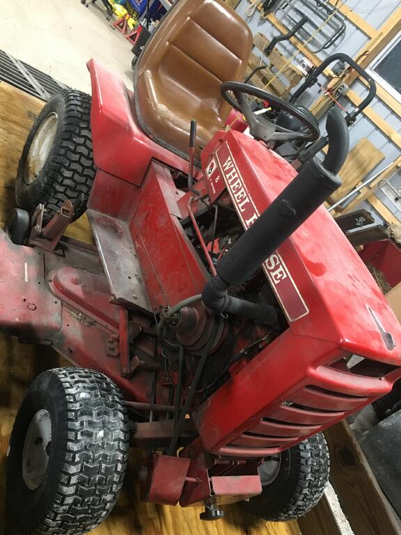

dooley1337 11 #1 Posted May 5, 2021 I have a 1973 (no name) 8HP 4 speed. I was wondering what snow plow models fit it (if any)? thanks Share this post Link to post Share on other sites

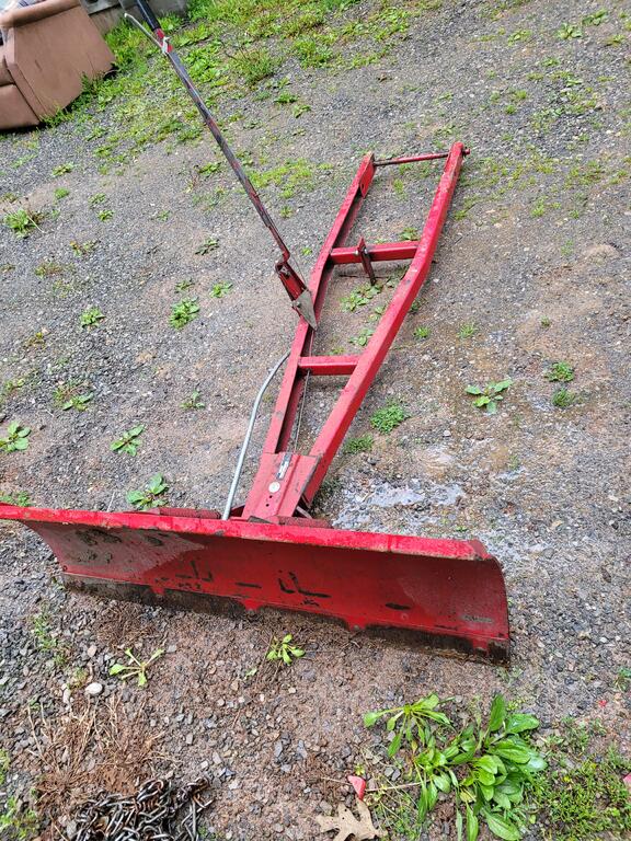

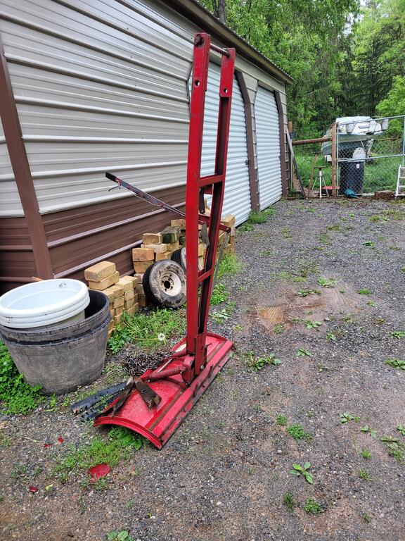

Wheel Horse 3D 3,821 #9 Posted May 7, 2021 (edited) I've got the blade that came with Dug( C141 Auto), and since I'm gettin' the FEL I don't see me using it. I'm not sure exactly what it's worth but would be willing to part with it. Should have pics here shortly. Edited May 7, 2021 by Wheel Horse 3D 1 Share this post Link to post Share on other sites
dooley1337 11 #10 Posted May 7, 2021 Just the blade or the blade and the mounts? Share this post Link to post Share on other sites

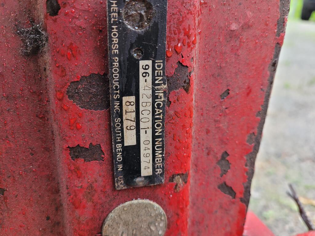

Wheel Horse 3D 3,821 #11 Posted May 7, 2021 1 minute ago, dooley1337 said: Just the blade or the blade and the mounts? Its the complete setup. I don't recall right off if its a 42 or a 48. and if it has the 3 position or 5 position angle. Once Mrs. Sends me some pics I can narrow it down to specifics for ya. But this attaches into your attach-a-matic mounts, and to your deck height lever. Should mount right up and be good to go. 1 Share this post Link to post Share on other sites
Wheel Horse 3D 3,821 #13 Posted May 7, 2021 1979 42" with the 3 position pivot. The pivot control rod needs straightened a little and some new cotter pins. Share this post Link to post Share on other sites
