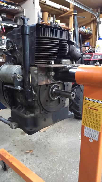

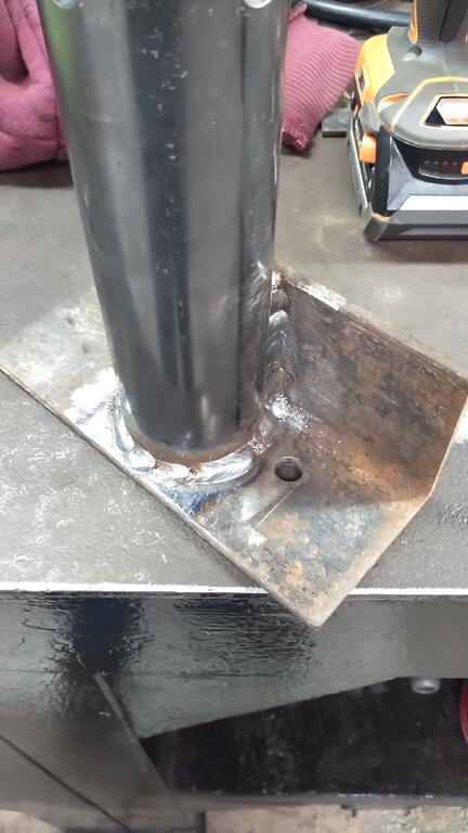

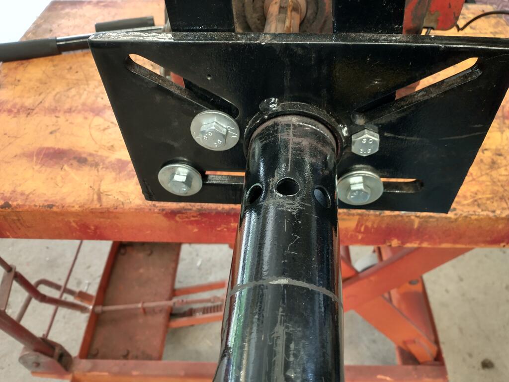

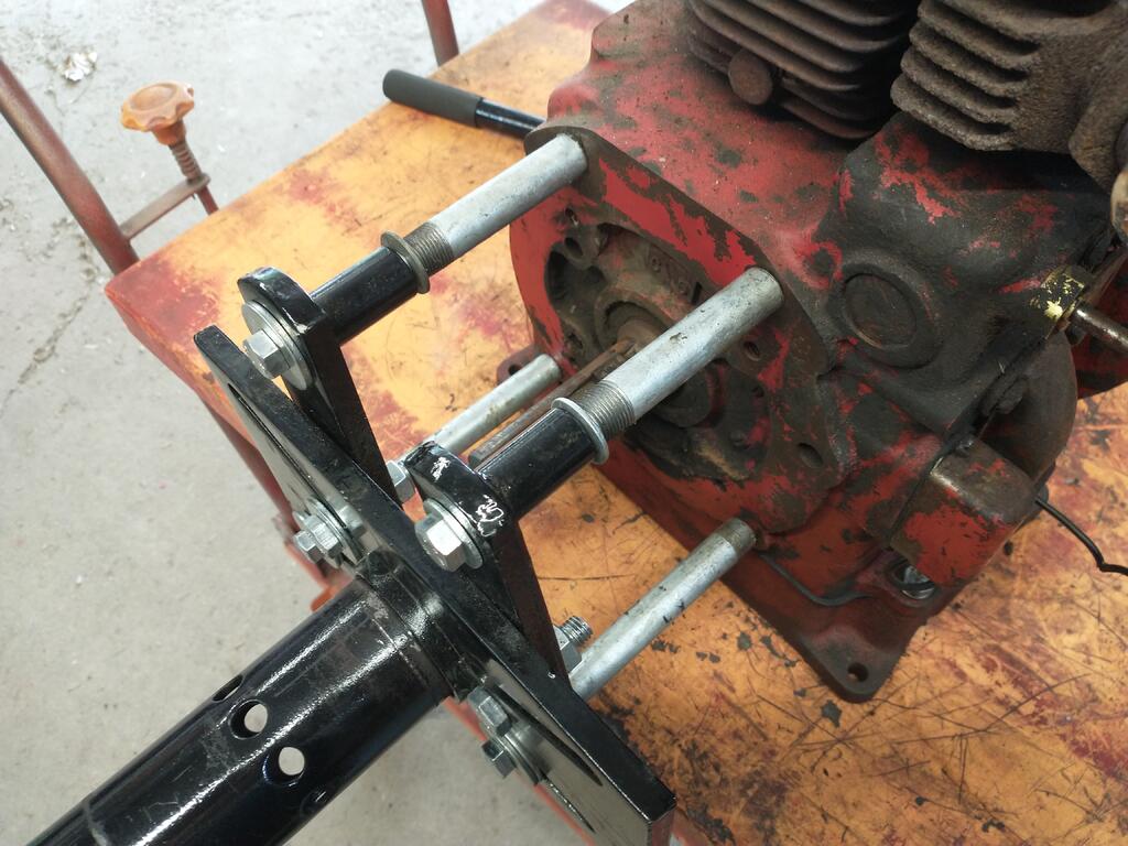

squonk 47,422 #30 Posted May 8, 2021 On 5/5/2021 at 8:01 AM, ebinmaine said: That's the one piece of the puzzle I don't have here and I wouldn't mind having an engine OFF of the rolling table. What did you have to do to the engine stand specifically? Pics of the engine stand mount. 3 1 Share this post Link to post Share on other sites

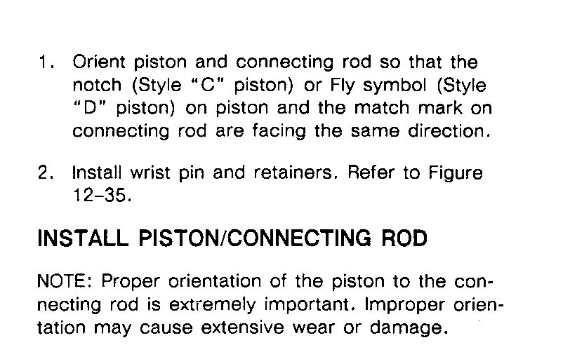

Gregor 4,848 #32 Posted June 9, 2021 So after 35 days I have the block back for my K301. A paragraph in the Kohler manual has me confused, yet again. I find no notch on the connecting rod, or piston, or a fly. I don't see one on the old piston and rod either? HELP? Thanks Greg Share this post Link to post Share on other sites
Bill D 2,997 #33 Posted June 9, 2021 On 5/9/2021 at 6:26 AM, ebinmaine said: Thanks! Here is a picture of my engine stand mount 1 1 Share this post Link to post Share on other sites
pfrederi 20,891 #34 Posted June 9, 2021 On after market pistons they sometimes do not have the notch or FLY. The stamping for oversize amount goes to the flywheel. side 1 1 Share this post Link to post Share on other sites
