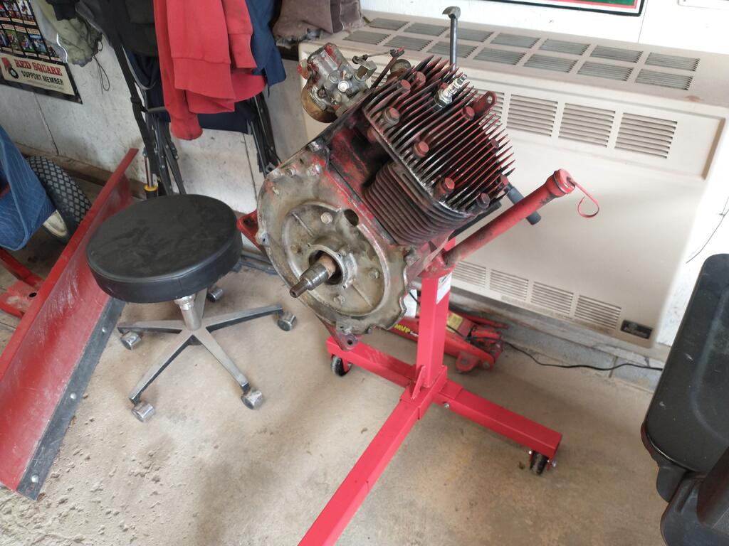

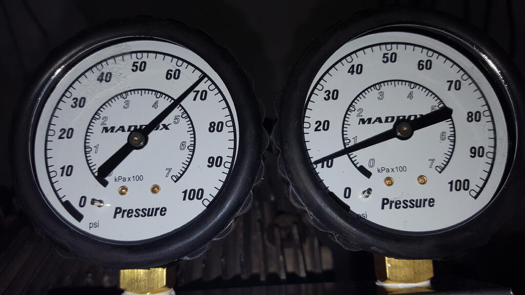

Gregor 4,848 #1 Posted May 5, 2021 (edited) I have read about cylinder leak down tests, but have never seen it done. I watched a video, and that confused me more than it taught me. I got a tester, read the instructions word for word, and went to it. I found my TDC, and turned on the air. I could hear a LOT of air coming out of the muffler. I must be doing something wrong. I took the valve cover off, which is more work than you might think on a 321. I checked for clearance from the exhaust valve to tappet, ~ .015. Clearance on the intake valve, ~ .005. I don't know what spec is, but irregardless there is clearance. Hooked my tester up again. Still a LOT of air coming from the muffler. The dial on the left shows how much air I am putting into the cylinder. The dial on the right shows how much air is staying in the cylinder. That's not good. At least a valve job is in order. Tomorrow I will get my bore gauges out and check the cylinder. Sorry.. It's a K301. 12 HP Edited May 5, 2021 by Gregor Share this post Link to post Share on other sites
pfrederi 21,181 #2 Posted May 5, 2021 Exhaust valve is burned and leaks...ACR has failed and is keeping it open??? 1 1 Share this post Link to post Share on other sites
Achto 32,795 #3 Posted May 5, 2021 At low RPMs or not running the ACR should keep the exhaust valve palatially open at TDC. This is why a compression test is inconclusive on a Kohler K model. A leak down test can be preformed but the piston can not be at TDC. 2 1 Share this post Link to post Share on other sites

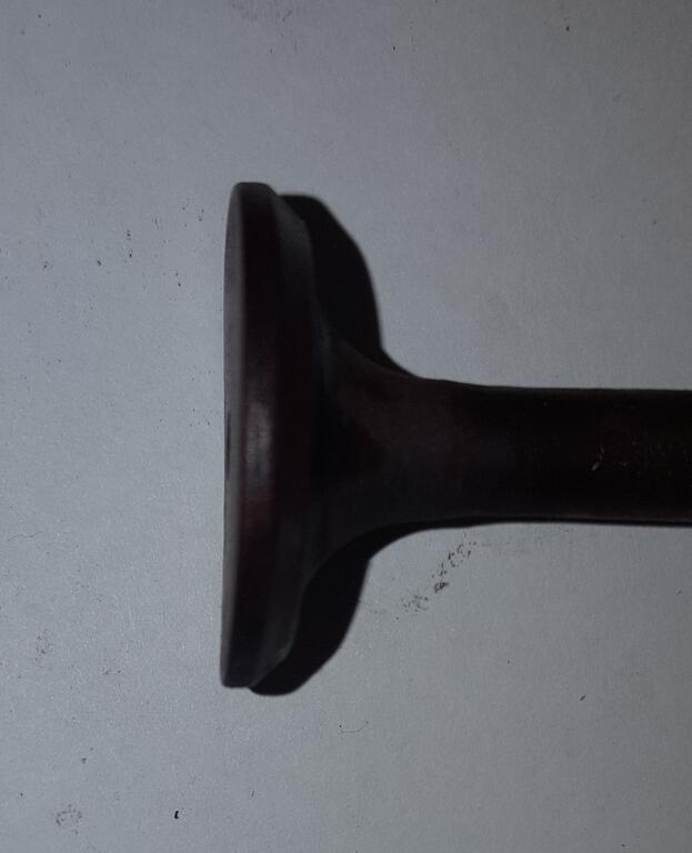

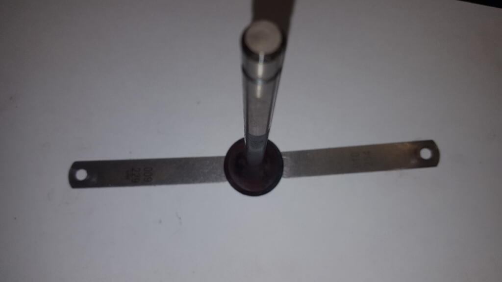

Gregor 4,848 #4 Posted May 5, 2021 25 minutes ago, pfrederi said: ACR has failed and is keeping it open??? I mentioned I had .015 clearance on my tappet. exhaust valve had to be closed. But, curiosity got the better of me. I had to pull the exhaust valve. I expected to see it badly burnt, or even a chunk missiing, but there wasn't. At first glance, it didn't look that bad. Then I looked closer. The valve is warped. I know you can't tell it in the pic, but there is a .010 feeler gauge under one side, and a .009 feeler gauge on the other side. The middle is firmly touch the paper on this marble tile. It's very obvious when you look at it close.A while back there was a discussion about what harm can be done, by running a motor with no muffler. Someone mentioned a warped valve as a possible result. I questioned that at the time. I may have to re-think that theory. 1 Share this post Link to post Share on other sites
Gregor 4,848 #5 Posted May 5, 2021 I think you can actually see it in this pic. 2 1 Share this post Link to post Share on other sites

ebinmaine 80,765 #7 Posted May 5, 2021 7 hours ago, Gregor said: see it in this pic WOW Share this post Link to post Share on other sites

Gregor 4,848 #9 Posted May 5, 2021 I was going to do a valve job on this motor, and let it go at that. Then I checked the cylinder bore. Max is 3.378. Mine is 3.381. Of course as always, these are not Starett gauges. I decided to do a complete rebuild, and remove the balance gears. I've never done a big block. This will probably have to be done on the floor, as there is no way I can get it on my work bench. P.S. If someone could change the title of this thread to "The K-301 build" I would appreciate it. 1 Share this post Link to post Share on other sites

953 nut 69,555 #14 Posted May 5, 2021 35 minutes ago, Gregor said: This will probably have to be done on the floor, as there is no way I can get it on my work bench You may want to buy a lift table, it is a real back saver and can double as a work area. https://www.harborfreight.com/500-lbs-capacity-hydraulic-table-cart-61405.html 1 1 1 Share this post Link to post Share on other sites
ebinmaine 80,765 #15 Posted May 5, 2021 1 minute ago, Gregor said: Not really I have an electric hoist in the middle of the garage, but that doesn't do much good. Maybe a small roll around table that's the same height as your workbench? Lift engine to table. Roll table to workbench. Slide engine to workbench. Tell the commandant it's for arts and crafts usage of the household but always conveniently have something on top of it so it can't be incongruously commandeered. 1 Share this post Link to post Share on other sites

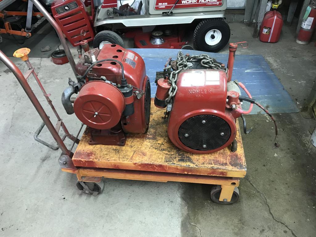

squonk 48,157 #16 Posted May 5, 2021 I have a 1/2 ton Harbor Fright chain hoist to lift Kohlers off of tractors on to my Harbor Fright lift table. The table can lift 2 thumpers at once. I have also modified a Harbor Fright engine stand to hold 1. 4 Share this post Link to post Share on other sites
ebinmaine 80,765 #17 Posted May 5, 2021 10 minutes ago, squonk said: modified a Harbor Fright engine stand That's the one piece of the puzzle I don't have here and I wouldn't mind having an engine OFF of the rolling table. What did you have to do to the engine stand specifically? Share this post Link to post Share on other sites
squonk 48,157 #18 Posted May 5, 2021 21 minutes ago, ebinmaine said: That's the one piece of the puzzle I don't have here and I wouldn't mind having an engine OFF of the rolling table. What did you have to do to the engine stand specifically? Had to drill a couple of 7/16" holes in the plate and get some 7/16" x 6 1/2 bolts with some pipe nipples. I have another thumper to tear into so I can take a pic. a lot of guys use just the 2 starter holes but I like the extra security of 4 bolts. 1 Share this post Link to post Share on other sites
Gregor 4,848 #19 Posted May 5, 2021 16 minutes ago, squonk said: but I like the extra security of 4 bolts. So would I ! Share this post Link to post Share on other sites

MikMacMike 494 #24 Posted May 5, 2021 2 hours ago, squonk said: I have a 1/2 ton Harbor Fright chain hoist to lift Kohlers off of tractors on to my Harbor Fright lift table. The table can lift 2 thumpers at once. I have also modified a Harbor Fright engine stand to hold 1. Ahhhhhhhhh Ive got 2 engine stands that Ive used for all the car engines, and after all these years Squonk I never thought of doing what you did there, You smarty pants hahahaha. rest assured my next K plant will be married to my stand next time. Wicked. Share this post Link to post Share on other sites
