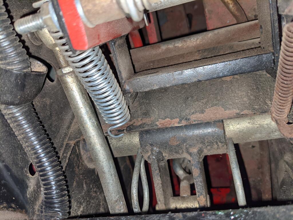

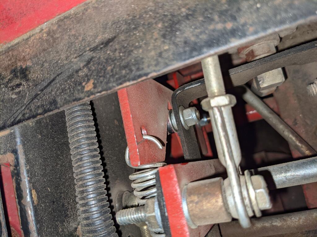

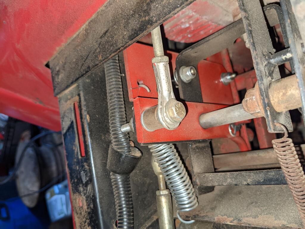

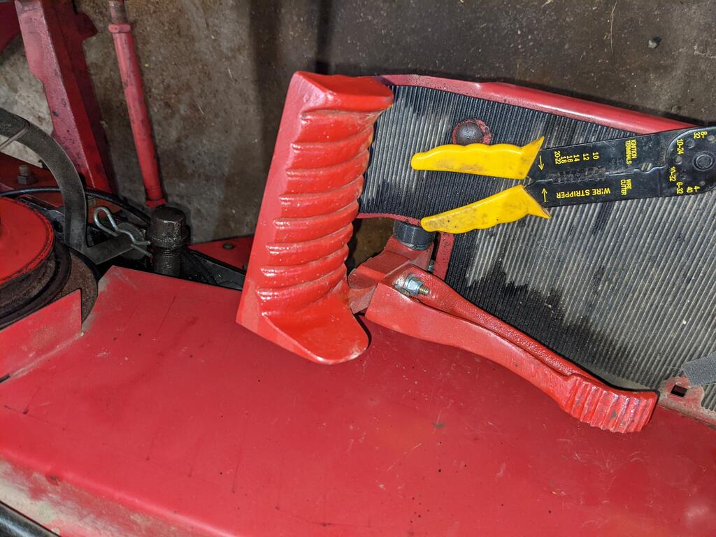

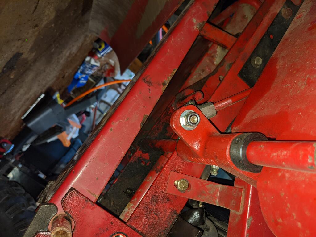

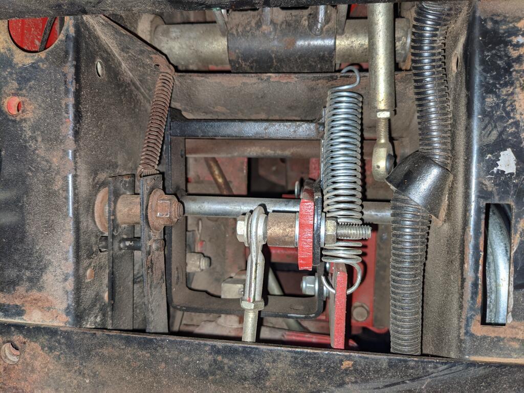

seuadr 489 #6 Posted May 6, 2021 i have matt's kit, i'll get you some pictures this morning. if you don't see them by 1, shoot me a PM, i forgot. Share this post Link to post Share on other sites

seuadr 489 #8 Posted May 6, 2021 (edited) @ebinmaine Edited May 6, 2021 by seuadr 1 Share this post Link to post Share on other sites

seuadr 489 #10 Posted May 6, 2021 31 minutes ago, ljfarraher said: That's the kit I tried getting.. couldn't get Matt to talk..assuming he's not doing it anymore.. Yeah, i dunno - i got this kit ftom him a couple years ago Share this post Link to post Share on other sites
