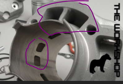

Maxwell-8 4,371 #11 Posted May 5, 2021 (edited) 4 hours ago, Snoopy11 said: This... might be the dumbest question I have ever asked in my life... but I have heard of people converting their 4 stroke engines to 2 stroke. Anybody heard of this? Don I think a buid tilitson is a better option then a 2 stroke. converting a 4 stroke in to a 2 stroke, it's impossible, you need a different head (simple) but you need a special piston, transfer ports in the cilinder wall. IN a 2 stroke the air/fuel mixture first enters the crankcase, lube everything, the thru the transfer ports in to the combustion chamber. That's why you often see an a 2 stroke, the carb hanging pretty low. Edited May 5, 2021 by Maxwell-8 Share this post Link to post Share on other sites
