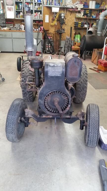

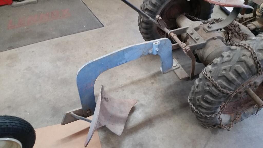

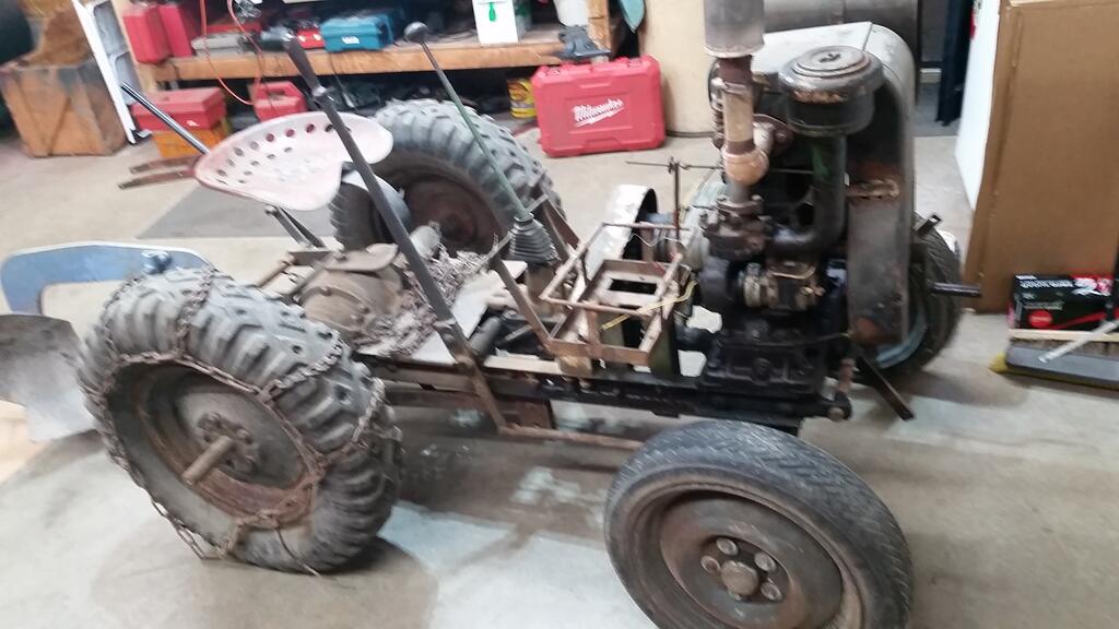

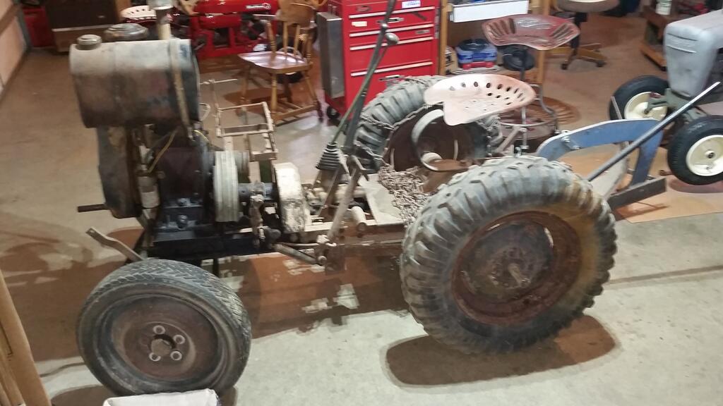

WHX?? 57,572 #1 Posted May 4, 2021 Or so @Achto says it's a Model G. I wouldn't know nothin about a Gibson other than a very cool tractor. Came home from work and this one was sitting in my garage. My bro from a different Mo (sorry Kev I have others) had this in his barn for decades and since he is selling his property to get ready to move he GAVE it to me. I always knew it was there but figured his boy was gonna take it. Turns out I got more room... not ... but gotta give him dibs I ever don't want it. Plow was a real bonus. She's a project and Dan doesn't know it yet that he is gonna come help me get it running and school me since him and his bros have one. Some PO put a coil and makeshift battery box on it and have the magneto hot wires so you guys will have to school me on that too. Nuttin like two odd balls in the herd.... may have to have a fire sale to make room .... 1 12 Share this post Link to post Share on other sites

WHX?? 57,572 #3 Posted May 4, 2021 Rims Jim right off the bat I noticed the clorided rears and if you check care full the fronts are actually spare temp tires off Lord knows where . ... Dan just told me correct would be something off a Farm all. Share this post Link to post Share on other sites
Achto 32,140 #4 Posted May 4, 2021 (edited) She looks pretty cool Jim!!! It's a model D not model G might wanna change that on your heading. I'm not sure why they had a battery on it. That magneto should not need a battery. The front rims should be the same as what is on a Farmall Cub. Those donuts on the front are definitely not right. The 16's on the back look correct, same tires as ours has too. Looks like a fun project though, can't wait to tear into it with you. Edited May 4, 2021 by Achto 3 1 Share this post Link to post Share on other sites

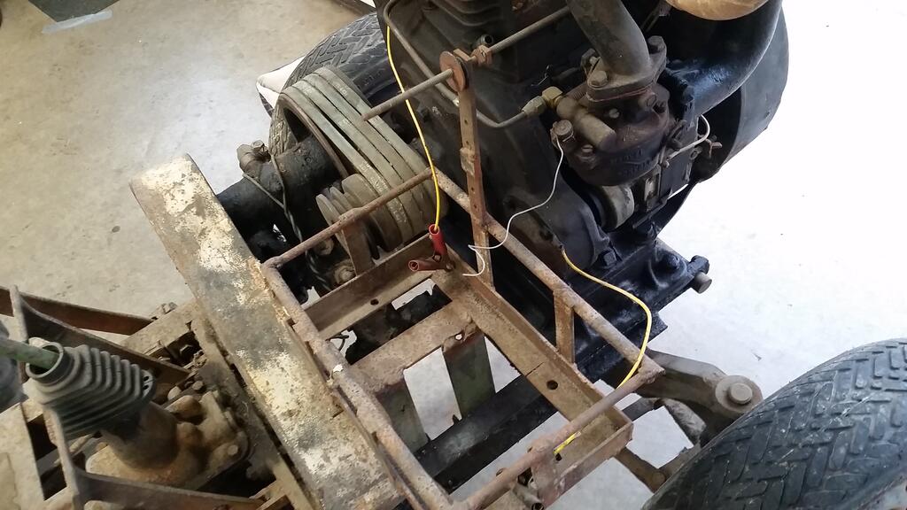

squonk 47,509 #15 Posted May 4, 2021 11 hours ago, WHX24 said: She's a project and Dan doesn't know it yet that he is gonna come help me get it running I'm sure you will be able to handle the shifter boot. Let Dan take care of the rest! 5 Share this post Link to post Share on other sites
squonk 47,509 #16 Posted May 4, 2021 Boy Dan works FAST!! 5 Share this post Link to post Share on other sites

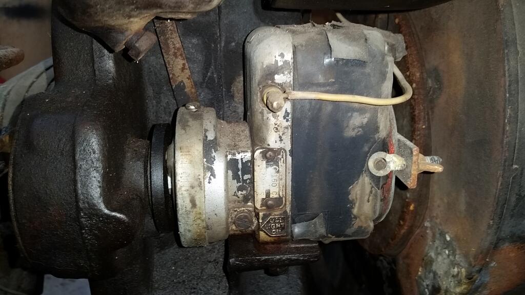

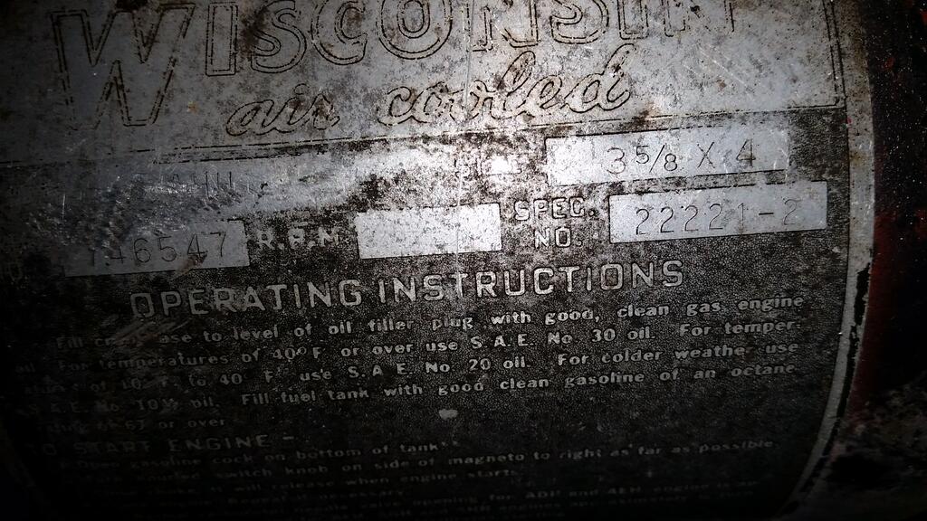

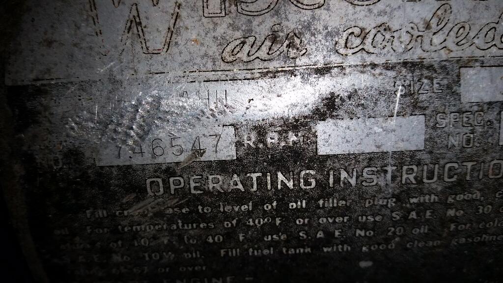

WHX?? 57,572 #17 Posted May 4, 2021 (edited) Hard to make out the engine numbers. Think I see AHH The magneto Edited May 4, 2021 by WHX24 4 1 Share this post Link to post Share on other sites
Achto 32,140 #18 Posted May 4, 2021 7 minutes ago, WHX24 said: Think I see AHH That's what I read also. 9.2HP largest single cylinder that Wisconsin made. 2 1 Share this post Link to post Share on other sites

WHX?? 57,572 #20 Posted May 4, 2021 (edited) 15 minutes ago, Achto said: That's what I read also. 9.2HP largest single cylinder that Wisconsin made. Is this the same motor on yours then Dan, Guessing this a '48 or '49? Interesting learning about these tractors. The first production tractor was a model 'A' which, along with the latter models 'D', 'SD' , and Super D, was powered with a six horsepower Wisconsin air cooled model AEH engine (some early 'Ds' had a nine HP AHH engine). Edited May 4, 2021 by WHX24 1 Share this post Link to post Share on other sites
Achto 32,140 #21 Posted May 4, 2021 4 minutes ago, WHX24 said: Is this the same motor on yours then Dan I believe that is the same engine that is on ours. I would have to look to be sure. Share this post Link to post Share on other sites

WHX?? 57,572 #24 Posted May 5, 2021 After some more time with her and research it appears that there is a Wico mag base mount on it @Stepney. A closeup of the tag says C 150 C. Looks like a PO had problems with it and wired a battery to the kill terminal through a coil. Was this a farmer fix? Since I have limited to no experience with mags thoughts are to yank it and send it to a experienced rebuilder. I gotta ditch the homemade battery box it's just out of place and hokey. 2 Share this post Link to post Share on other sites
Stepney 2,356 #25 Posted May 5, 2021 18 minutes ago, WHX24 said: send it to a experienced rebuilder. That's the way to do it.. they could often due with having the magnets recharged anyway. Good for another 50 years if maintained properly. Oftentimes they simply weren't.. Have several mags here from the 1920's that still have original condensers to boot.. 1 1 Share this post Link to post Share on other sites
