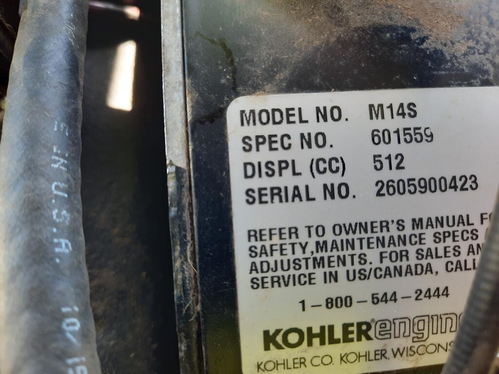

Ff717 1 #1 Posted May 3, 2021 Hi guys ,have cleaned the screen in the tank shutoff, all new fuel line from tank to carb with new inline filter, cleaned fuel bowl, new coil(ignition module),new plug and still have my miss. Will attach engine numbers all input would be appreciated. Thanks. Share this post Link to post Share on other sites
