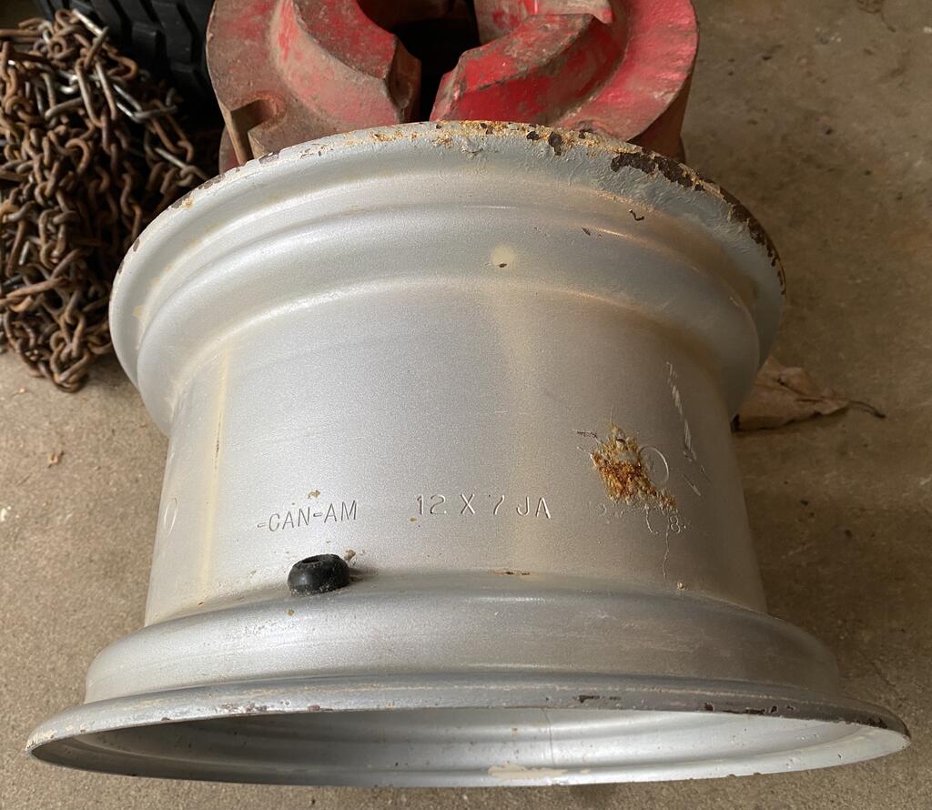

OutdoorEnvy 1,810 #1 Posted May 3, 2021 Anyone know the offset for rims marked 12x7ja? A pair are for sale here at a decent price but I can't find anything on google that lists the offset. Seller thinks it's a John Deere part number but I couldn't verify that. Pics look like the offset is in the ballpark so was curious if anyone has a pair or knows the offset. I'm wanting to run 23x9.5-12 tires and realized my 312-8 has the 12x5 rims. So looking to find a pair of 12x7's. Share this post Link to post Share on other sites

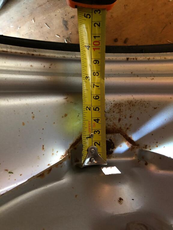

littleredrider 409 #2 Posted May 3, 2021 I have a pair of 7s I can get an accurate measurement, but thinking they are around 1 1/2 or so. Share this post Link to post Share on other sites

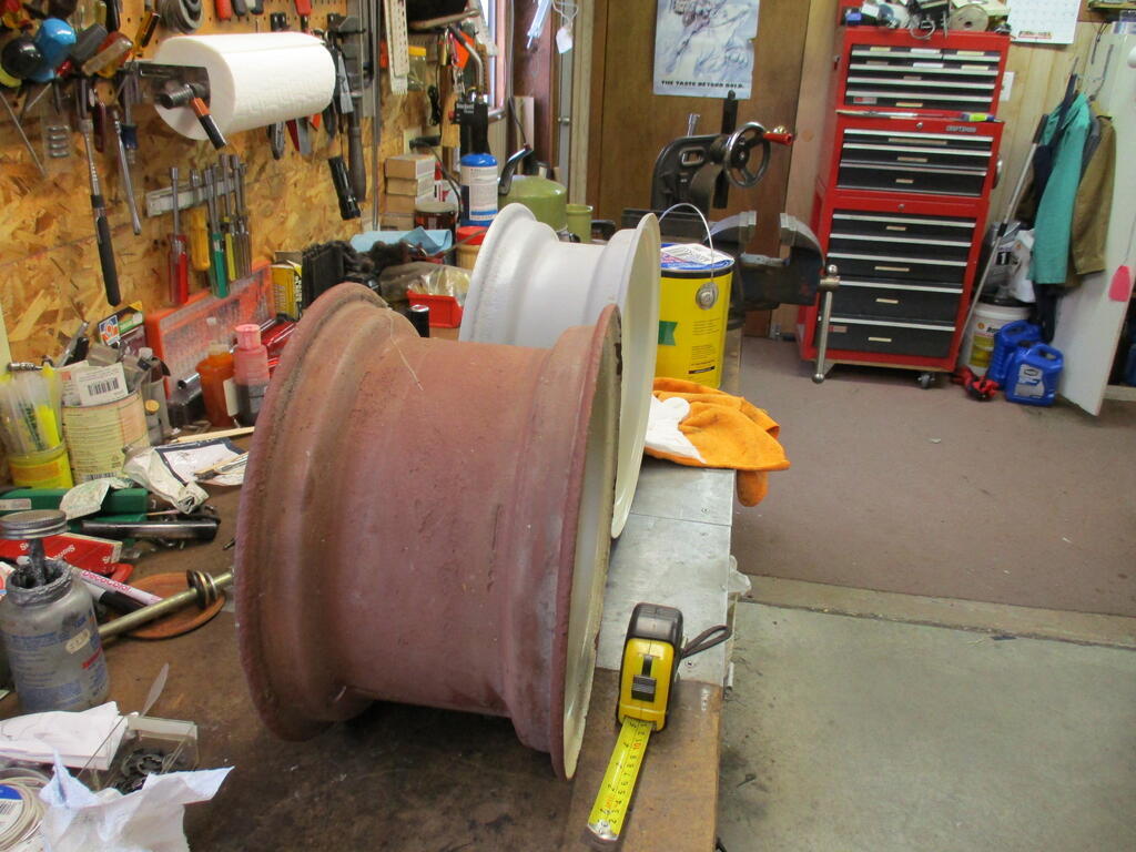

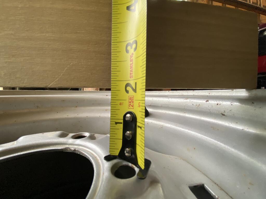

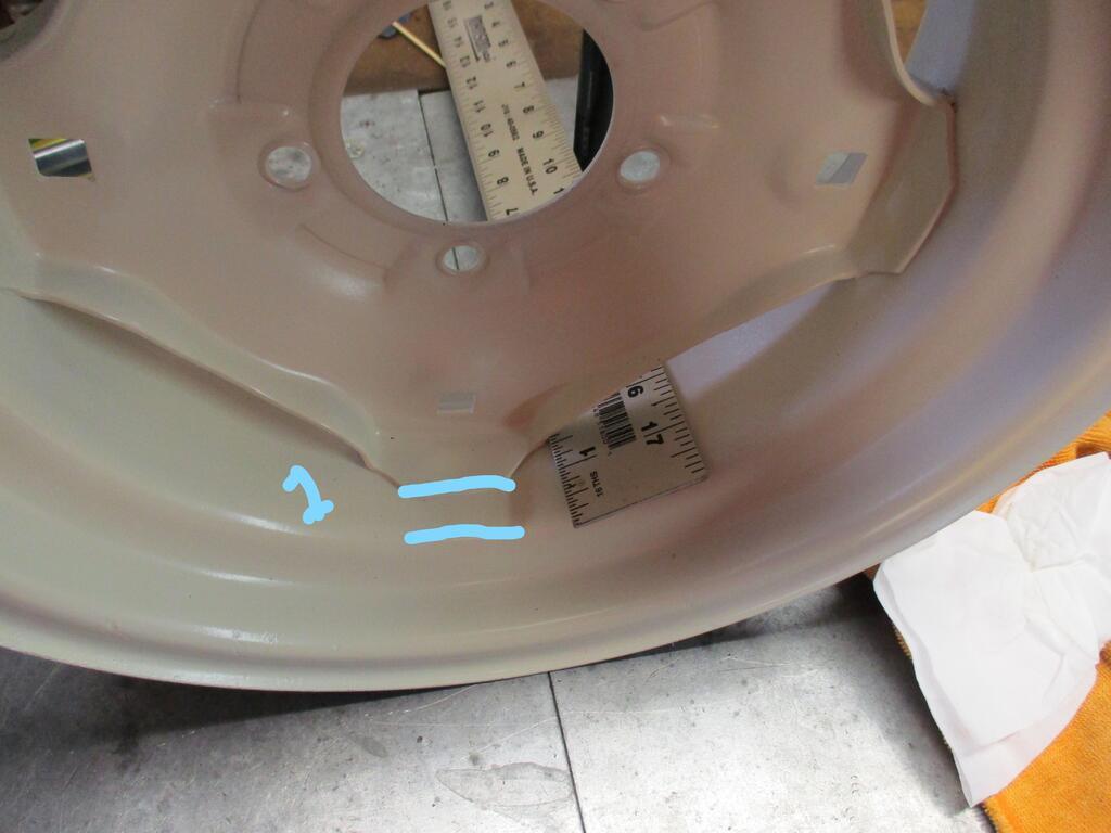

973Chuck 11 #7 Posted May 3, 2021 (edited) These are photos of 12 x 7 rims that came off of a 312-8. 1st photo: 12 x 7 JA 2nd photo: ~1 3/4” backspace 3rd photo: 0419725 stamp on backside Edited May 3, 2021 by 973Chuck Incorrect measurement 1 Share this post Link to post Share on other sites
973Chuck 11 #8 Posted May 3, 2021 Correction for 2nd photo: ~ 1 3/4 backspace - sorry about that. Share this post Link to post Share on other sites

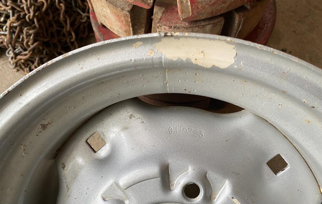

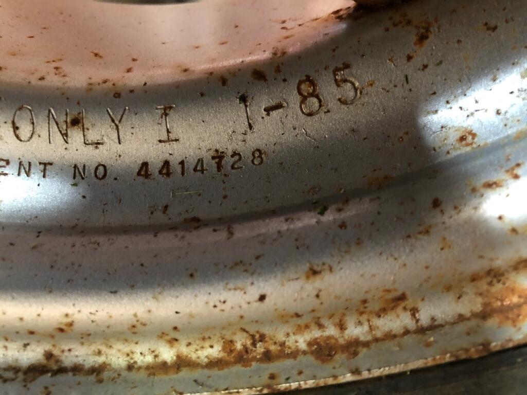

OutdoorEnvy 1,810 #9 Posted May 3, 2021 Measuring them they look like they are 6 inches at their widest width. Here is a pic of a number on the inside of the rim and the measurement is on the outside of the rim. Tires on them are 22x7.5-12. Is there a 6" wide rim? And if so would that run 9.5" wide tires? Share this post Link to post Share on other sites
pfrederi 20,626 #10 Posted May 3, 2021 (edited) 2 hours ago, Jeff-C175 said: I didn't think 5" rims are even a 'thing' ! What size tires are on the 'alleged' 5" rims? Yes there are 5" rims compared to 7 inch My 310-8 with he 22-7.5 had them ...original I am not sure but...they fit Edited May 3, 2021 by pfrederi Share this post Link to post Share on other sites
Jeff-C175 7,209 #11 Posted May 3, 2021 2 hours ago, OutdoorEnvy said: Is there a 6" wide rim? And if so would that run 9.5" wide tires? I think 6" is too narrow for a 9.5" tire. You'll probably get 'bulging' tread, some call it 'ballooning'. Share this post Link to post Share on other sites
clueless 3,403 #12 Posted May 4, 2021 If your tires are the 22x7.5x12 then your rims a probably the 5 inch. I've just never seen a 312 with the 22x7.5x12 tires on it. I know the 310 and 308 came with the smaller tires but not the 312, but you have what you have. Yes you can put the 9.5 wides on the rim, but like Jeff said they will be ballooning, which mean your not getting anymore actual ground contact the with the 7.5's they just look cooler. Share this post Link to post Share on other sites

OutdoorEnvy 1,810 #14 Posted May 6, 2021 Thanks for the help all. I did get the rims and the offset measured out to about 1.5" so they should work out good. Share this post Link to post Share on other sites
