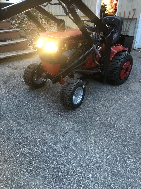

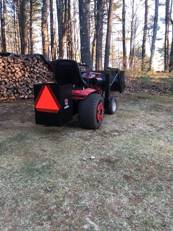

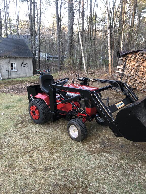

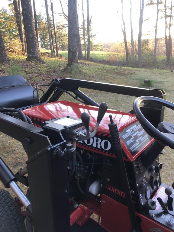

WheelhorseBob 1,550 #1 Posted May 2, 2021 Got the loader mounted and operational. My winter axle swap turned into more of a restoration but it is finally done and ready to start working on my yard. Painting the loader and all parts wasn’t that enjoyable but it came out decent enough. 8 11 3 Share this post Link to post Share on other sites

WheelhorseBob 1,550 #3 Posted May 2, 2021 Gotta love the new led headlights. So much brighter! 4 5 2 Share this post Link to post Share on other sites

Lost Pup 187 #11 Posted May 5, 2021 What size are the rear tires ? Share this post Link to post Share on other sites
WheelhorseBob 1,550 #12 Posted May 5, 2021 1 hour ago, Lost Pup said: What size are the rear tires ? 24x12x12 Carlisle. I needed wider so it was this or dual AGs. These will be easier on my lawn when I need to travel over it and will hopefully add side to side stability. Share this post Link to post Share on other sites
Lost Pup 187 #13 Posted May 5, 2021 2 hours ago, WheelhorseBob said: 24x12x12 Carlisle. I needed wider so it was this or dual AGs. These will be easier on my lawn when I need to travel over it and will hopefully add side to side stability. Was it the stock rims? Tires don’t look like they roll to much. Did you load them? Mine would slide much less on hills once my tires were loaded. Share this post Link to post Share on other sites
WheelhorseBob 1,550 #14 Posted May 6, 2021 8 hours ago, Lost Pup said: Was it the stock rims? Tires don’t look like they roll to much. Did you load them? Mine would slide much less on hills once my tires were loaded. Not yet loaded but I might do that. They are on 520 8.5 wide rims. Share this post Link to post Share on other sites
Lost Pup 187 #15 Posted May 6, 2021 19 minutes ago, WheelhorseBob said: Not yet loaded but I might do that. They are on 520 8.5 wide rims. Thanks 1 Share this post Link to post Share on other sites
seuadr 490 #16 Posted May 6, 2021 11 hours ago, WheelhorseBob said: Not yet loaded but I might do that. They are on 520 8.5 wide rims. for what it is worth, i found that a harbor freight drill and drill powered pump was pretty quick when i loaded mine with RV antifreeze. i think it took less than an hour total, and part of that was figuring out the best way to set everything up since i (foolishly) left the tires on the tractor 1 Share this post Link to post Share on other sites
