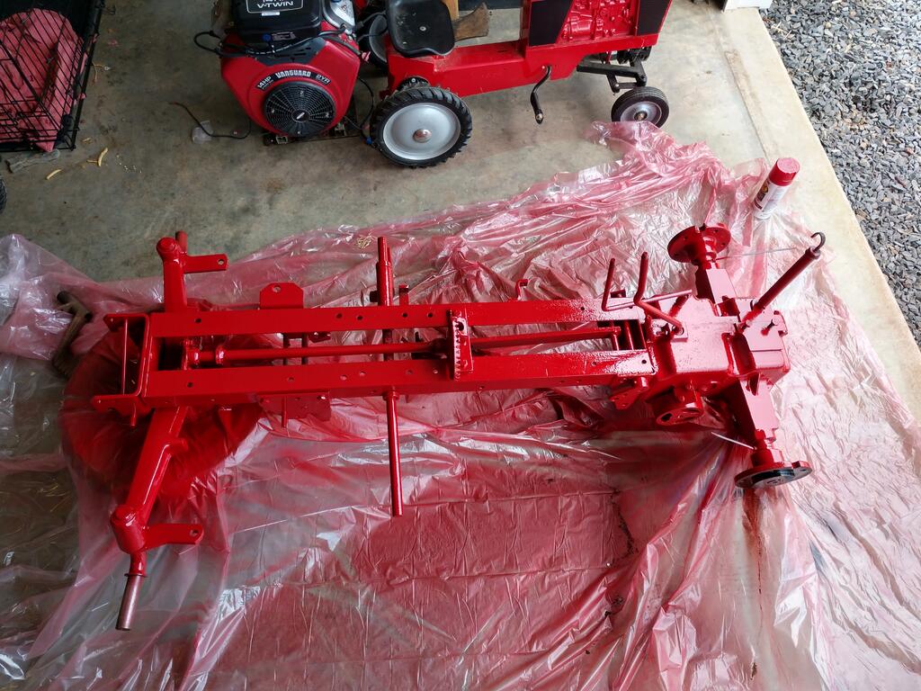

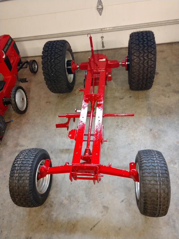

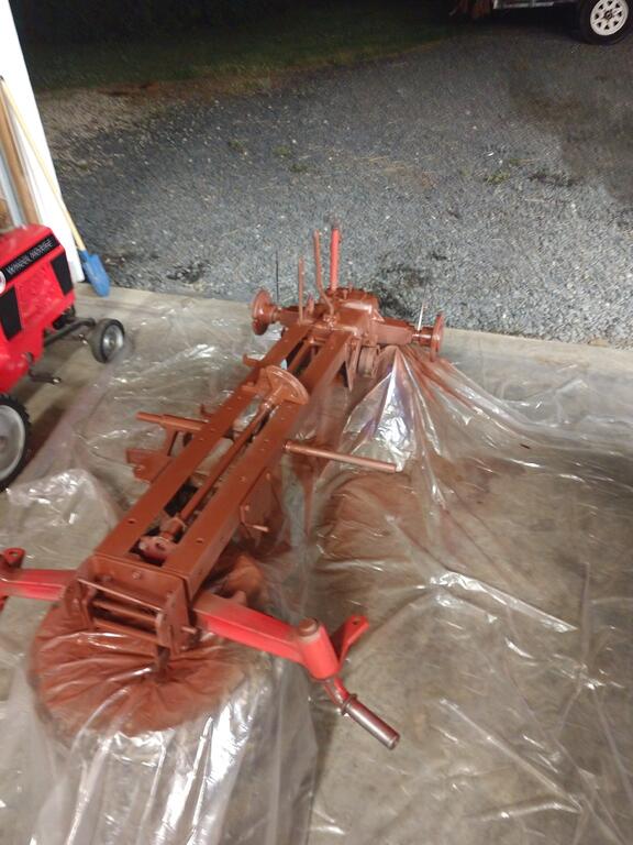

kpinnc 19,036 #1 Posted May 2, 2021 Figured I better start a thread on this one. I'm building two backup mowers. My zero turn isn't a new one, and I have too much grass to let it go for more than a week if something breaks on it. So this tractor will carry the 48, and I've got a 5XX-H that is halfway through a heart transplant that will carry the 60. In a real pinch, I can put the 60 on my 520-H, but I'm a little leary of pushing the Onan that hard. Anyway, here is the weekend's progress: 5 8 Share this post Link to post Share on other sites

kpinnc 19,036 #3 Posted May 2, 2021 I'd like to get a long 1965+ hood for it, but I'm just gonna use what I can find I guess. The frame is a 74, the tranny is a 82, and the front axle and wheels are from a JD 110. I'm using a Vanguard 14hp from a previous build. We'll see how it turns out. 2 1 Share this post Link to post Share on other sites

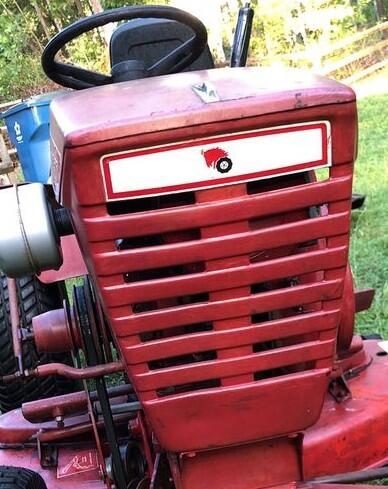

kpinnc 19,036 #11 Posted May 3, 2021 13 minutes ago, Lee1977 said: You can use a regular C-series hood, but you have to warp it a little to get it closed I have one of those, but would prefer a long hood like the pic below. I can make a little extention at the hinge. 4 Share this post Link to post Share on other sites

19richie66 17,937 #13 Posted May 3, 2021 6 hours ago, kpinnc said: I have one of those, but would prefer a long hood like the pic below. I can make a little extention at the hinge. Pm sent and I’m not too far from you. 👍 2 Share this post Link to post Share on other sites
