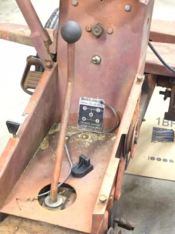

ACman 7,761 #4 Posted May 2, 2021 (edited) The one on the right has a 61/62 style front axle but has the adjustable stop for the lift lever 63 or newer . 62-64 slotted hood and looks like it has a battery tray so either 552 or 702 best guess . The serial #’s are under the dash on the shifter label. The one on the right has a 63/64 front axle and the61-63 steering wheel . So must likely a 753 . Edited May 3, 2021 by ACman 2 Share this post Link to post Share on other sites
