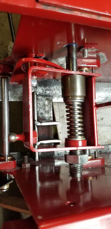

The Tuul Crib 7,354 #2 Posted May 2, 2021 Eric there's actually a way to tighten that up underneath the plate below the seat granted the spring isn't broke. I got mine dialed in pretty close 2 Share this post Link to post Share on other sites
ebinmaine 80,288 #3 Posted May 2, 2021 1 minute ago, The Tuul Crib said: Eric there's actually a way to tighten that up underneath the plate below the seat granted the spring isn't broke. I got mine dialed in pretty close Any general direction instructions? I left that cover plate off. 1 Share this post Link to post Share on other sites

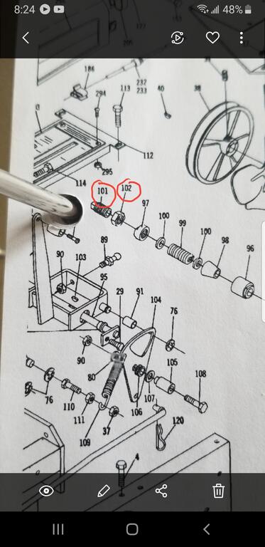

gt14rider 1,278 #4 Posted May 2, 2021 Loosen nut #102, make adj with #100, think its 8 ft lb, to move handle, no lube on assembly, works on friction. 2 1 Share this post Link to post Share on other sites

ebinmaine 80,288 #6 Posted May 2, 2021 20 minutes ago, gt14rider said: Loosen nut #102, make adj with #100, think its 8 ft lb, to move handle, no lube on assembly, works on friction Excellent. Thank you! 2 Share this post Link to post Share on other sites
pfrederi 21,049 #7 Posted May 2, 2021 You need a 5/8" open end for the threaded shaft and a thin 3/4" wrench to work the nut. I use my home made blade nut wench 2 1 Share this post Link to post Share on other sites

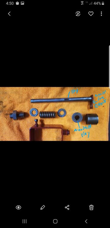

gt14rider 1,278 #11 Posted May 2, 2021 Disassemble and clean all parts, take care to clean/polish #96, #98 smooth. Shaft has a woodruff key under #98 check or replace, and end of shaft #95, tab can crack allowing to spin. Could cause some adj problems, reassembled dry,no lube 1 Share this post Link to post Share on other sites

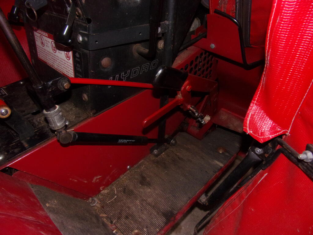

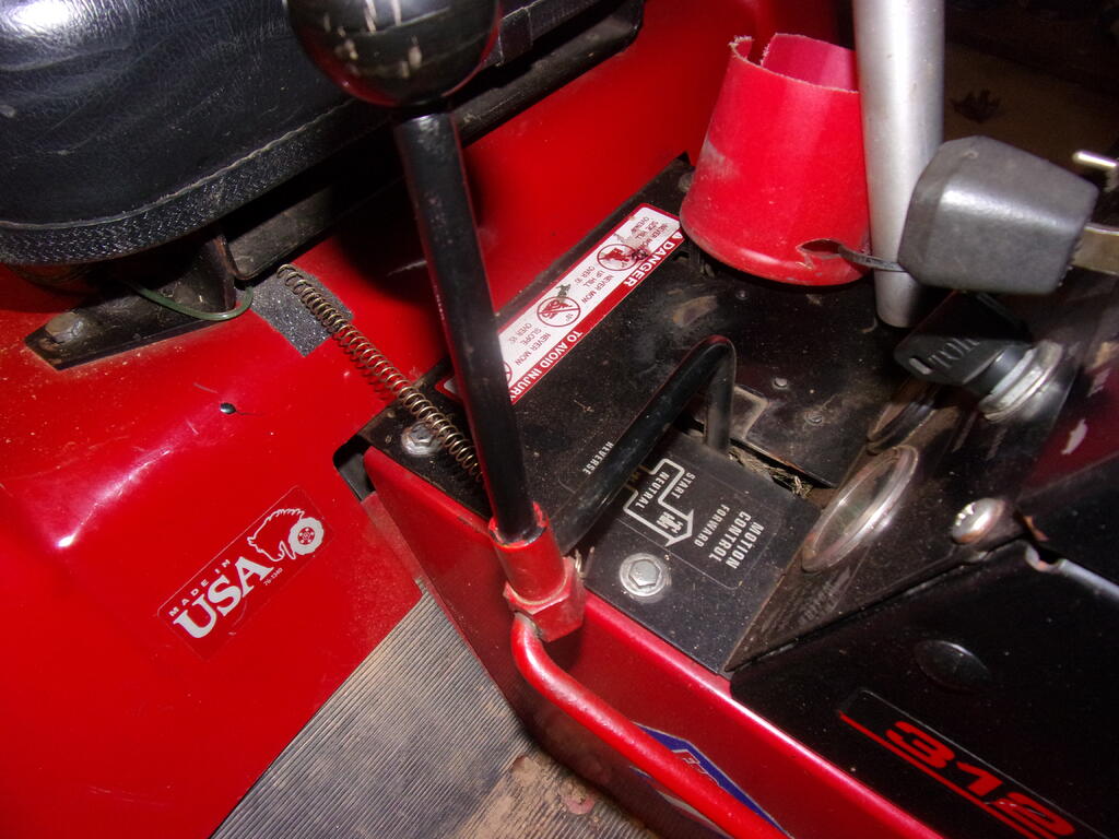

Ed Kennell 46,985 #19 Posted May 2, 2021 32 minutes ago, ebinmaine said: Are there different types of foot controls? Something that can be self-made? I made all mine. Alter the motion lever slot to a straight slot and add a right foot pedal connected to the hand lever. Add a spring to default to reverse. 520H 312H The 417H and C-120H are similair. 2 Share this post Link to post Share on other sites
