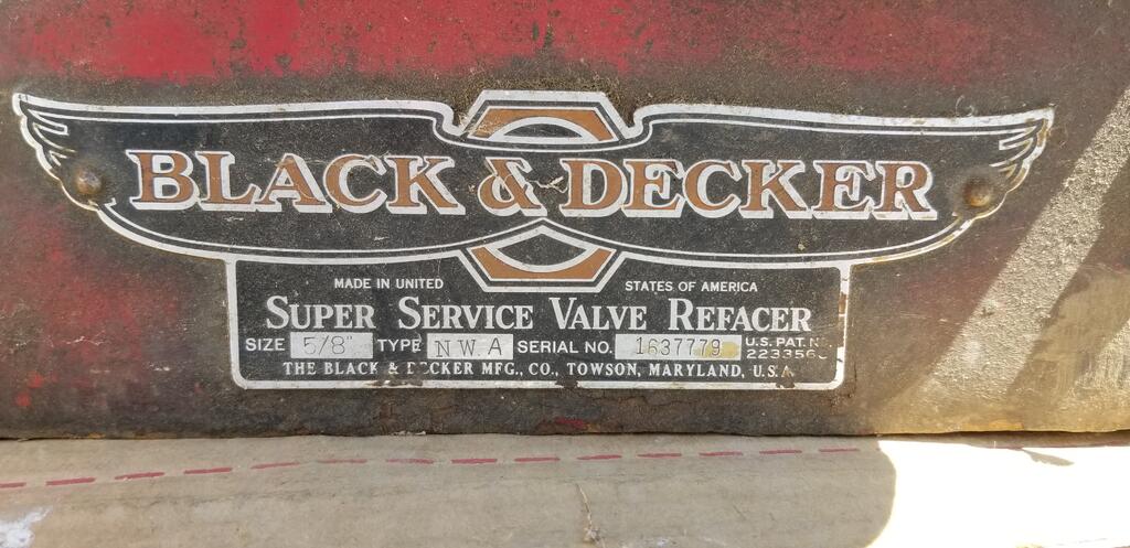

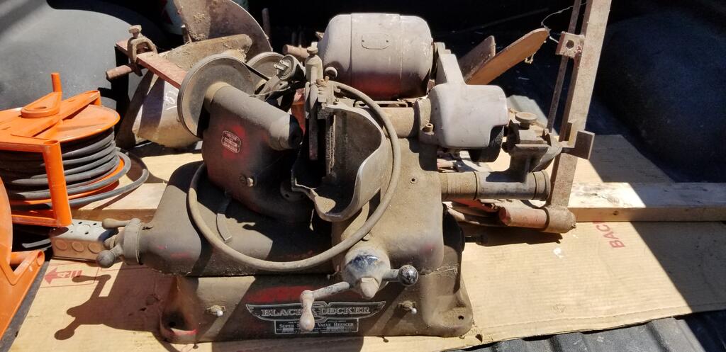

Mike'sHorseBarn 3,652 #1 Posted May 1, 2021 I've been looking for one of these for a while. Saw one at a sale and I got it for $20. Took it home and plugged it in and it actually worked! I'm going to take some old valves I have laying around and practice with it before I try to do anything that I want to actually be nice. 6 1 Share this post Link to post Share on other sites
pacer 3,180 #2 Posted May 1, 2021 Twenty bucks!! that would be hard to pass up, even if it is almost obsolete (it'll still do a Koehler) Did you get a box of stones with it? I've go 2-3 laying around here somewhere always thought I'd find some use for them, but............ I jury rigged a grinder set-up on my milling machine to do the valves, but can still only do the seats by hand, and since I've done 5-6 motors and they all run good..... The seats usually look good anyway and its the valve that'll get the ridge on it. 1 Share this post Link to post Share on other sites
WHX?? 57,650 #3 Posted May 1, 2021 Saaaaweeettt Mike ... give her a good home... Share this post Link to post Share on other sites
Mike'sHorseBarn 3,652 #4 Posted May 1, 2021 I have lots of Kohler 7 and 8's that don't have adjustable valves so I think this will come in handy. I don't know how much the refacer will get used, but then stem grinder will. At the very least, it's a neat old tool to have in the shop! 1 1 Share this post Link to post Share on other sites
