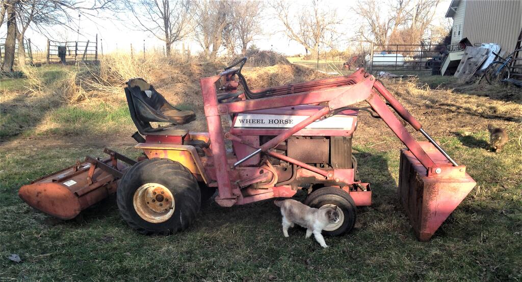

thomas koehler 6 #1 Posted May 1, 2021 Hi I have a D-250 that I recently bought. It starts and runs fine the hydraulics work fine as does the tiller but steering is very hard to work. I don't want to wreck it. any ideas on what might be wrong and anything I can do not the most mechanical guy around. 3 Share this post Link to post Share on other sites
Pollack Pete 2,273 #2 Posted May 1, 2021 (edited) I had two of those D-250's.Steering on neither was anything to write home about.Got rid of both before I had a chance to check them out.BTW.I like your's.Especially with the front end loader. I'm sure others will be along soon to answer your steering questions.Nice looking cat too. Edited May 1, 2021 by Pollack Pete 2 Share this post Link to post Share on other sites

peter lena 9,308 #5 Posted May 1, 2021 THOMAS , welcome to the site ! looking at you rig , the first thing i notice is lack of lubrication film at any movement point . think the easiest thing you can try , is to safely jack up the front end , add jack stands and see how the steering works without a load on it . you could also very thoroughly grease every related fitting and lubricate all rusty linkage while suspended , that would give you an idea as to what you have . does the steering have a lubrication source ? is it empty and very dirty ? just a basic check over to neglected areas might be your issue , it would be a start anyway, others will chime in with more advise . hope its just a lack of lubrication issue , before and after trials will verify what is going on , good luck , pete 2 Share this post Link to post Share on other sites
