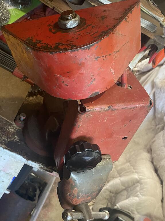

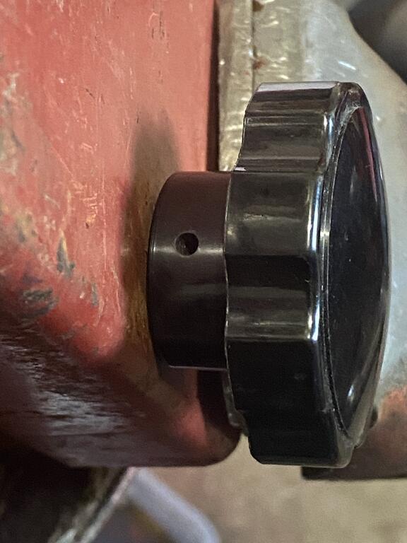

Lane Ranger 12,092 #1 Posted May 1, 2021 Ok who knows what size roll pin goes in a front mule drive adjustment knob?? I have replaced before but it’s been years! Share this post Link to post Share on other sites

gwest_ca-(File Mod) 12,453 #3 Posted May 1, 2021 Part #933156 Roll Pin 1/8" x 1" 2 1 Share this post Link to post Share on other sites
tunahead72 2,645 #4 Posted May 1, 2021 (edited) More specifically (), the parts manual for the 05-42MS04 mower says spirol pin #933156 is 1/8"x1". -------- Edit: Garry beat me to it by seconds, good thing we agree. Edited May 1, 2021 by tunahead72 1 Share this post Link to post Share on other sites

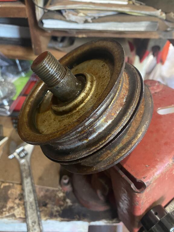

peter lena 10,015 #5 Posted May 1, 2021 lane , use a flat faced 1/8 " punch , penetrating oil , never seize refill , while you are there are you going to , pop those bearing grease seals and hi temp grease them ? done that on 3 of my mule drives , no hi pitched whine , solid quiet . pete 1 Share this post Link to post Share on other sites
Jeff-C175 7,211 #6 Posted May 1, 2021 1 hour ago, peter lena said: pop those bearing grease seals and hi temp grease them I took Peter's advice about a month ago and did mine. QUIET AND SMOOTH now! AND I checked with IR thermometer and they run quite a bit cooler too! 1 1 Share this post Link to post Share on other sites
peter lena 10,015 #7 Posted May 1, 2021 JEFF, been doing that to all my bearing failure / noisy areas. drive belt pulley bearing , deck bearings , pto mule , bearings pto needle bearings , I don't have the drive pulley # , but replaced it with a bearing distributor pulley , brought the old one in and found a match on the wall board , exact size with a 5/8 " bearing size ,bronze bushing , 5/8x 3/8 , made a perfect fit , then i removed the wide rubber bearing seals ,repack with hi temp grease , talk about smooth and solid. realize this upsets the purists , but I have no bearing noise or issues . will see if i can find that pulley # at bearing distributor , that makes a bombproof pulley swap ,pete 1 Share this post Link to post Share on other sites
Lane Ranger 12,092 #8 Posted May 1, 2021 5 hours ago, peter lena said: lane , use a flat faced 1/8 " punch , penetrating oil , never seize refill , while you are there are you going to , pop those bearing grease seals and hi temp grease them ? done that on 3 of my mule drives , no hi pitched whine , solid quiet . pete Pete I will try this ! What hi temp grease do you use? Thanks! Share this post Link to post Share on other sites
peter lena 10,015 #9 Posted May 1, 2021 lane, use the LUCAS RED AND TACKY OR THE , LUCAS X-TRA HEAVY DUTY GREASE , 560 DROP POINT , both available at walmart , its easy to do and it works , pete Share this post Link to post Share on other sites
clueless 3,436 #10 Posted May 2, 2021 If you work on these tractors much you know you have to deal with roll pins. Some are easy to remove some not so much i.e. steering wheel. I've found the best way to deal with the tough one is to buy a quality set of roll pin punches, use good penetrating oil and a hammer drill not an impact drill. A cheap Harbor Freight veritable speed, $25.00 one works fine. Soak the pin with the pen oil and give it time to start doing it's thing this may take a few minutes or hours or days. Chuck up the proper size roll pin punch and hit the pin with it a few times, come back later do it again. Like I said this may take a few minutes or several days, had one that took over a week before it came out. The few seconds of hitting the pin with the drill over a period time along with the pen oil will break the pin loose far better than a BFH The hammering of the drill eliminates most of the bouncing that happen when you wack it with a hammer, most of the force is going directly to the pin. That my story and I'm sticking to it. 1 Share this post Link to post Share on other sites
