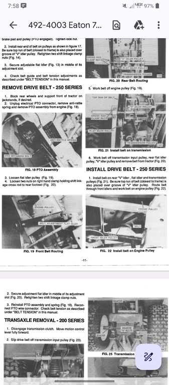

cJ_3D 9 #5 Posted June 23, 2024 (edited) On 4/30/2021 at 11:43 PM, Crazyredhorse said: Dont know how you guys feel about links but this helped me it's a real pain to change and may help someone.one thing I can add use a long wrench on pulley nut on tensioner arm to relive remove or put on belt. https://outdoorpowerinfo.com/repairs/wheel_horse_hydro_252-h_drive_belt.asp Hey @Crazyredhorse! I'm havin a heck of a time trying to figure out how to get tension off this belt to get it on or off. Where do you stick a wrench exactly or where do you pry to get the tensioner to move so you can get the belt on? It's been driving me nuts! Thanks! Edit: Hold the phone I may have found it! Looks like I was mistaken about which pulley was the tension. Found this exert from the transmission manual. Does this look correct? Maybe it will help someone else as well Edited June 24, 2024 by cJ_3D Update Share this post Link to post Share on other sites
